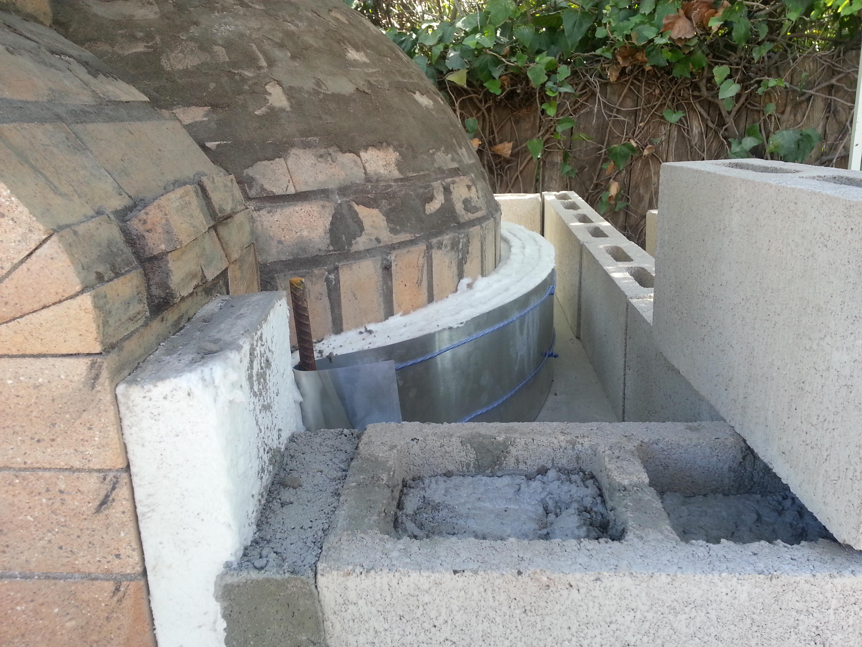

                    Waiting for Stainless steel tapcon screws and kaowool sealant to attach the chimney. Not one to be idle log, I am preparing to reinfoce my tall soldiers in the style of Brianventura
                    Originally posted by brianventura
                    To support the soldier course I poured concrete around them. It's just a little piece of mind since I have a tall soldier course and I have read that they do need to be reinforced so they don't get forced outward.
                    He is my attempt so far:Click image for larger version

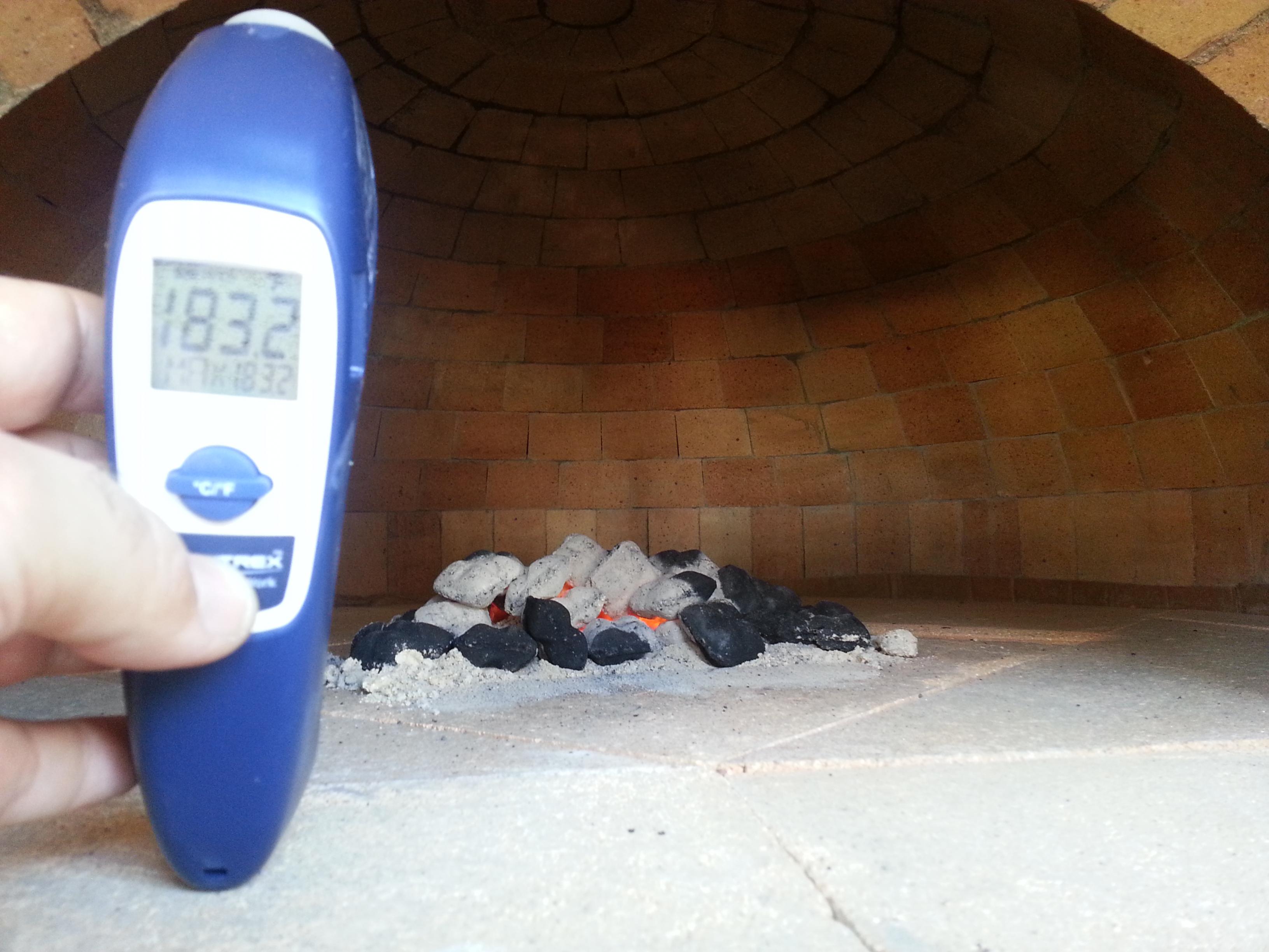

                    I also started curing - I started with some left over chafing fuel - the laser thermometer found their max temp around 350 degrees F - which suited me fine - bringing the oven up from ambient (which happens to be about 100 f today) very slowly. I transitioned to charcoal and by the end of the evening I had the inside of the top of the dome to about 250 F, the outside of the dome has not exceeded about 125 F

                      An interesting development.
                      While curing the oven (with charcoal so far) at low temperature there is an occasional puff of smoke that exits the dome between two bricks, two course down from the plug. As the oven heats up (and the bricks expand, or as less smoke is produced) the smoke decreases. I believe this defect is due to faulty mortar application - not a crack that occurred due to heat stress.
                      So when does a crack in the dome matter? Is this a call for some kind of patch ( I would probably have to make the gap bigger in order to get anything in that space) or is this the case where insulation covers a multitude of sins?
