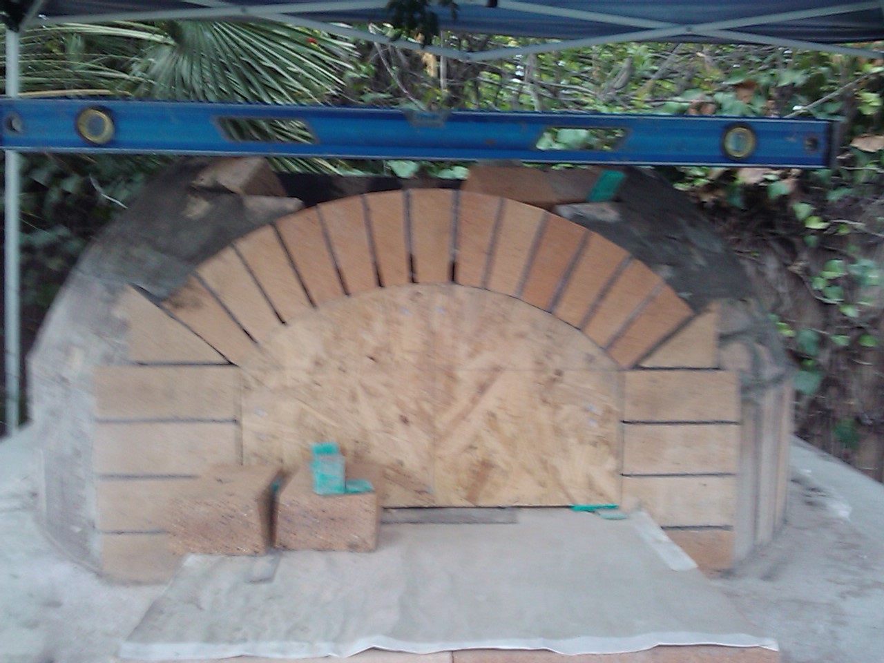

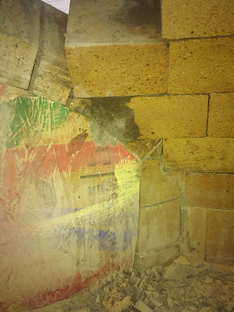

    I am making progress. The dome is round and level. The vertical joints are great where I paid attention, and gap at the bottom (inverted v) where I rushed. I built my arch first with a set angle on the back of each brick. Where the courses intersect the arch I am using the hand held grinder to shape the back of the arch to give the brick a place to purchase. I have not continued each brick from the course all the way to its lateral end - so there are some steps at the terminus of each course.
    So here is the question: If I "fill the gaps" so to speak with the FB mortar will it hold? (up to 3/4 inch thick in some places) or would I be better off grinding the protruding ends of the brick down to the level of the arch?

    Inside view - the inside of the arch form is painted (recycled)Click image for larger version

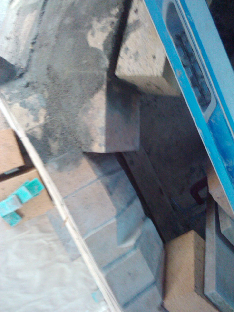

              I finished this course and placed one in the next (last) before the capstone. In the day light I intend to finish the last course and plan the cap stone. Click image for larger version
Name:	Second to last course.jpg
              I will see If I can shape the opening for the cap stone to round using this: I will let you kn ow how is goes.
Name:	2012-07-21 01.47.15.jpg
              Once the dome is complete I am planning a Dino Pizza style chimney arch set off the dome 1/4 inch for a heat break. Moving on!

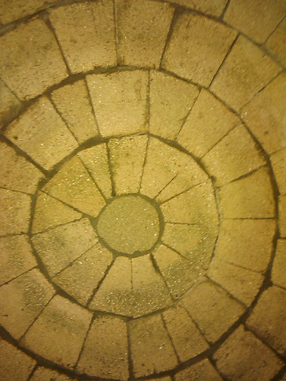

              • #67
                Re: 42" FB Pompeii Oven with 19" dome, and adjacent fireplace, in the O.C.

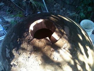

                FINALLY got the last course in place. This was a "place two, knock one out, replace - wedge with sticks, Return to clean - knock one off, replace" kind of day.
                Every "brick" is a unique creation.
                The remaining hole is too small a diameter for my abrasive pad for the drill. I am letting is cure over night before moving to the plug.
                I removed the IT and floor covering tonight. Contemplating how to get in there for clean up / touch up. There might be too much of ME to fit. I may enlist the oldest son for this duty.

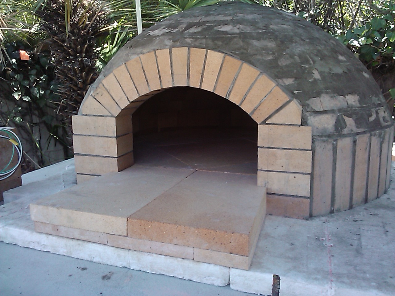

                    The Dome is Closed! With the help of my two sons I got the dome closed Today

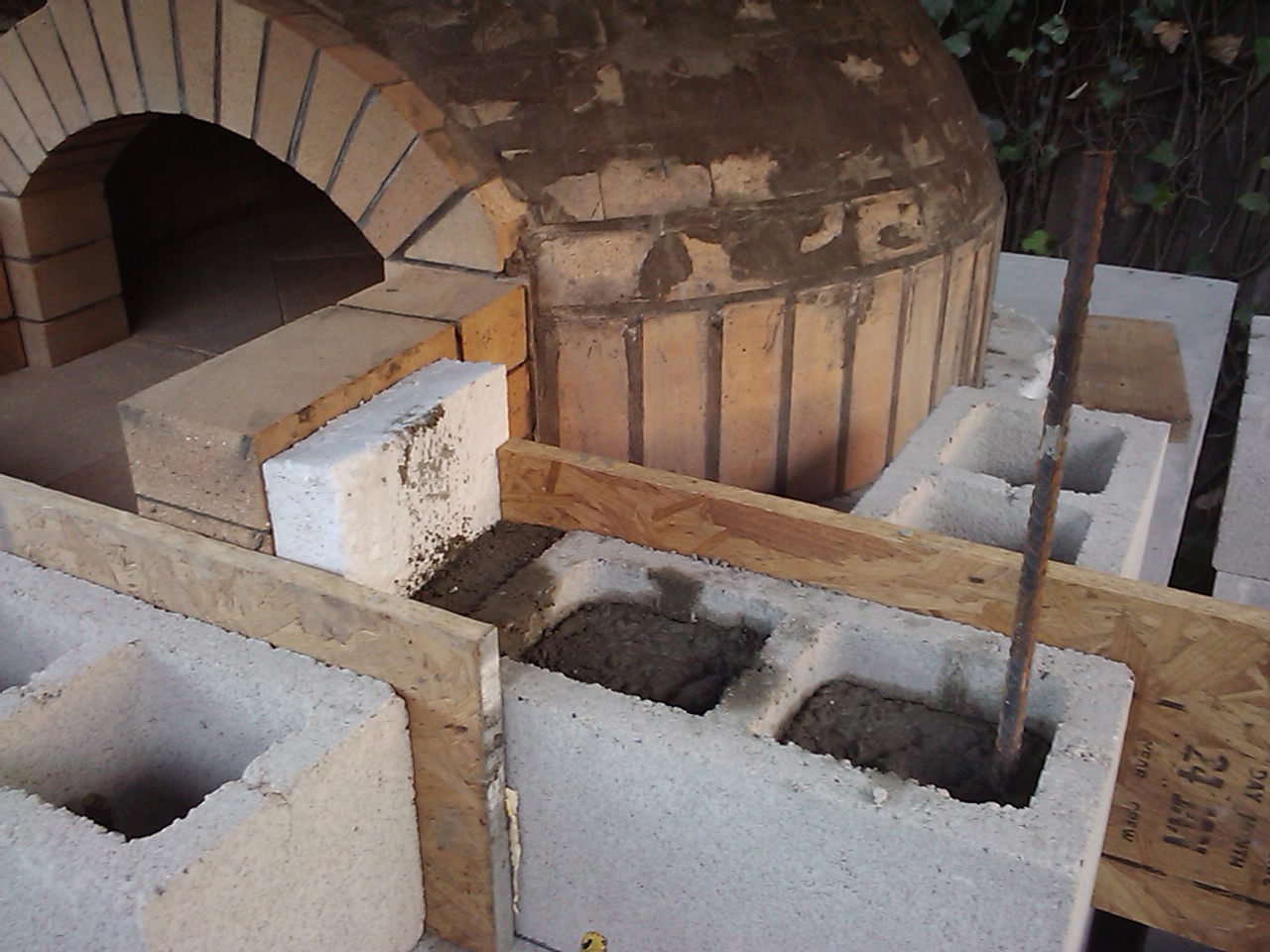

                              Started on the chimney arch over the landing. I am including a heat break gap between the arch and dome. The outer chimney arch is wider (tapered entry) and taller (by one inch), then the inner chimney arch. I plan to build my "surround" with concrete block. Placing block next to entry arch sides, with insulation and pouring concrete to fill the gap.Click image for larger version
