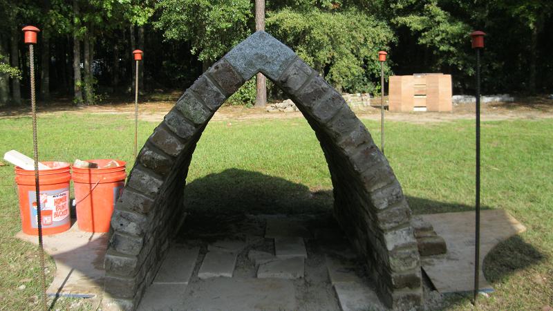

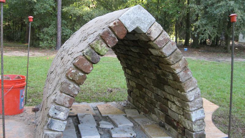

    I started the base last year in late September. The first step was to build a brick Gothic vault, which will carry the weight of the masonry above, while providing a large open space for storage or just a view. The bricks came from a fireplace I remodeled, and they are antique, handmade ones from an old building in Charleston,SC. I dug out what little sod and topsoil there was and put a 6" base made of granite dust, 1/4"-fines, compacted in 2" lifts. There is no frost movement here, and its all clean sand for subsoil...super drainage here.
    Here are some shots of the vault after it was built...I deleted all my pics off the gallery so as not to be too redundant.

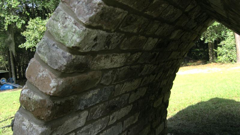

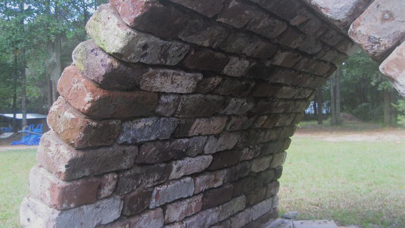

    After cleaning the brick, I went back and pointed it up.

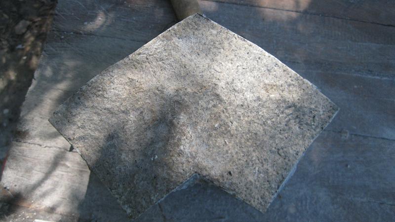

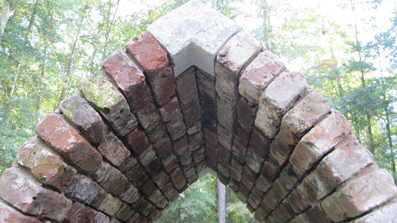

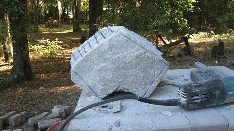

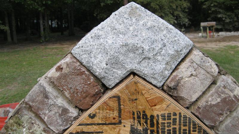

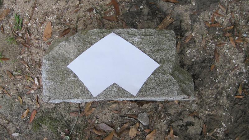

      The keystones are carved from reclaimed granite from a project I had done in New England the year before. They will be darkened up later to blend in with the brick better, and more carved elements are planned on the finishes too.

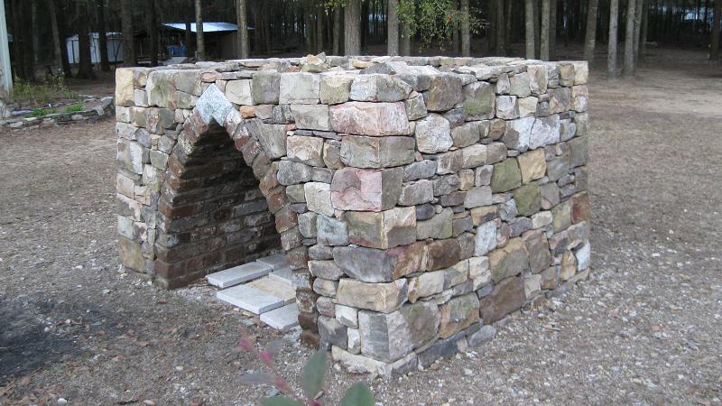

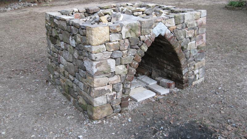

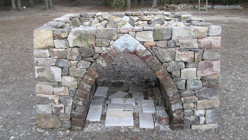

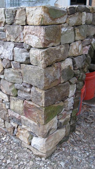

        To complete the footprint of the oven base, each side of the vault will be covered in dry stonework. That step took me awhile, because I built it up and tore it down twice, one of the times I was halfway up on each side.
        Finally got that part over with....
Name:	Front close 1.JPG
Name:	front left angle 1.JPG
Name:	front right angle close.JPG
        Corner close up...
Name:	Back right corner 1.JPG

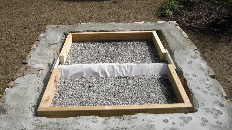

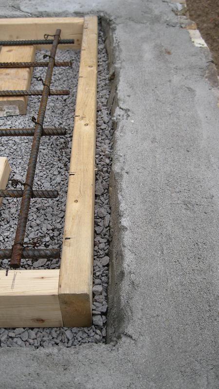

                    Finished the bond beam and the form work for the slab yesterday. I plan on pouring it tomorrow or Monday.

                        I am cornfused. Are you pouring a concrete slab there or a perlcrete slab?
                          Re: My Wood fired Redux
                          Concrete I hope. Heavy rebar in a vermicrete slab won't do much.
                          • stonecutter
                            • Jun 2007
                            • 2003
                            #14
                            It's for a concrete slab...I've got some stonework planned and need the support. Vermiculite will go on top of the slab in the oven footprint per usual application.
