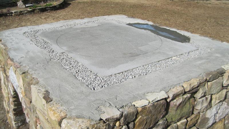

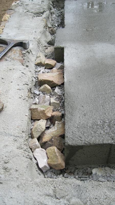

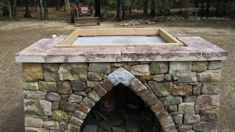

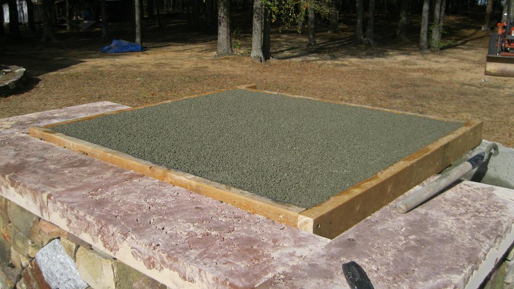

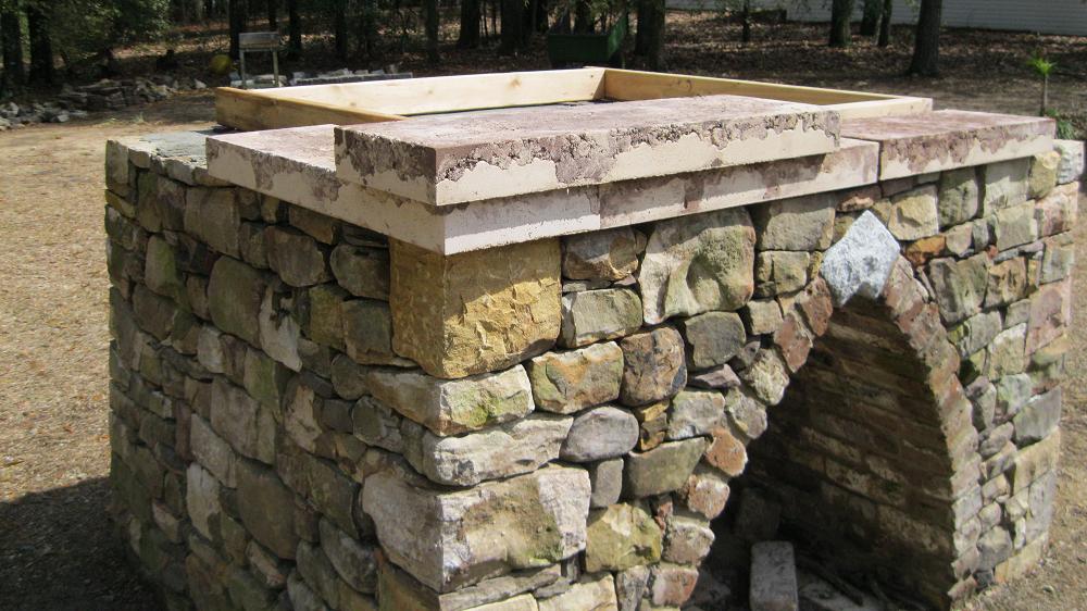

          Slab done on Sunday. Going to have a couple things going at once...casting pieces for capping the base, insulating slab, cutting brick and carving some stone.
          Some shots of the slab. Drain channel is filled with broken stone and crushed stone to level it out.

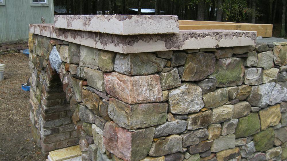

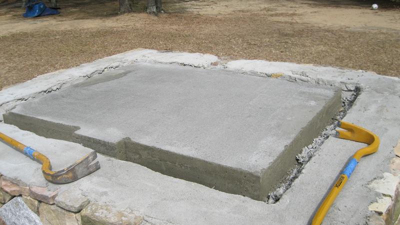

                        Here is what I am doing with the cast concrete. These are experimental and won't be used, but they give an idea of what the two layers will look like. They are three color hand press on the top layer, without the slurry fill. I am just going to cast the ones to be installed with a flowable mix, and maybe tint it with a bit of charcoal and earthtone. Insulation slab was done yesterday, with a capillary break between the structural slab and the insulation.

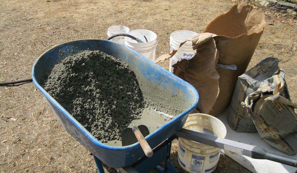

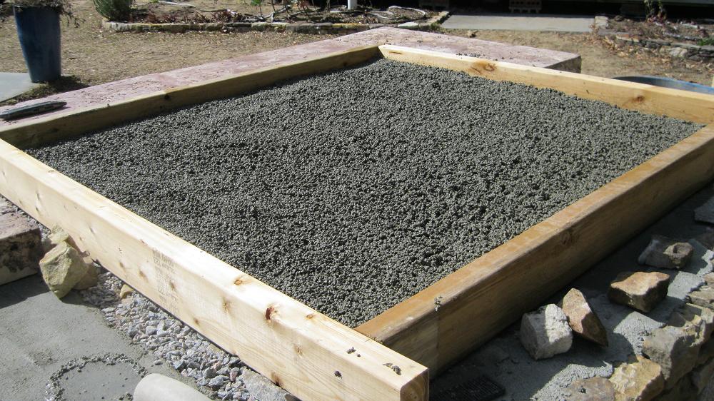

                            Some pics of the Perlcrete slab. This is the first oven I have used perlite. I like mixing and finishing it better than vermiculite.

                              What ratio did you use, I just purchased some perlite to put over my ceramic fiber on my dome. What worked, what didn't.
                              • stonecutter
                                • Jun 2007
                                • 2003
                                #30
                                Re: My Wood fired Redux
                                I did a 6:1 with 1.6 on the water. Take this for what it's worth..... When I portioned out the perlite, I used 1 gallon as my unit of measure. After filling the first portion of perlite, it was dumped into the wheelbarrow. Then I took the measured Portland cement and put about a third of it over the perlite. Repeat for the next two buckets of perlite. Then I was able to gently fold and mix the dry material without breaking up the pieces into fine particles.
