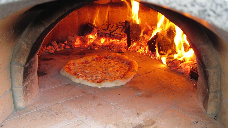

        Party tomorrow, but I feel so rusty I had to fire it up and make a couple. My boy had a friend over and I wanted to keep it simple so it was just cheese for them, and Margheritas for us.

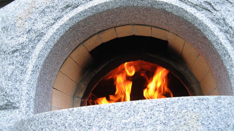

          Overall, I'm very happy with how the oven is working. The draw is excellent in spite of facing the prevailing wind....had no choice on that.
Name:	IMG_1595 arch view.jpg
          The gable on the back of the oven is open on top, I checked the interior temp when we were coming inside for the night....nothing more than ambient.
          Granite arch didn't get very hot at all, and I think we're in business!

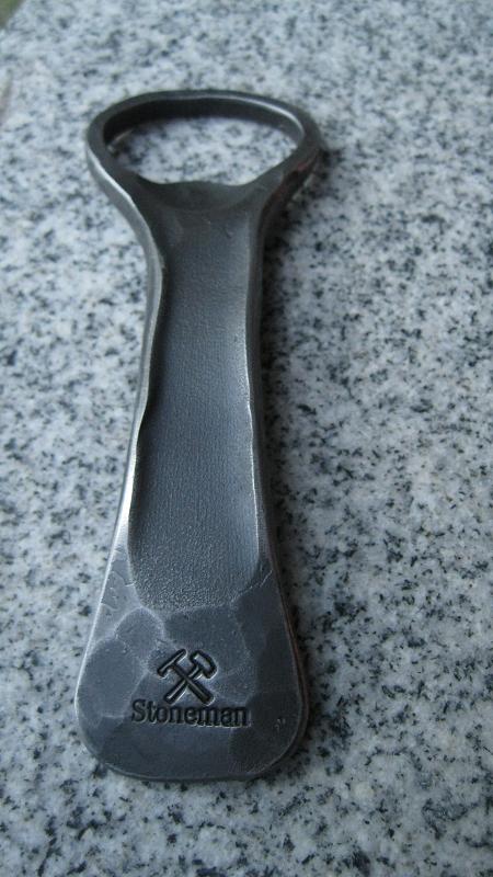

          Check out this essential oven tool. Custom made by a blacksmith in MA for a small local brewery. The owner/brew-master is also a stonemason..this is the name of his business. It's no surprise I wanted one.
