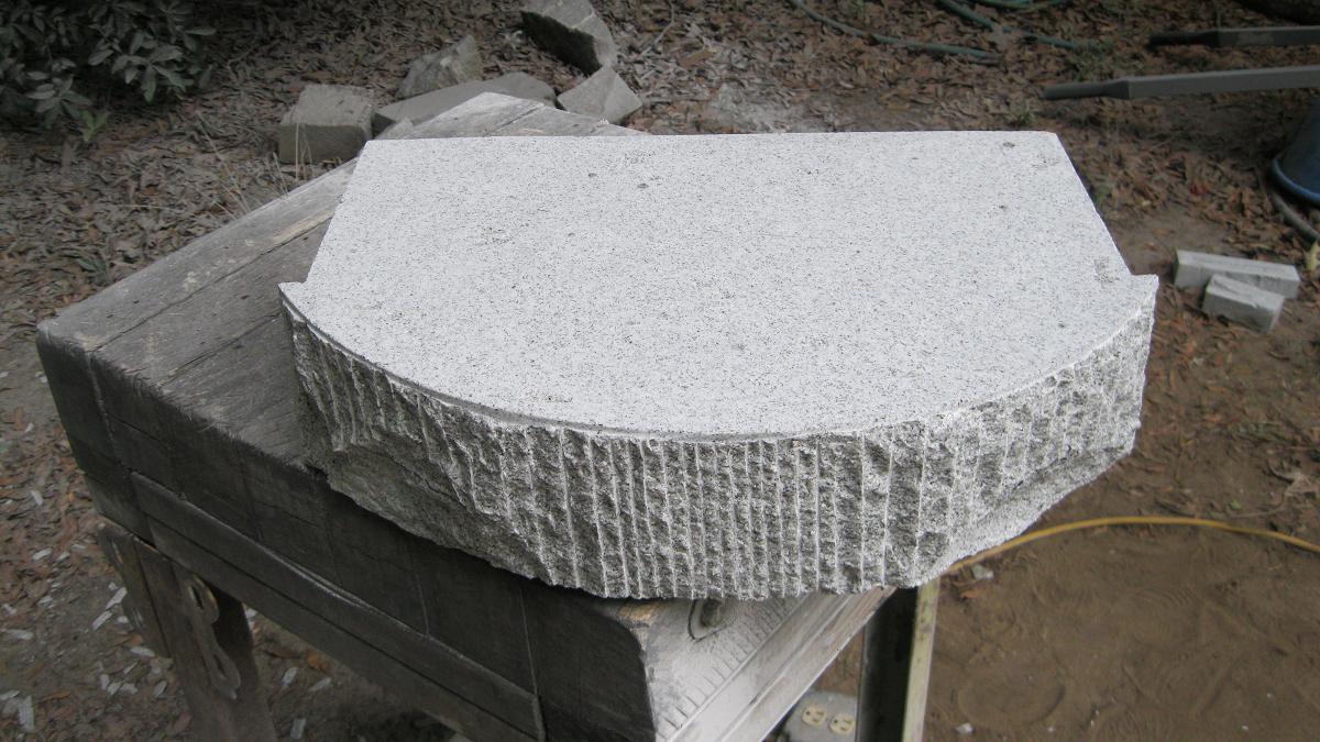

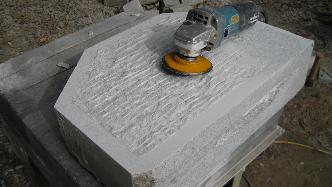

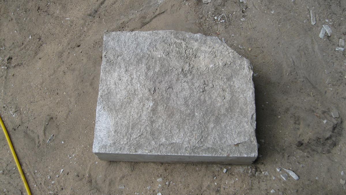

    Then it was on to the hearth. Here is the last large scrap of granite I have to work with. It was barely big enough to use.
    Leveling the top.
    Remove the large waste parts.
    Grind off the chisel marks.

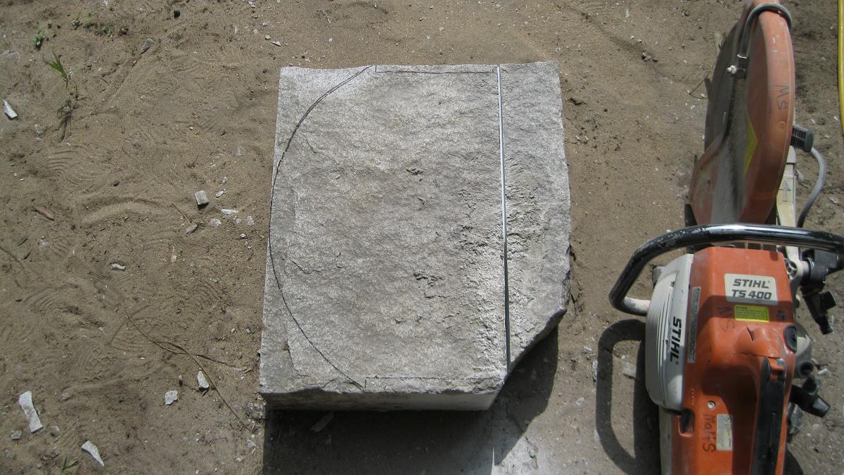

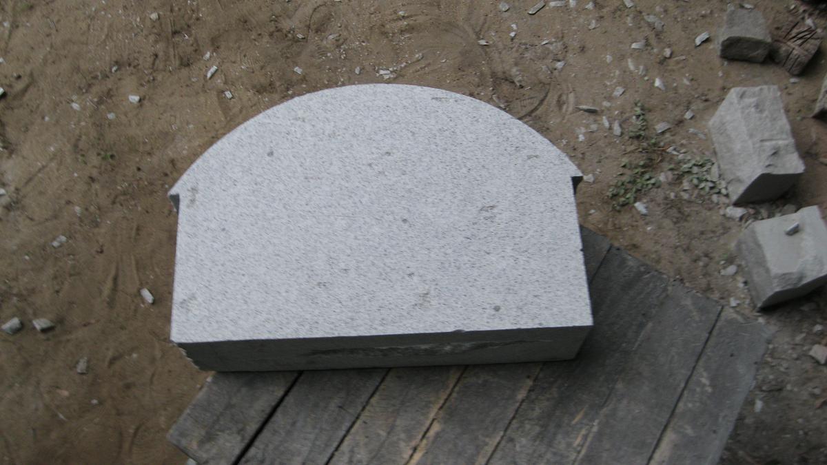

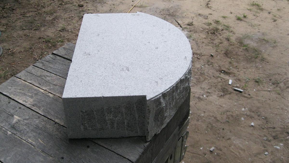

      Then I made a template of the hearth and started cutting it out.
      Here's were I ended the day.
      I'll need 4-6 hours to finish carving and honing. Then on to more framing.

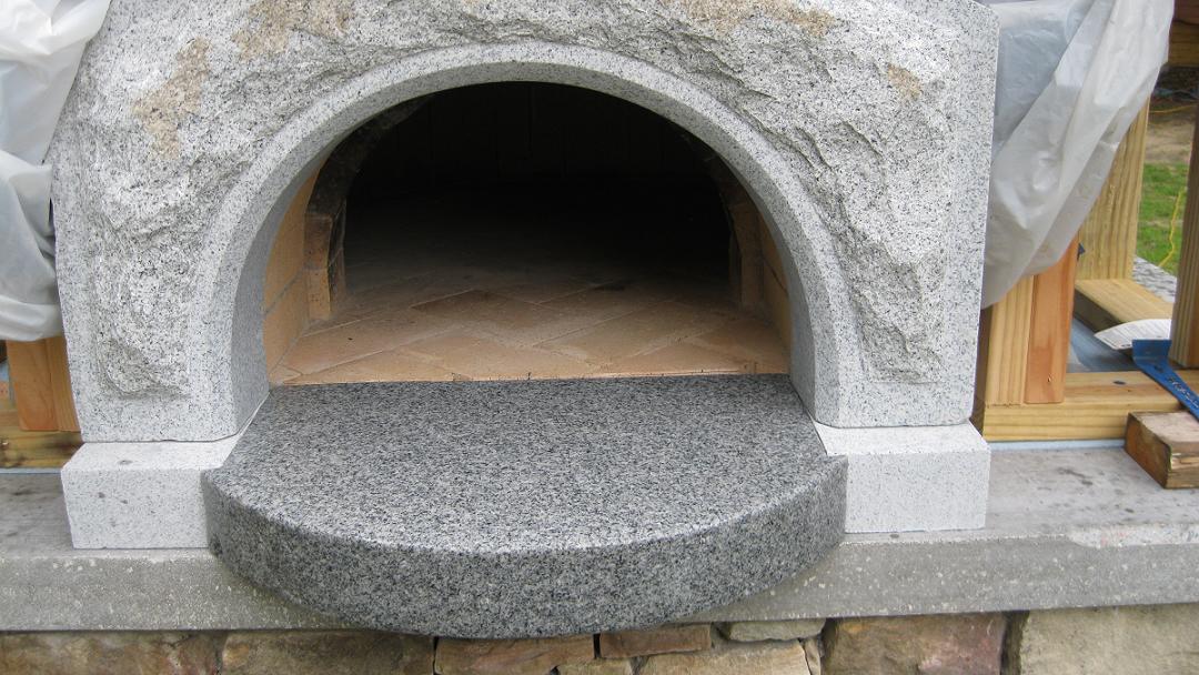

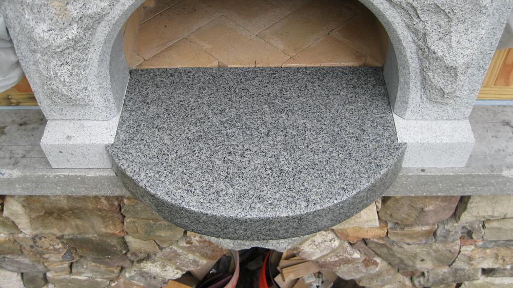

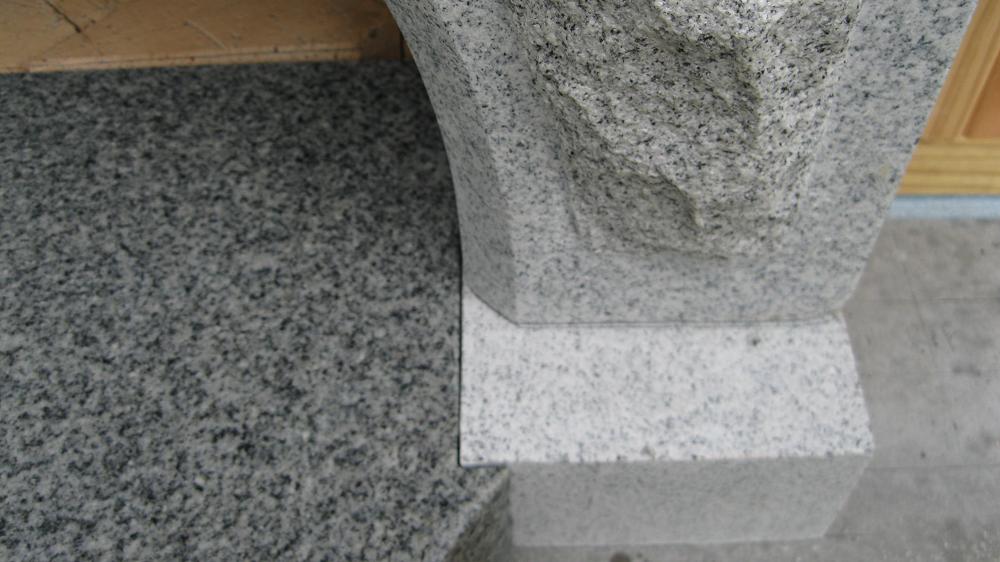

                  So T-storms shut me down early, but I finished the hearth and dry fitted it. All I have to do now is to relieve the edges of the pedestal blocks and hone them.
                  It's dark in the picture because I just finished wet sanding it.

                      Today I took the arch and hearth assembly down to complete the bevel edge on the watertable. I was able to polish the pedestal blocks, and cut two small brick pieces for my landing floor. I was planning an inlay, but decided just to put the pieces in.
                      Then it was all re-assembled using Lexel instead of mortar, because I don't want a joint, and dry setting isn't an option.

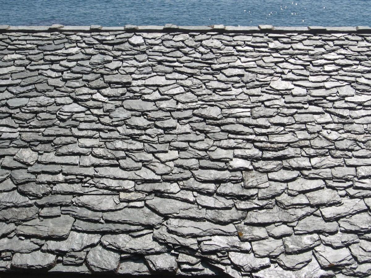

                                I am doing cedar shakes for the roof, after much back and forth. The original plan was thin flagging for the roof to look similar to this. This will have to wait for the next one....likely at my parents home.

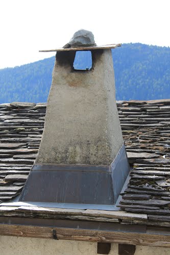

                                But I think the shakes will look good and break up the stone look. Along the same line of thought, I am going to stucco finish my chimney, because it will be faster and lighter weight. I'm thinking it will finish like this, without the taper...
