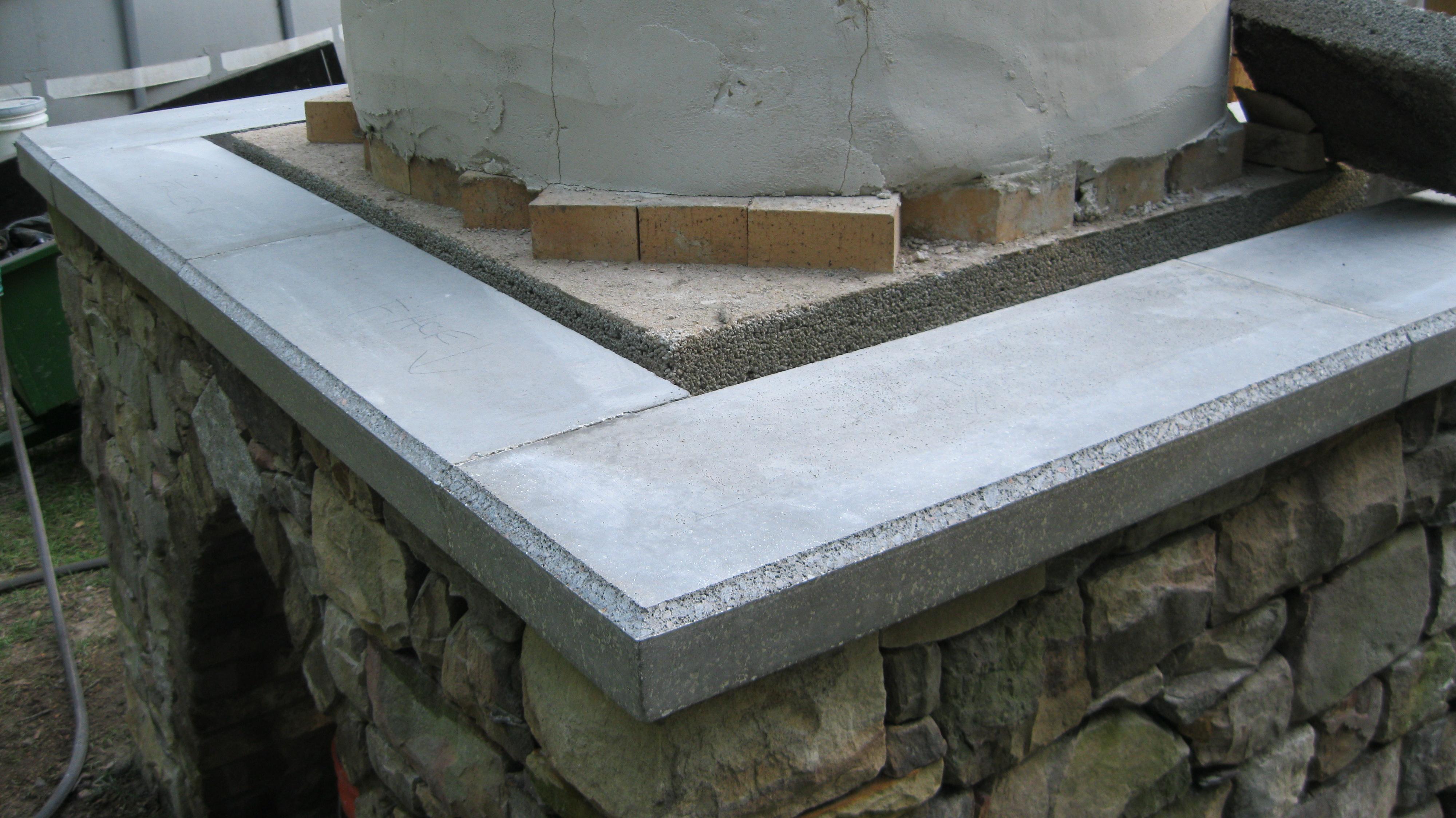

    Re: My Wood fired Redux

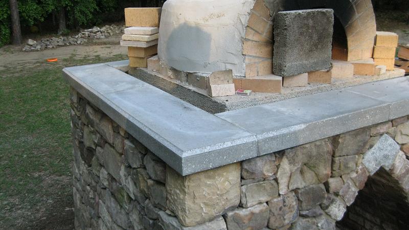

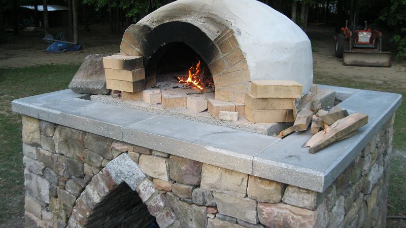

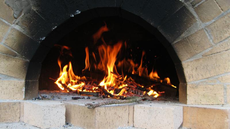

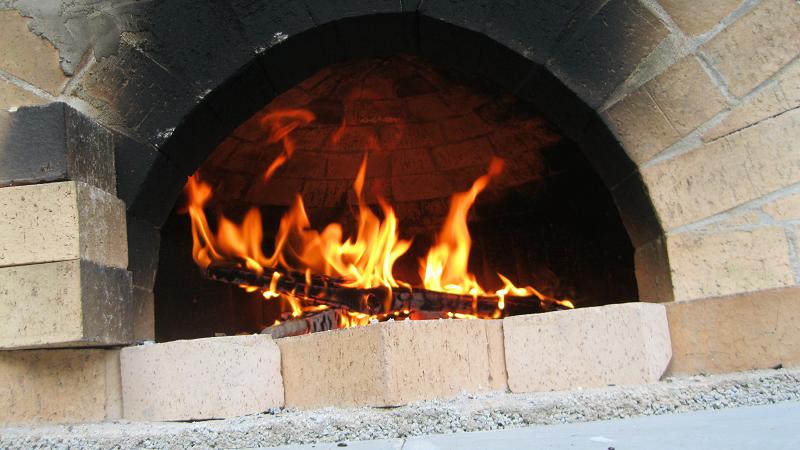

    Grabbed a couple hours the last couple days for curing fires and some work on the watertable. Yesterday I wet sanded the second slurry coat and then set them on the base....no pics...oops. I applied some Lexel in between the pieces to act as a kind of gasket because I didn't want a joint.
    At the same time, I had another fire going...I'm guessing it was in the 500*-600* range.
    Today I profiled the watertable and burned a good fire...guessing it was in the 700*-800* range. The bricks were clearing when I stopped adding fuel, it was getting dark and we may get rain later tonight so I need it to cool so I can tarp the dome later tonight.
    Next I am going to slurry the profile the wet sand it...then some sealer.
    Pics....

      Plenty of cracks on the cladding...none inside the dome that I can tell. Not bothered about the cladding, it's letting steam and moisture out. Today's fire was the hottest yet, and I barely saw any wetness around the cracks...it's getting close. All the fires have been kept burning a minimum of 5 hours.

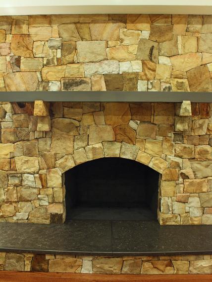

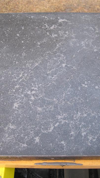

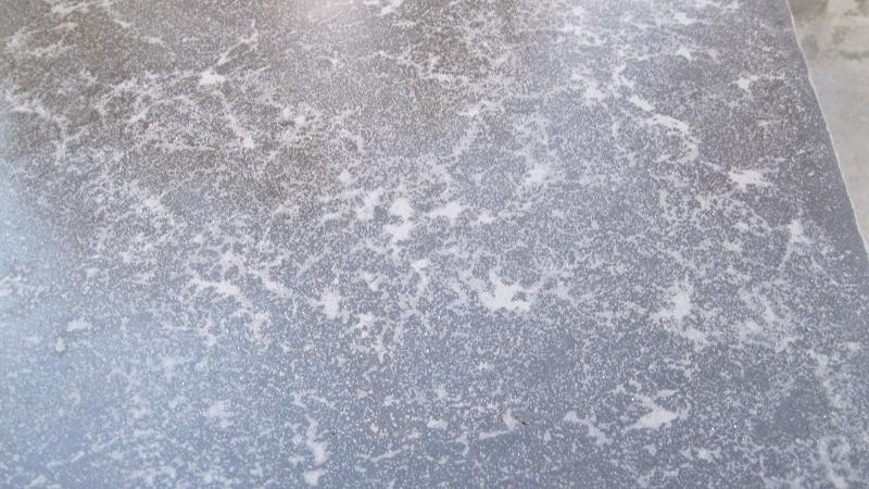

                      #100

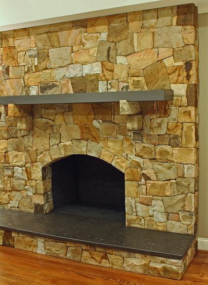

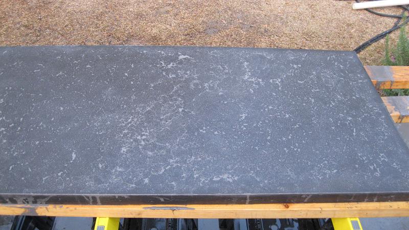

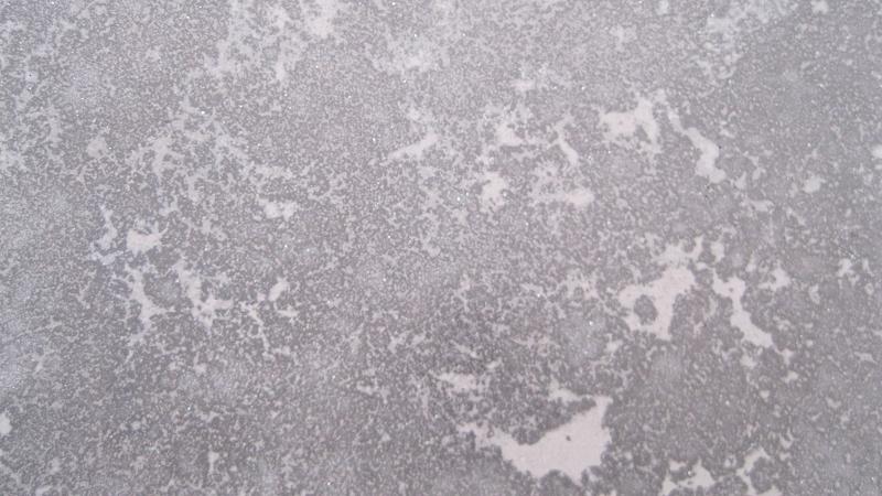

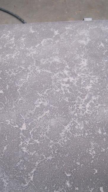

                      This is hand pressed concrete slabs used for a fireplace hearth. The main color is charcoal, with pewter veining. If anyone is wondering, the stone on the FP is 4"-6" veneer, and is three-side snapped Tennessee Fieldstone.
                      The slab..

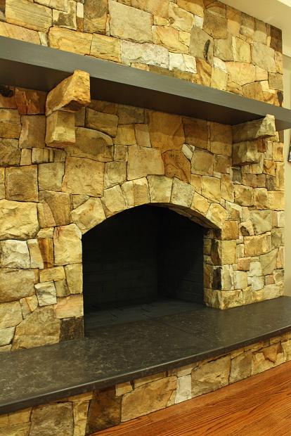

                        #101
                        Installed...
                        The mix is a highly engineered sand only blend, with a little fiber too. There was also a polymer added, and this concrete is very hard when fully cured...over 6000 psi. I treat it like stone, meaning I profile the edges by hand rather than form them in the mould...because it creates sharper detailing. It also polishes up very nicely, I took this hearth all the way to 3000 grit, then buff, seal and wax. Anyway, this technique has broad applications, and can be used for sinks ( hey Gulf! ) and architectural pieces.

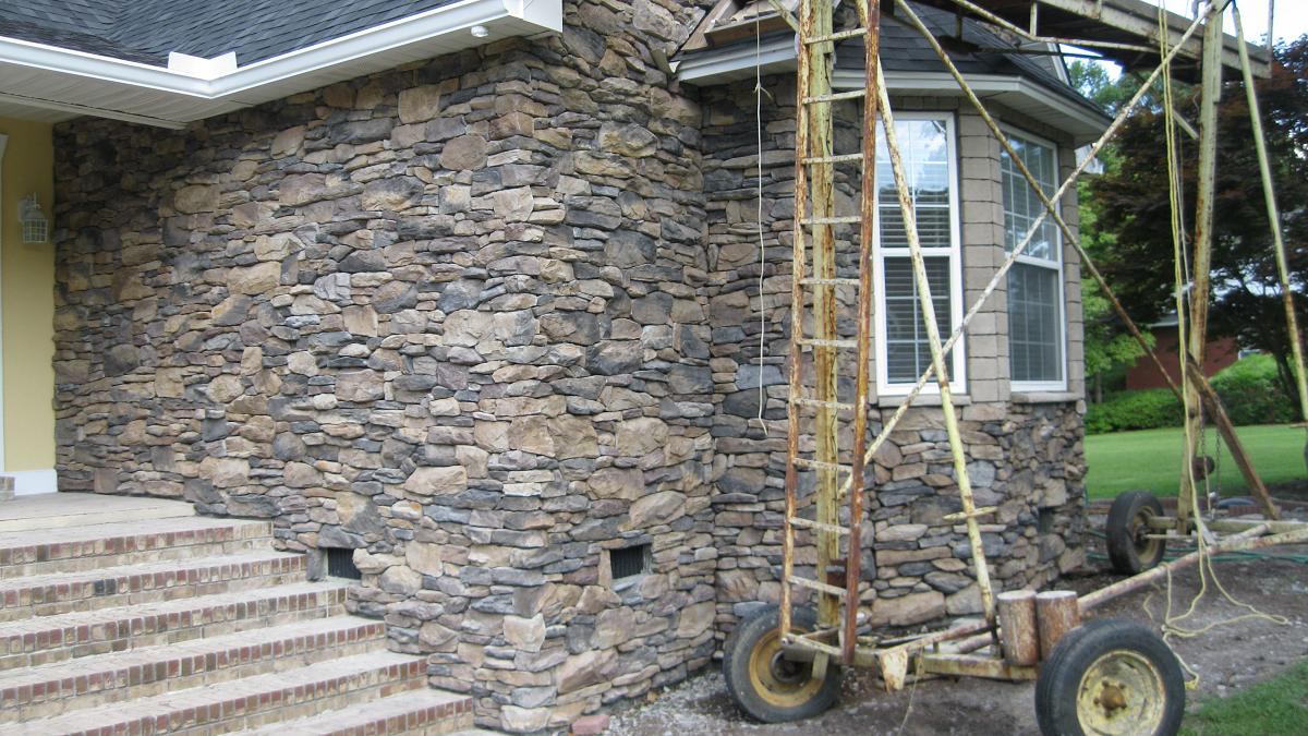

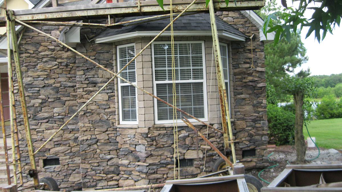

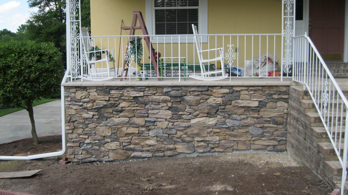

                                #105

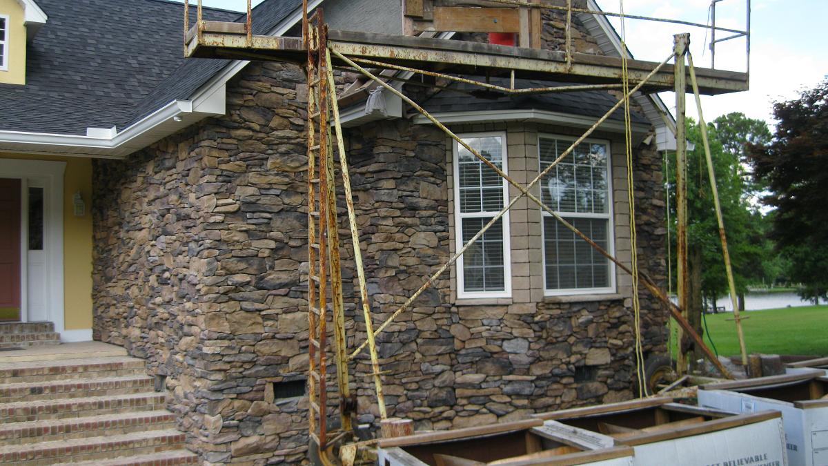

                                Specifically for Utah Beehiver, this is the fake stone project I mentioned in your thread. Type N mortar mixed 2:1 over a portland based scratch coat and lath.
                                Even though I would never favor adhered veneer over natural stone, I must say it came out better than expected. I don't love the window trim, but those are 22.5* corners (which are mitered) and there was only around 6.5" between the window and the corner, so field pattern wouldn't work like it did below the trim...I wove the 'stone' to avoid a continuous joint.
                                HO & GC are happy, and I am keeping the wolves away....win - win.
