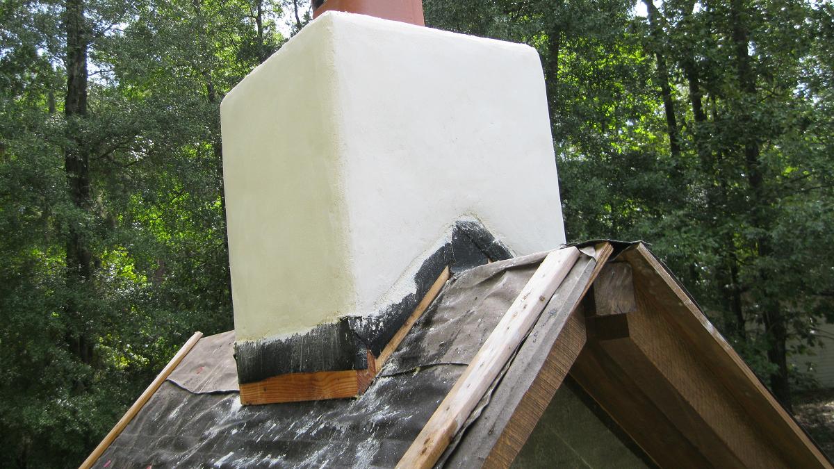

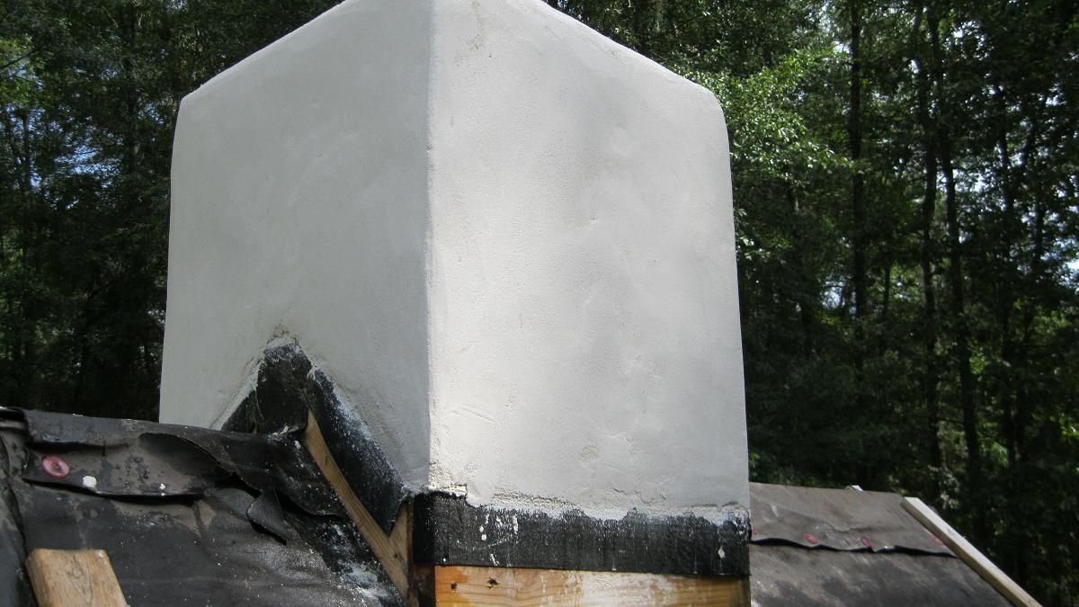

      I took advantage of a schedule change and finished my stucco work on the chimney. The final finish will be something of an earth-tone paint..I have a bunch of different ones that have potential.

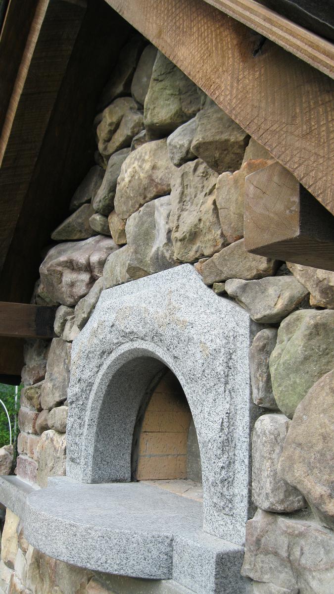

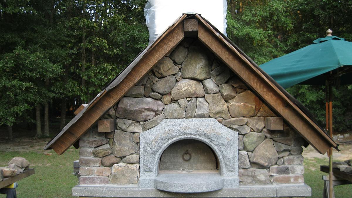

        I also put a few hours into the stonework. I forgot how junky most of this stone was...most of it has been picked over from two projects. The trick is not to fuss too much, and don't force a style that won't work...I think I'm on the right track, but who knows, I may wake up tomorrow and tear it down...or not.
        I do like the rough texture so far.
        My goal is to let the work look like it was done for functionality, not aesthetic. The Masons that built communal ovens could care less for the most part, it was more about getting it done. The beauty just kind of happened on it's own...that is the challenge for me, not to try and squeeze every stone tight on all sides.

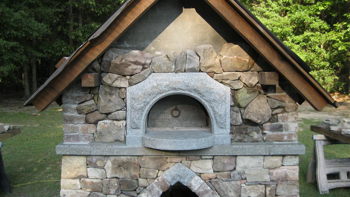

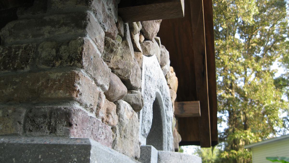

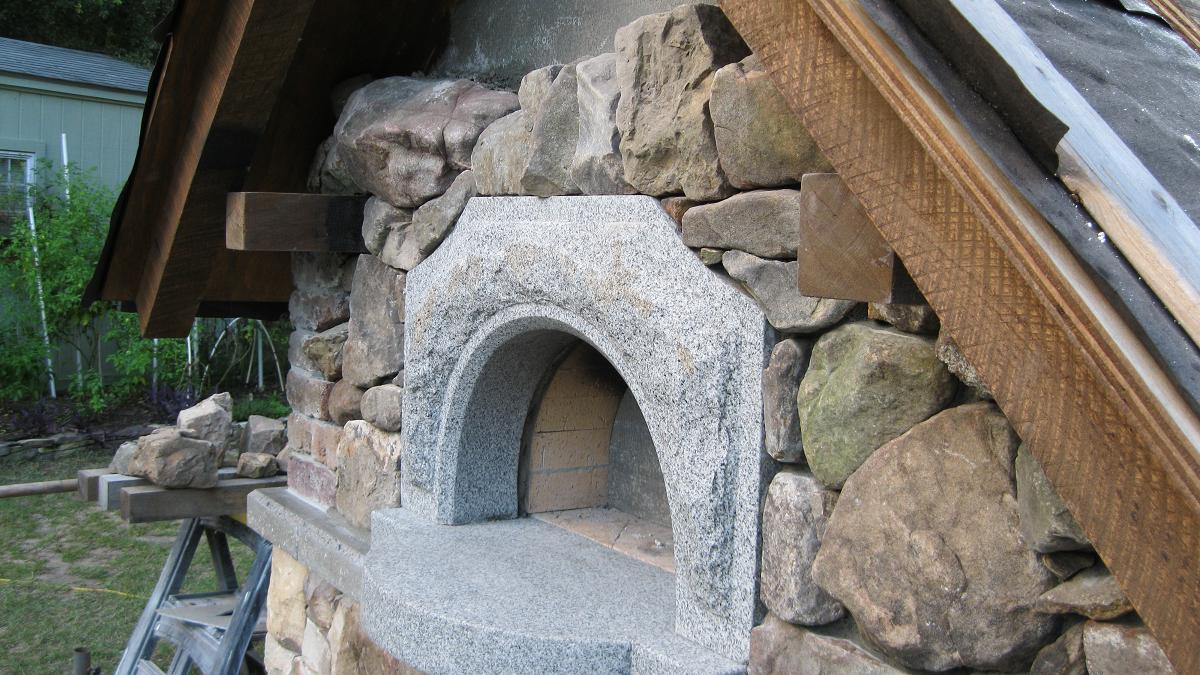

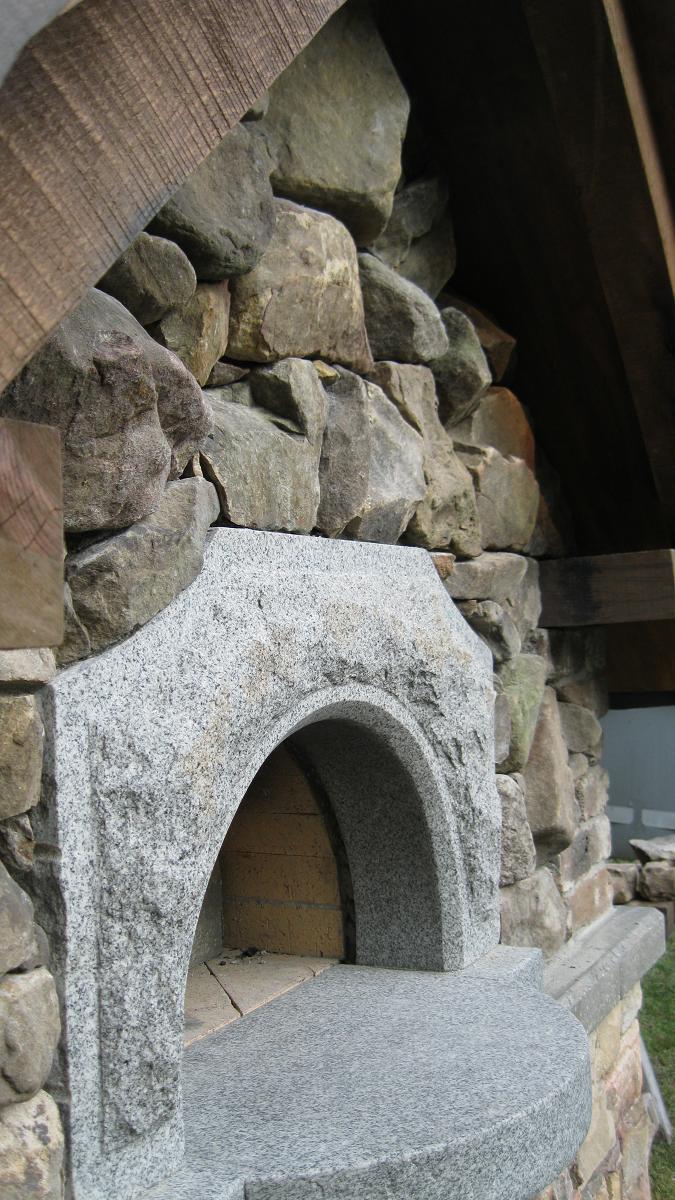

            A few more hours today, and after it gets washed tomorrow, the front stonework is complete.
            Texture shots....

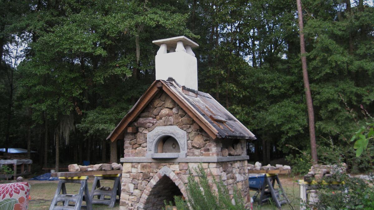

            Overview.
            Tomorrow I am fabricating granite supports for the limestone chimney cap.

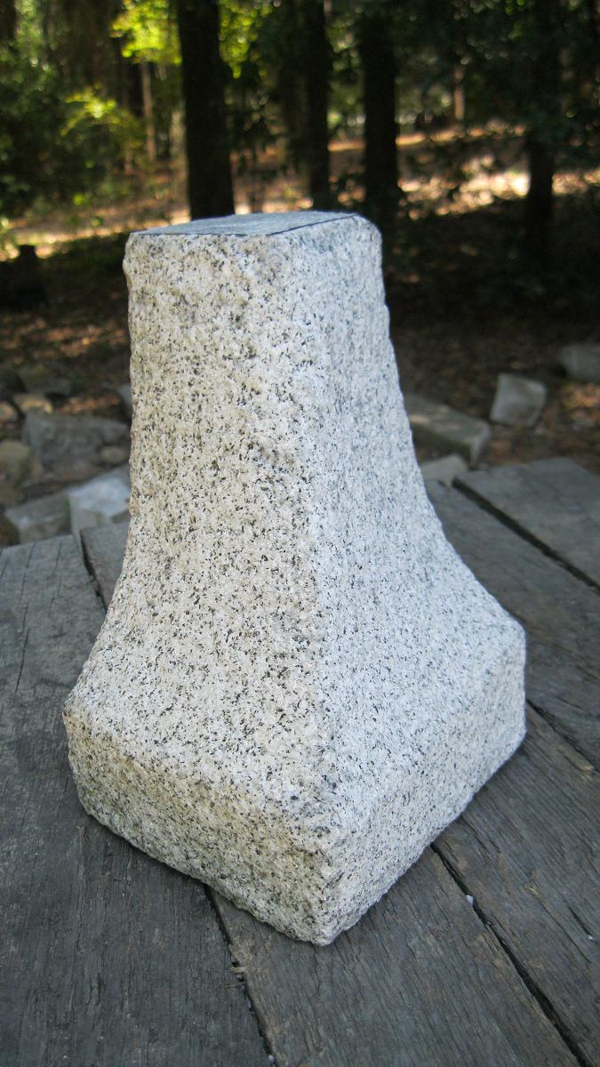

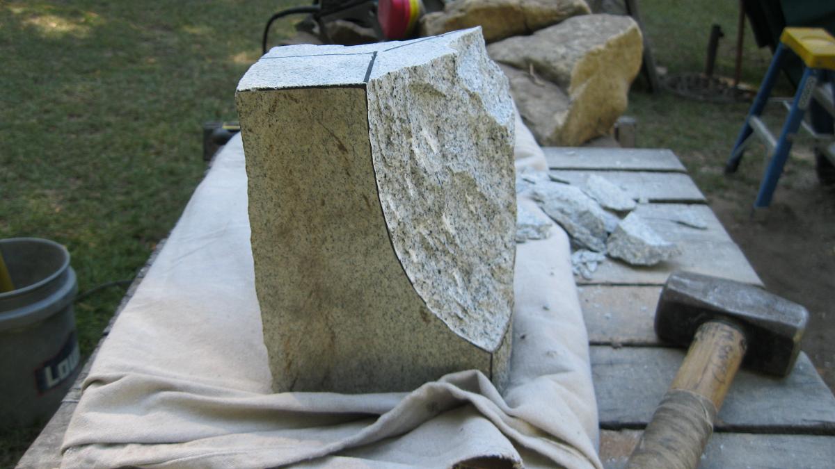

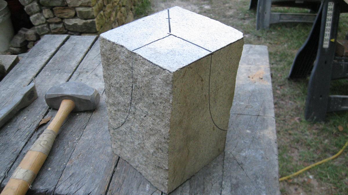

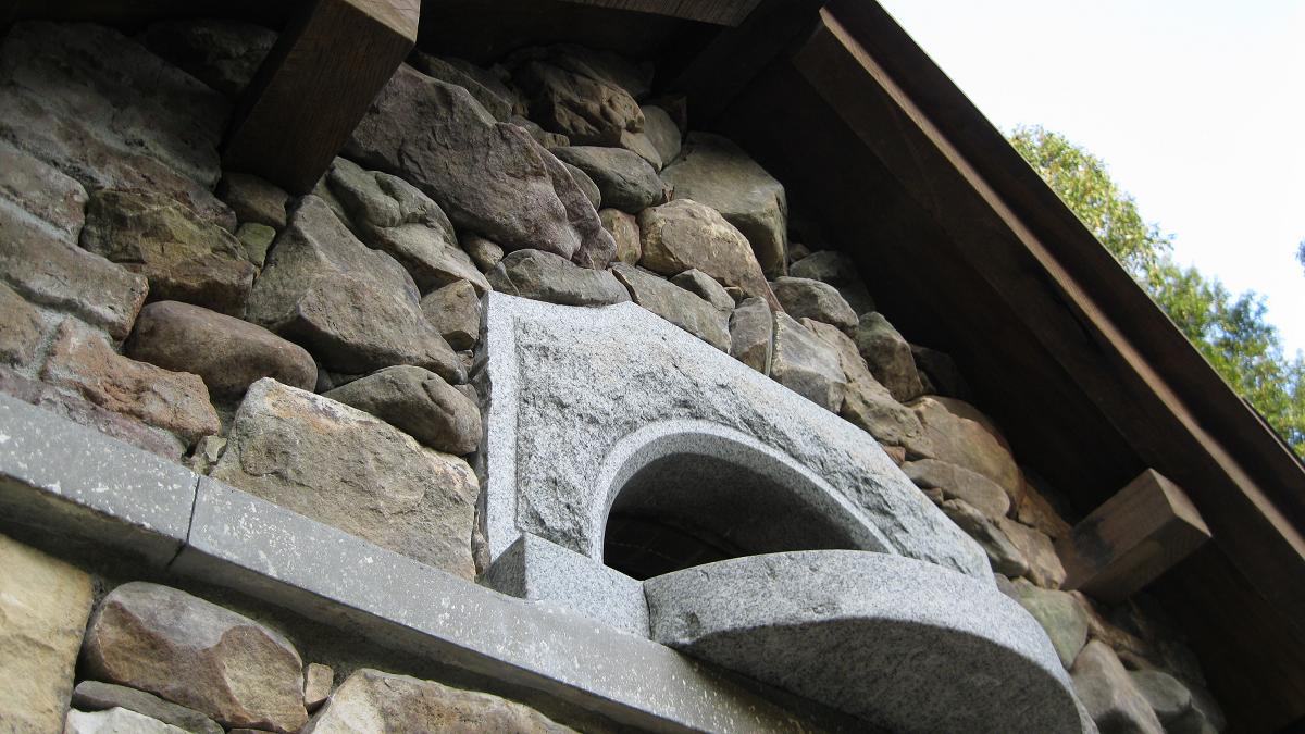

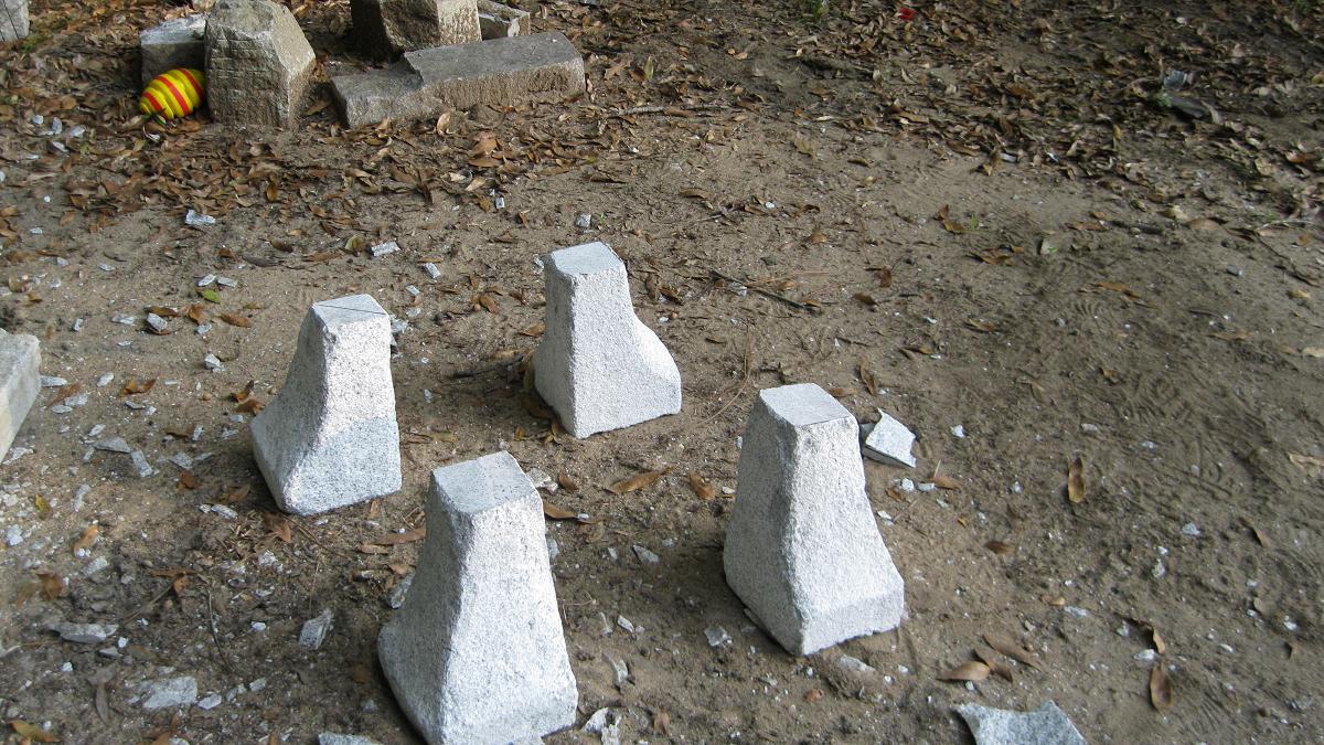

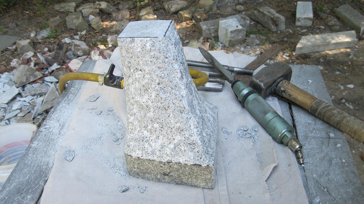

                          I carved the granite supports for the chimney cap today....took almost 5 hours from cube to finished product. I wanted to have a similar effect of that chimney I posted on #150.
                          The only time I used the saw was to cut the blocks to size, because I only had 4 block to make this work...my granite stock is almost depleted.
                          The shape was roughed out by hand chisels, and I bush hammer finished the supports with a pneumatic carving tool.
                          I have some time tomorrow so I'll have these installed, form a new crown, then set the limestone cap. I'm pleased with these, they look old and time worn.
Name:	1679 new 4.jpg

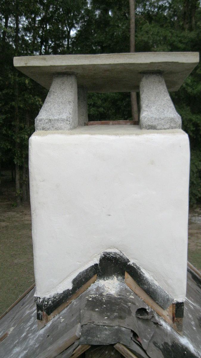

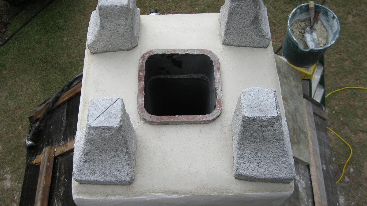

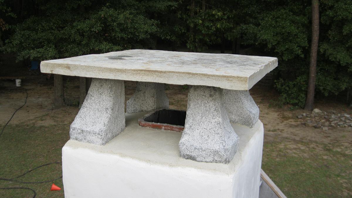

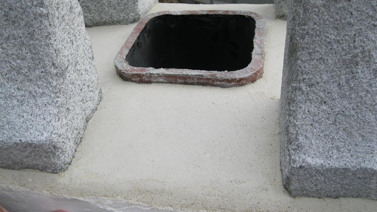

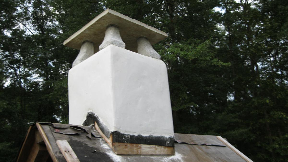

                            In spite of the heat, I finished the cap! Very pleased with the final appearance, the imperfections of the supports made it for me.
                            Here are some pics of the crown first. After setting the supports, I troweled out the crown....
Name:	IMG_1686 new 2.jpg
                            Then I tried to pair up the supports, they are all different sizes. I think knocking these out and not fussing helped achieve the look I was after.....old, time worn stone.
Name:	IMG_1691 new 3.jpg

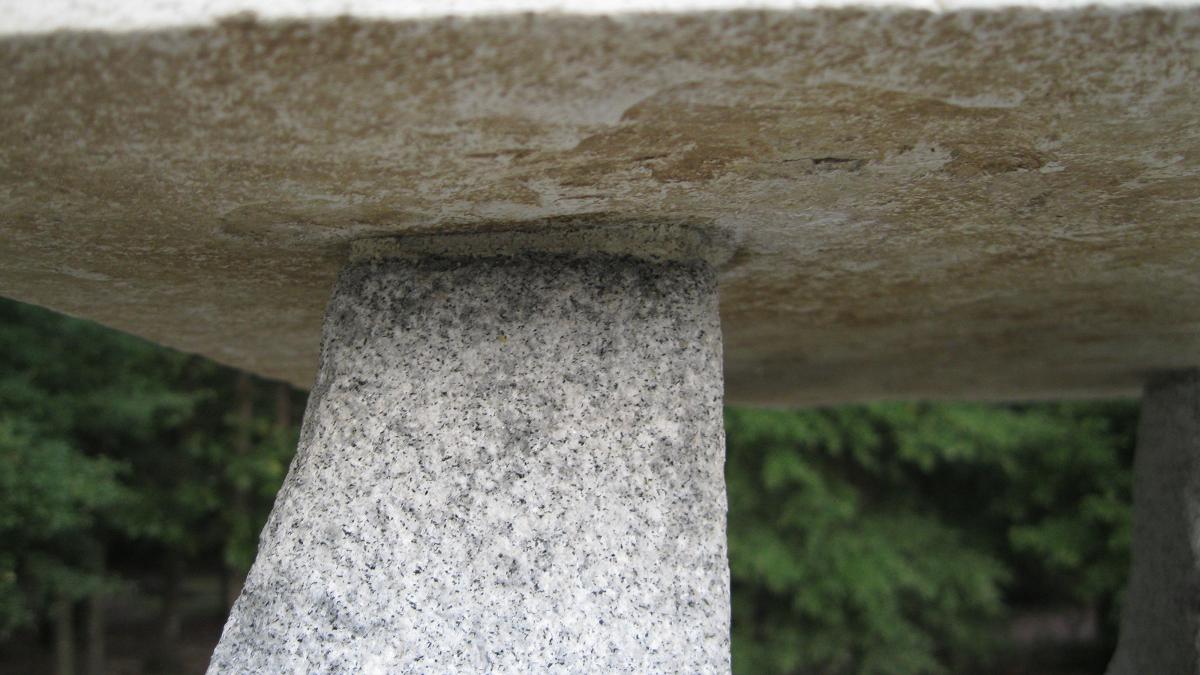

                              After the crown was done, the limestone cap was installed. It isn't perfectly square, so I had to play around with it to make it look balanced.
Name:	IMG_1693 new 4.jpg
Name:	IMG_1695 new 5.jpg
Name:	IMG_1696 new 6.jpg
                              The joint between the cap and support is about 1/8"
Name:	IMG_1692 new 7.jpg
