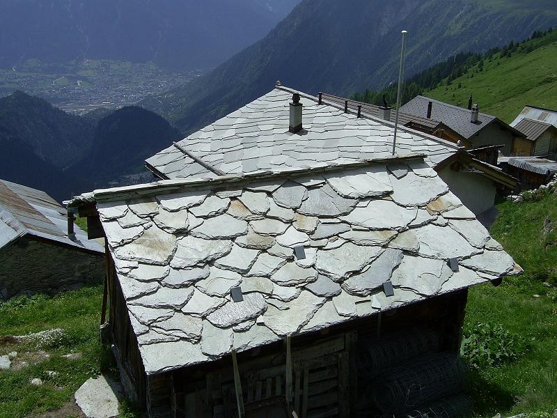

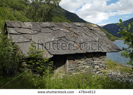

                  Change of plans on the roof. Instead of cedar shakes, I'm going back to what I was going to do originally....a stone roof. I have something in mind that is similar to these pictures....

                  I'll be getting started when I return from NE at the end of the month..no time before we leave. Now I just need to return the shakes and nails!

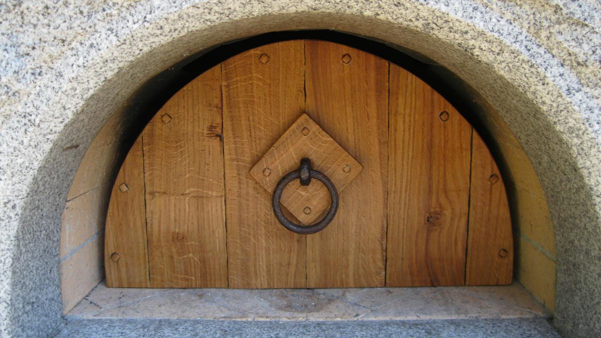

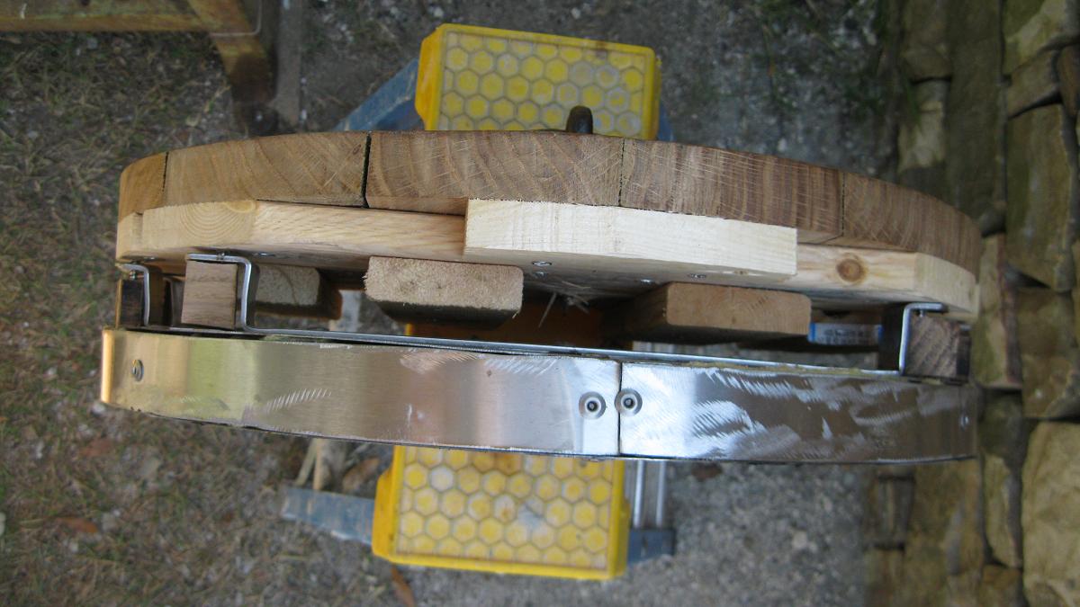

                              Another impromptu work opportunity, and my door is complete! Here is the process.......
                              I milled one of my better oak 4x4 into planks, picking one that was made of heart wood. After cutting, I ran them through a thickness planer. I chose the ones with nice figuring, and screwed them to a frame, which is attached to brackets on the SS panel. I counter sunk the screws, and then cut square pegs for the holes. Glued, flush cut, then sanded those. The door was hand sanded with 80 grit, finished with 220, then a liberal coat of Tung oil.

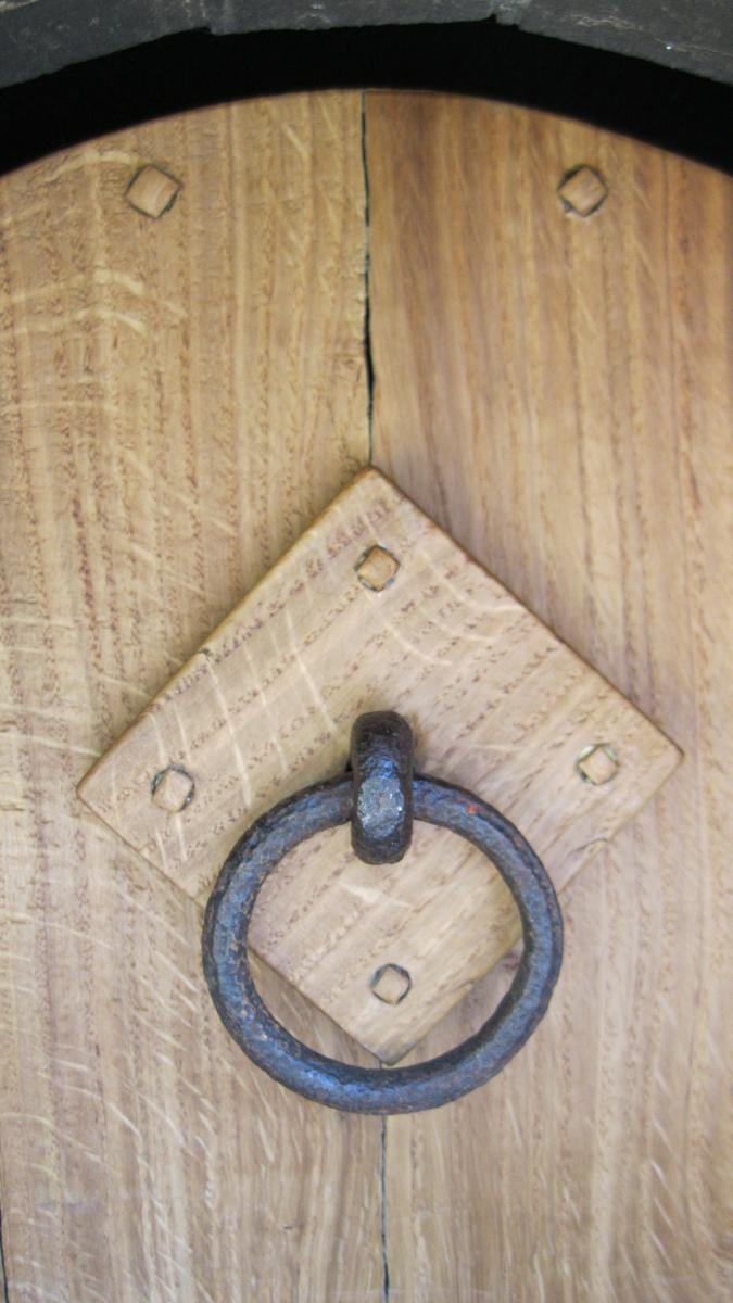

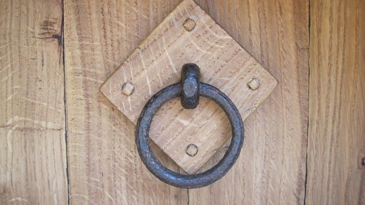

                              The iron ring is hand forged, taken from a disassembled 18th century barn. After making and installing the plate, I drilled a hole and simply friction fit the pin. I oil finished the ring, but not the pin...a little oxidation will tighten the friction and keep the ring tight. If it ever loosens up, I can put a small piece of lead flashing in the hole.

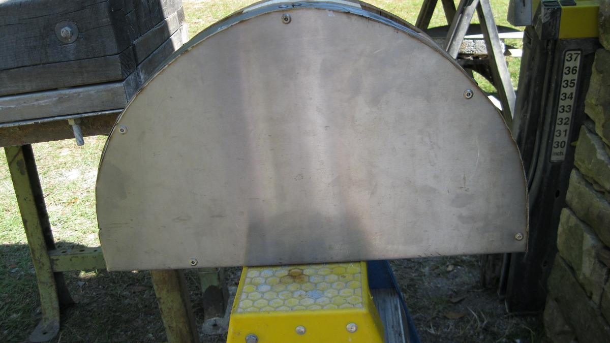

                              The SS panel was cannibalized from my old gas grill. I don't have a tig welder so everything was riveted together with 3/16" SS rivets. I made the SS brackets out of some old SS termination bar ( a masonry flashing component) One final step I might do will be adding some insulation between the metal and my wood frame, and covering it with a strip of SS....it depends if the heat effects the wood or not. I'll watch it to see what happens...but I'm thinking it won't be necessary.

                                #285
                                Re: My Wood fired Redux
                                Nice door. I also like a wooden door, but the heat cooking it is a problem, especially without an insulating panel. Only use it for baking and roasting temperatures. You can monitor the wood temperature with your hand. After a couple of hours you may find it gets pretty hot and the inside may be beginning to char. Will that one iron ring be sufficient to lift it? It looks pretty heavy.
