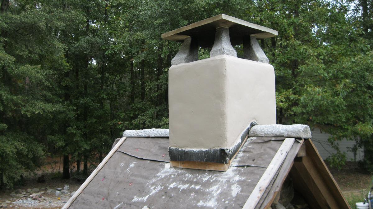

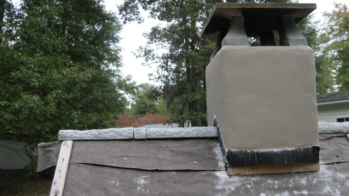

                            Another filler project done, the granite ridge caps. These are the last of my usable granite, the rest are small blocks..maybe I'll make some pavers or something.
                            I just dry set them for now.
                            After the stone roof goes on, I'll make some sort of cap for the gable end....not sure exactly yet, but I have a couple ideas.
                            The small piece will probably be set close to the chimney when it's time.
                            They will be elevated on the ridge with durock, then flashed with two layers of 30# felt or ice & water...whatever I have kicking around.
                            Aside from cutting the granite into a rectangle, all the shaping was done by hand....again, I tried not to fuss too much, I want these things to look old.
