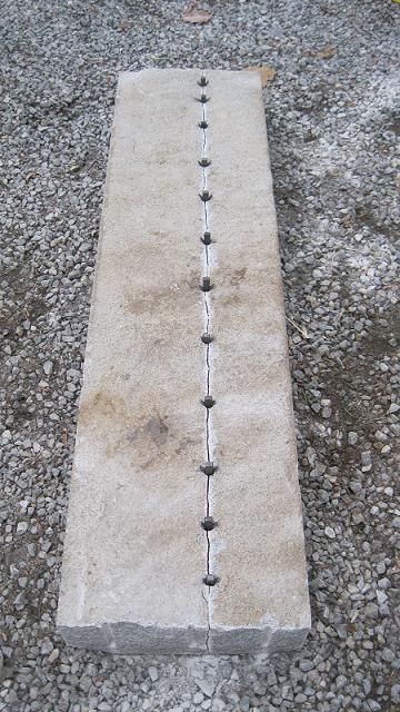

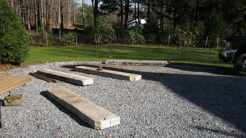

                      I was digging around my picture files yesterday, looking for something to show a client, and stumbled upon some pictures I thought a few might be interested in.
                      The pictures show were the granite components like the chimney supports, keystones, hearth and arch assembly came from. It was a project in New England, and the client had no use for the cut offs...I was glad to have them when the build started.
                      Before

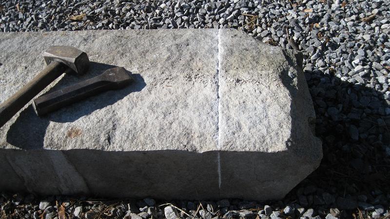

                      This is how I cut the ends to get the length I need. The hearth, arch assembly and the keystones came off end cuts like this.

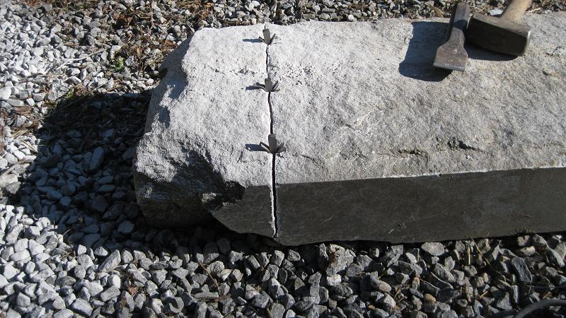

                      The smaller piece was what I cut into blocks, and then shaped the chimney supports. I was originally going to use it for a hitching post, but I didn't have any other granite that worked for the supports, so plan B it was

                        Just curious.
                        When you drill the holes and put in the wedges how often does it not crack where you want it too?
                        My Build.
                        Books.
                        • stonecutter
                          • Jun 2007
                          • 2003
                          #297
                          Re: My Wood fired Redux
                          Maybe this sounds like baloney....but never these days.
                          At least, not since my first couple months of splitting, 16 years ago. I always trace the line with a carbide chisel first, and that encourages the stone to spit along the line I choose, instead of what the grain of the stone would do on it's own.
                          Notice the chisel line in between the drill holes, and down the face.

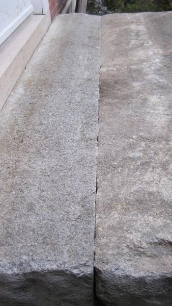

                          This is the stone in pic #2 in the above post. Notice that the break crept off the line a bit on the face. It didn't matter, because it followed my trace on the other side, and that material was removed during trimming.
                          Once you master this technique, you can fit large stone pretty tight with some chisel work.

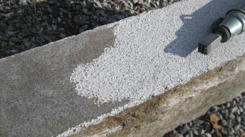

                          The only power tools used on this project were a combo hammer for the holes and a pneumatic carving tool with a bush hammer bit.

                            Sharp eyes will see the first and third stone in the first picture of the full size granite ( post #295) are missing one corner each.
                            Those are the ends that were cut off, then carved into the arch and the hearth.
