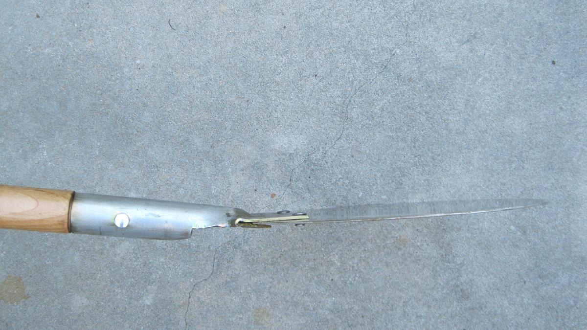

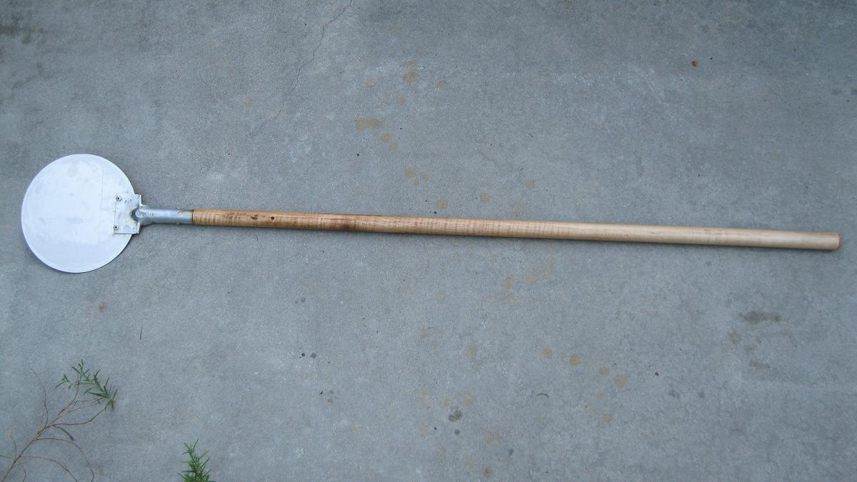

    Cool find at a local hardware store. They got bought out and this broom handle was like 4 bucks, and it has a little figuring in the wood too. The SS was given to me by a friend, who cut it at 8" for a turning peel.
    This isn't exactly what I wanted to do with this piece of stainless, but it will do, and I don't have time to make anything nice right now. I hammered the metal broom attachment flat and riveted the peel with 3/16" SS rivets. The peel metal is thick.... it's like 10 gauge, so no floppiness at all. I left a slight angle to keep the rivets off the brick and to be more ergonomic while turning pies....it works great so far.

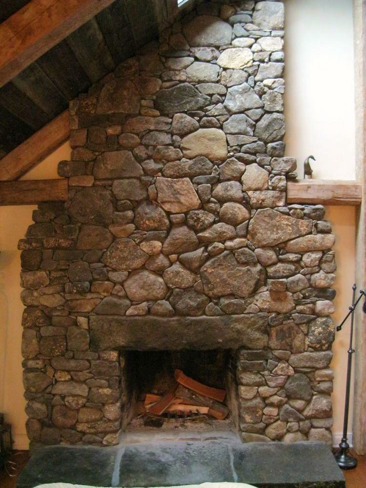

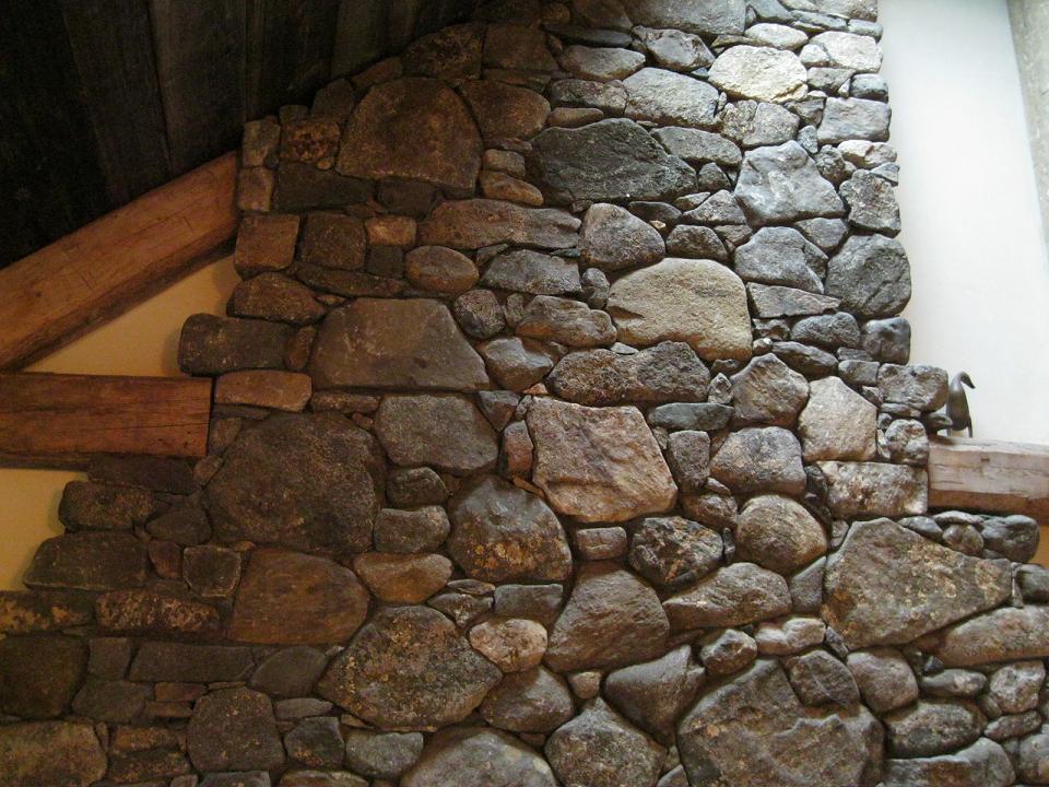

              This is almost what I have in mind with the stone I have...
Name:	CFP2002 CLOSE.jpg
              We did that FP in '02 with handpicked fieldstone off walls on the property. HO wanted something similar to what he saw in an old local tavern. My oven stonework will have the randomness of that FP, but I'll orient some of the stone at steep angles....which is more free-form.
              I think it will off set the coursing on the base well enough, without looking out of place.
              Oh, and not one stone was cut with a saw or grinder. I used a mason hammer to powder off a bump here and there, but that was it.
