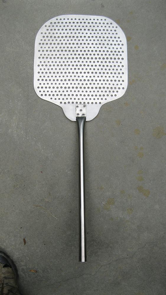

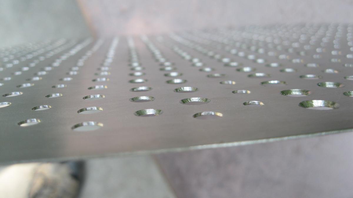

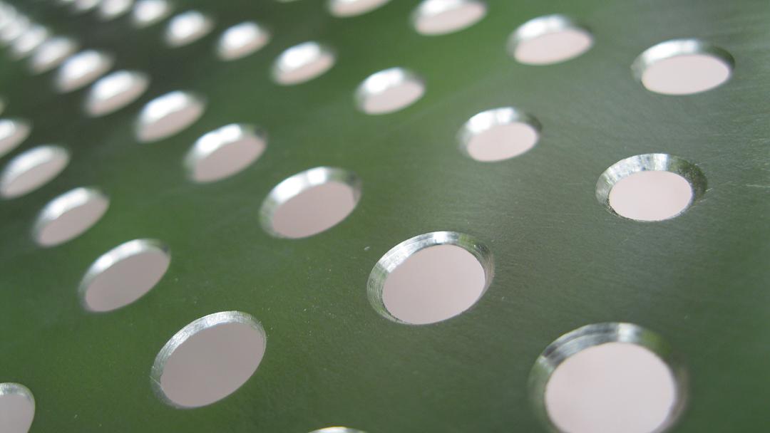

          The perforated peel worked pretty good, and it definitely launched pizza better than my wooden peel, but I think the crisp edges of the holes may be a bit grabby sometimes. So I beveled them in an effort to lessen any drag. I made some dough to test it out tomorrow..we'll see if my hunch is right.

          The rivets are 3/16" SS

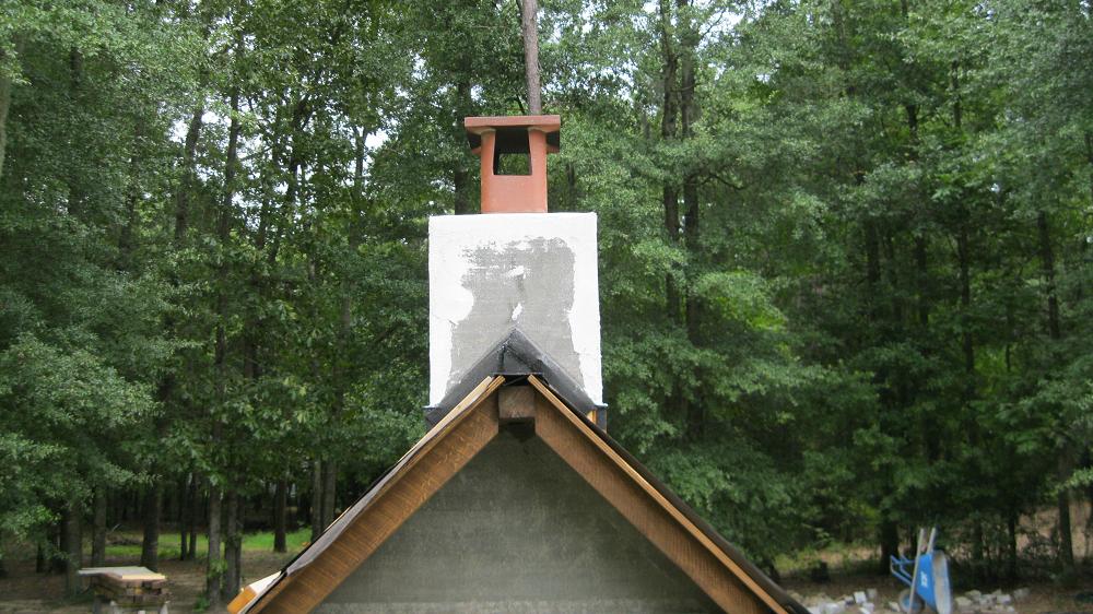

            Today I managed to sneak some work in before the rain started. I finished the brick on the back corners, so stone work is next. I taped off the corner joints and installed hardware cloth to the durock on the chimney for the scratch coat tomorrow.
            The chimney will be capped with a flat stone, with corner supports carved from granite...I have yet to make those. The crown will have a stone drip edge, and a tapered parge to the flue.
            Until all that is done, I made a temporary chimney pot from a scrap piece of flue and the cap is an old 12"x12" pressed concrete sample. I'm glad it was still around....it works pretty good at keeping rain out of the flue.

              #201
              Re: My Wood fired Redux
              Great temporary fix for the cap. Can't hardly wait to see the final "finished wide angle" reveal pic of the build.

                #202
                Thanks Gulf...getting close. Cedar shakes, stonework, chimney stucco and some detailing are the last major steps left.

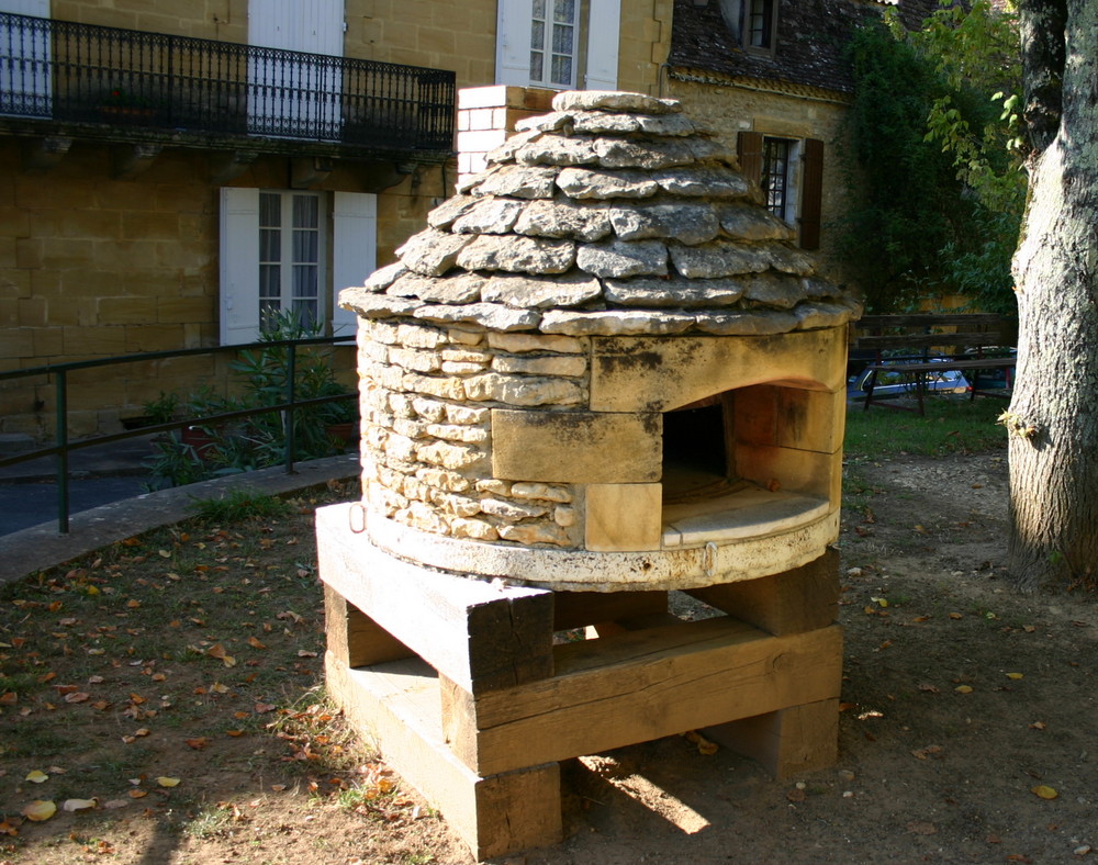

                      Maybe a bit premature, but I will probably be starting another oven as soon as mine is done...which will be at the end of Sept.
                      The design will be something like this, but without the rear exit chimney.
Name:	15667677 GREAT WFO DESIGN IDEA.jpg
                      I'm psyched because I was going to do a stone roof similar to that on my current oven, but decided I wanted to shave weight off.
                      The elements that I am taking from the picture are: The round enclosure, stone veneer and roof.
                      I REALLY want to do a rib vault base, but at the very least...I'll do another pointed vault like the one on my oven, except it will be all stone.
                      Did I mention I'm psyched about it?

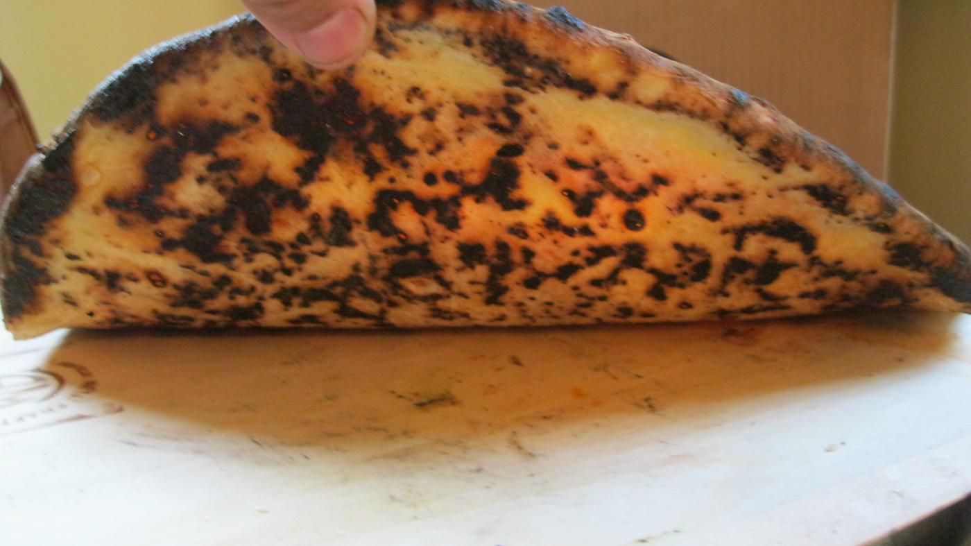

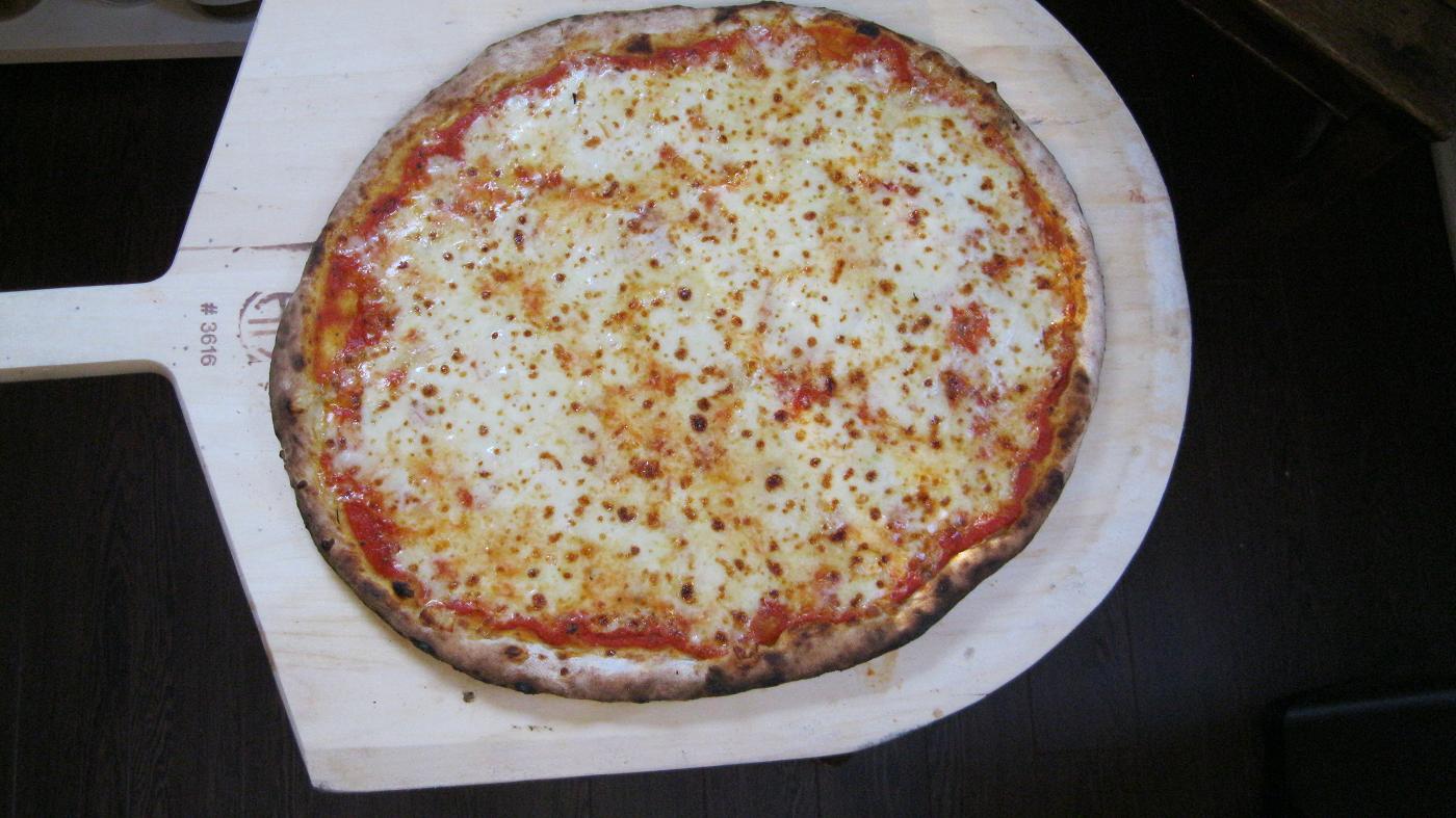

                                Here is a pic I found on the camera from last Saturday....it is one of the last pizzas of the night. We had run out of dough, so Mom made a small batch of her 'fast' dough...this was 1/2 hour after it was made. Oven was running hot, I would guess 800*-900* at the time. This got made for a bunch of hungry kids coming out of the pool.
                                Thin crust crust style.
