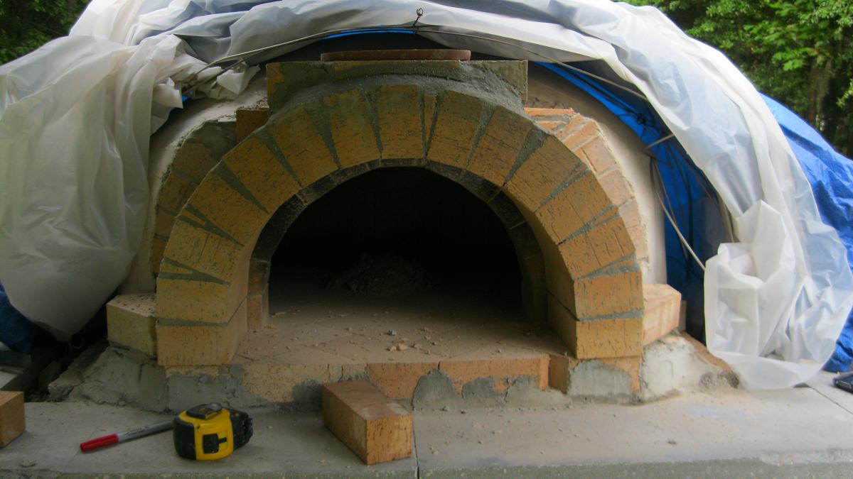

        • Re: My Wood fired Redux
          Built the vent and flue base yesterday and that's the last of the brickwork. I incorporated a thermal break in this vent, the first one. The reasoning is sound, and vent walls are never tied into the oven arch anyway, so I thought, why not? I'm going to pack it with mineral wool and then a black stove gasket, tucked back a bit.
          I opened the arch by a little over 2", creating a 1" reveal for the door (yet to be built) This arch is better than the oven opening, because my granite one is going to be clean, and I don't want the vent brick visually breaking the arch I carve in the stone.
          Old World Stone & Garden
          John Ruskin

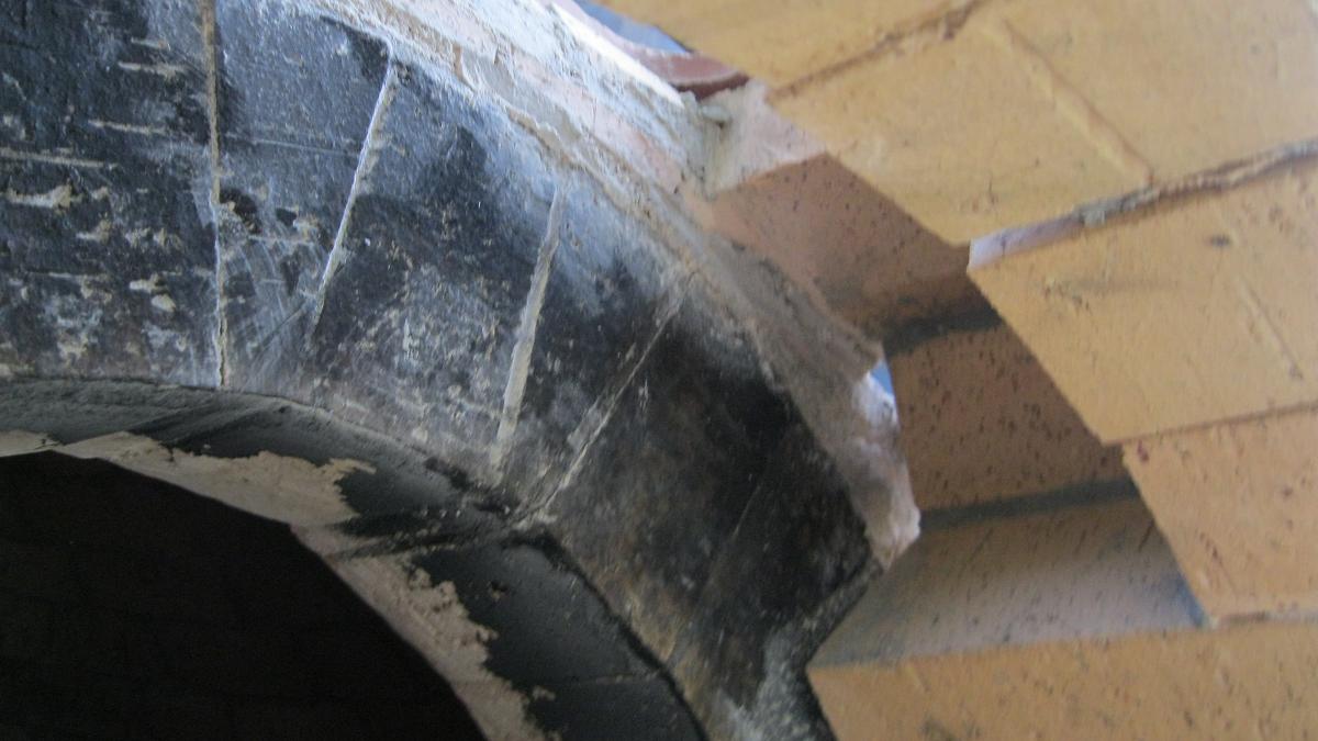

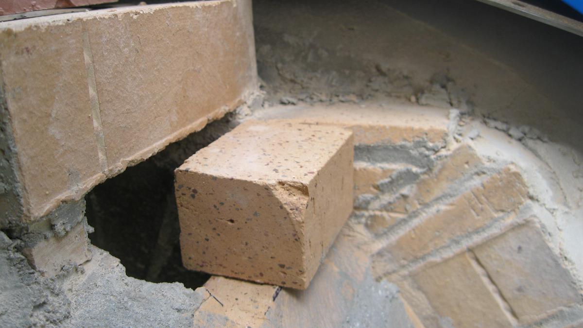

            For the last brick below the flue base, I beveled the last full brick in the arch to create a sort of ledge. This allows the filler brick to lay at a right angle, and tuck under the flue base to transfer some of the flue weight into the middle of the vent brick.
            The ledge...
            Filler brick. This isn't the one I used, but a piece for testing the fit and angle of the bevel.

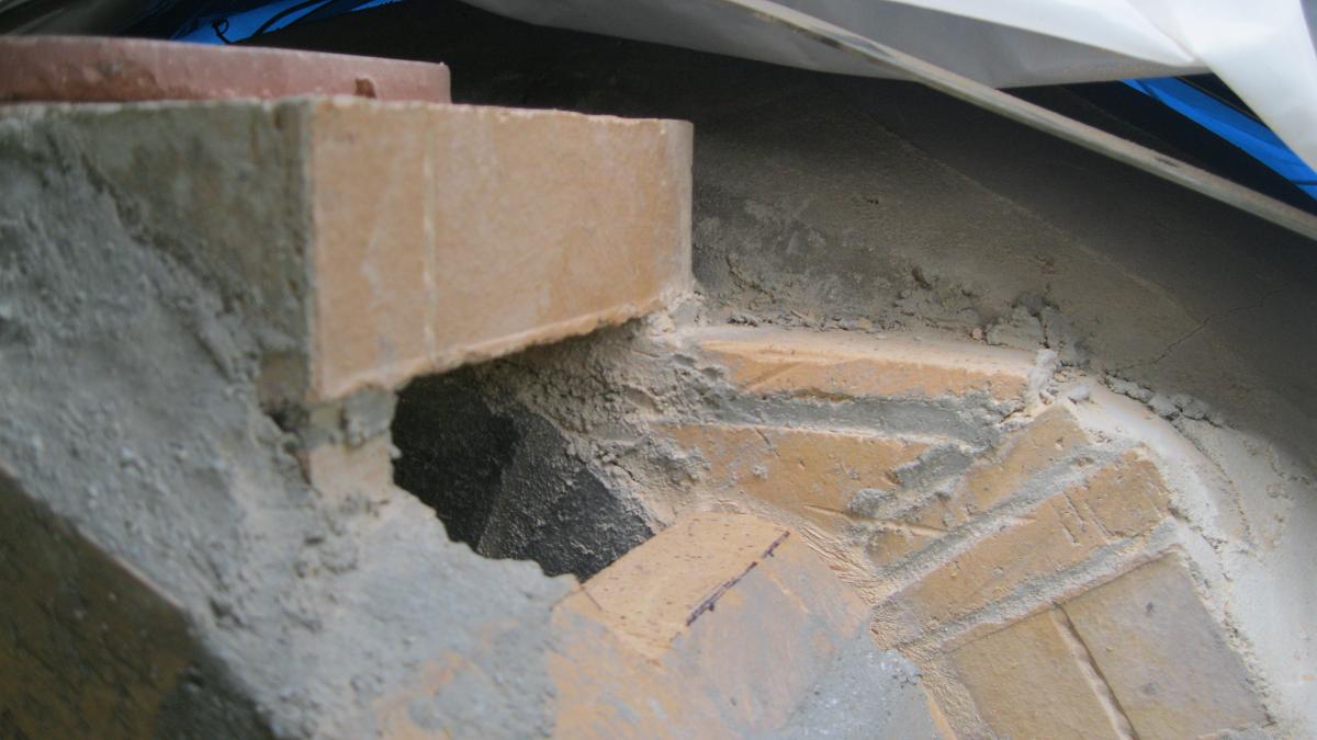

            This is the inside after the piece is mortared in.
            The opening starts at 11" and opens to 16" in the final full brick. The filler is beveled to direct gas and smoke towards the flue opening, to the 8" flue. This creates sort of a smoke chamber and I've had great success with this in the other ovens. Not necessarily needed, but it works, and it's no extra trouble to do.

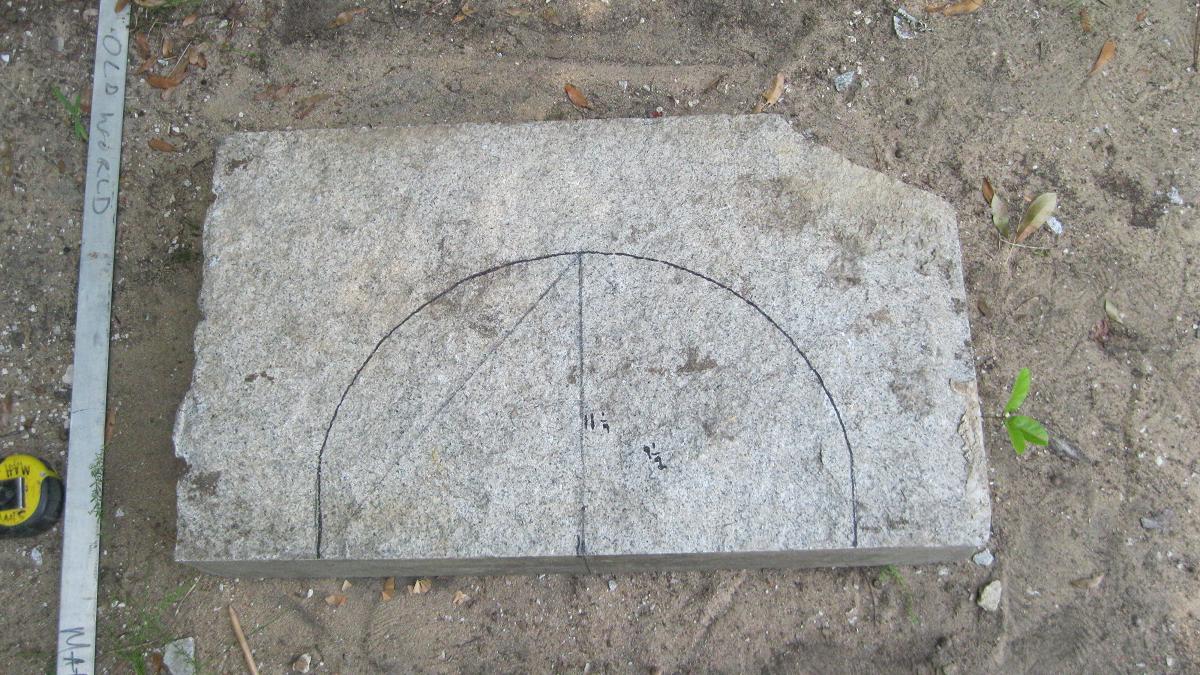

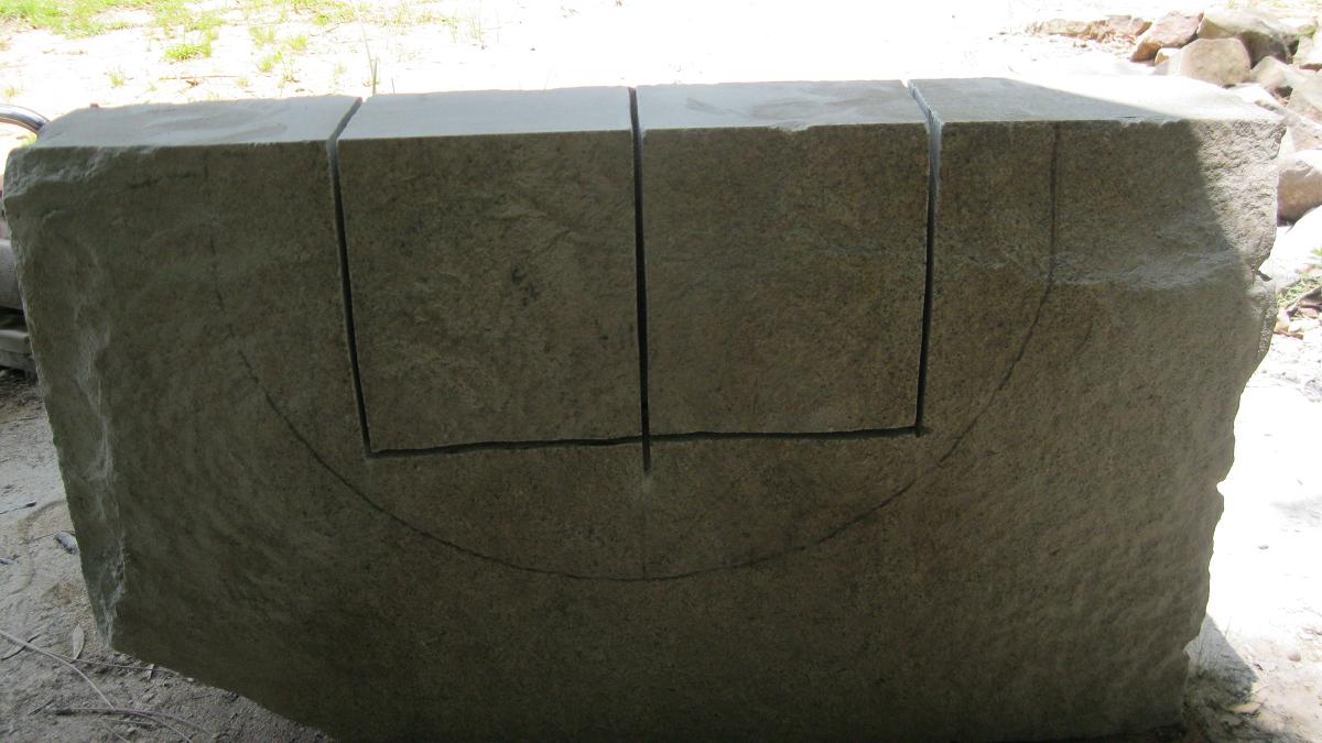

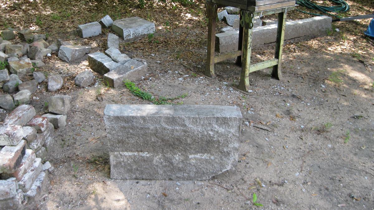

                    Put some time into carving the granite for the outer arch. Rain and T-storms shut me down before I had a chance to finish it. I'll keep picking away at it as time allows...tomorrow will be material pickup and the start for the framing.
                    This is the piece I am working with. It is a remnant off a 10ft granite step project I did in MA a couple years ago. This granite is typical of what is used for curbing and parapet walls on bridges....nice even grain (homogeneous)
                    The arch matches the vent on the inside, and I made the outer line 3/8" larger..just enough to gently flare.
                    Removing the waste in large pieces first...

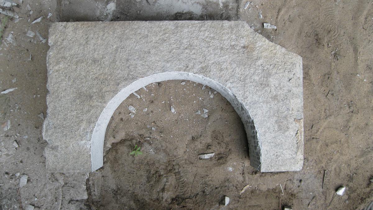

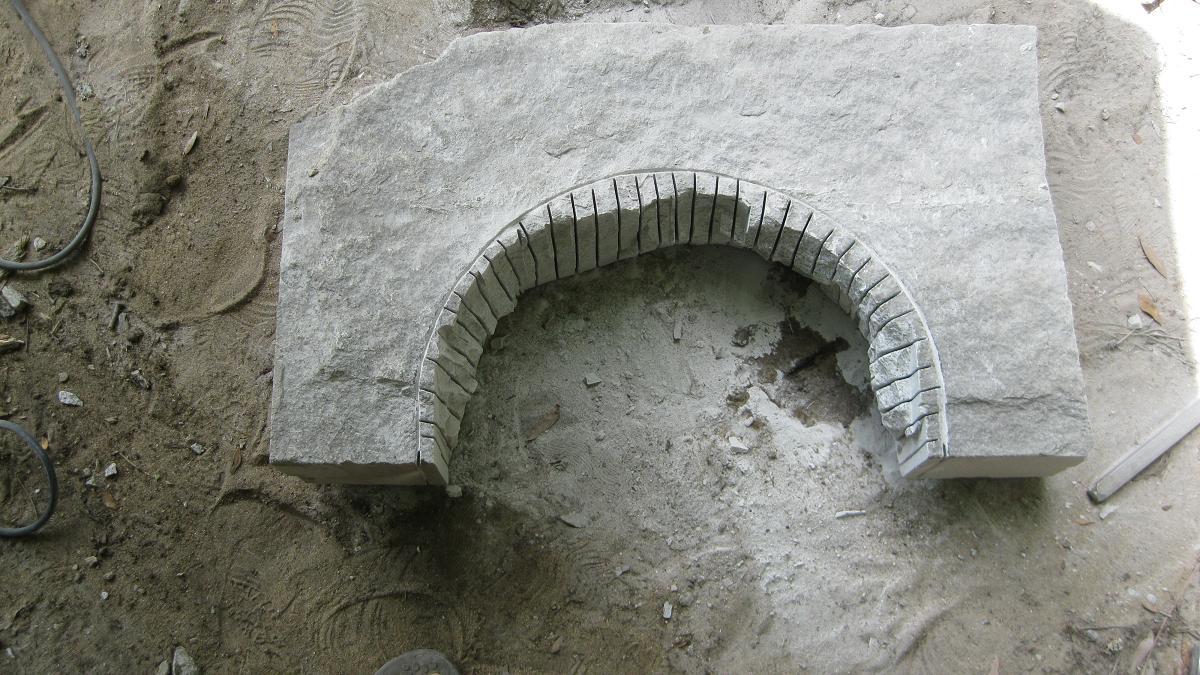

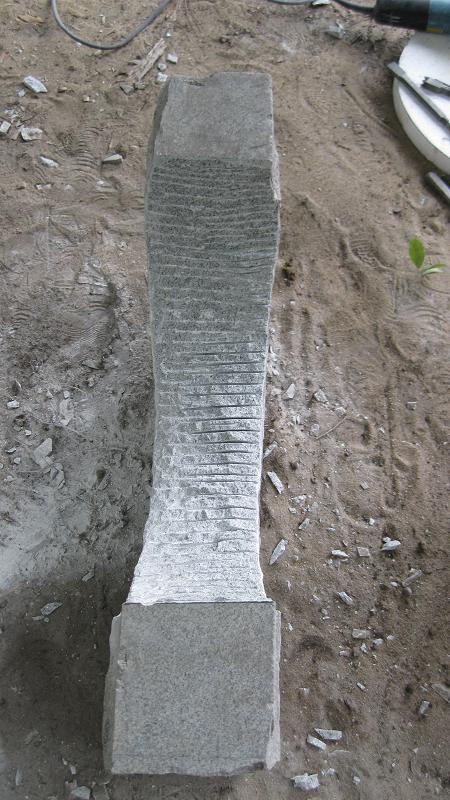

                      The closer you get to your line, the less aggressive you should be. Small relief cuts and easy hammering.
                      The radius is taking shape.
                      This is where I'm at because of the rain. A couple more hours should do it.
