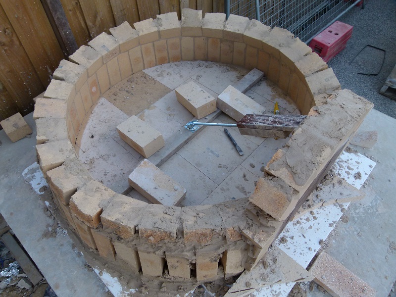

          In the #4 photo of your rebuild, it may be an optical illusion to me, but are the solders leaning inward somewhat? If so, are you planning a headstart on the horizontal travel of the Dome? Looking Good!
                    First Solders course leaning a little inward just to get next course a little easier on a angle.

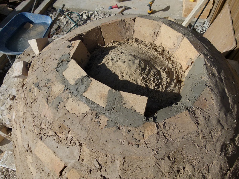

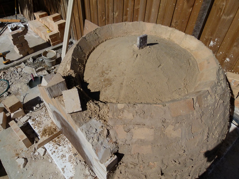

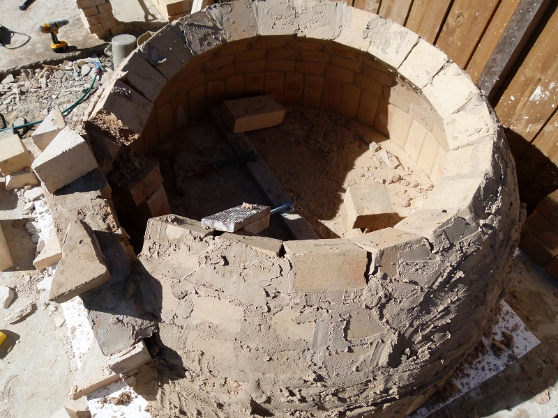

                      This is where i got up to in last few days, I've been working my ?ss of to get the dome done, and now i need to concentrate on front arch and chimney.
                      I've got few questions should i put 2 layer of ceramic blanket straight on the dome or i should add extra mass, like a layer 50mm of shiracast Cement to my dome first and then blanket and than another 50 or 100mm Shiracast cement and sand?
                      Can i leave my dome exposed to any rain now or should be covered?
                      Any advice how can i finish the front arch and chimney, would be appreciated? Click image for larger version

                      The angle got so bad on the 5th course of the dome,it come to a point where i got worried that everything will collapse bit it didn't.
                      Then i pack some sand to get the dome closed.

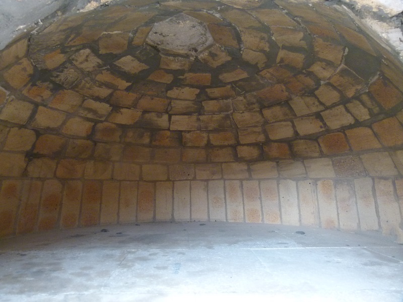

                      Can i shave some bricks with angle grinder inside the dome there is some bricks which are sticking out a little to make a look nice or just ignore?
                      Cheers Dario

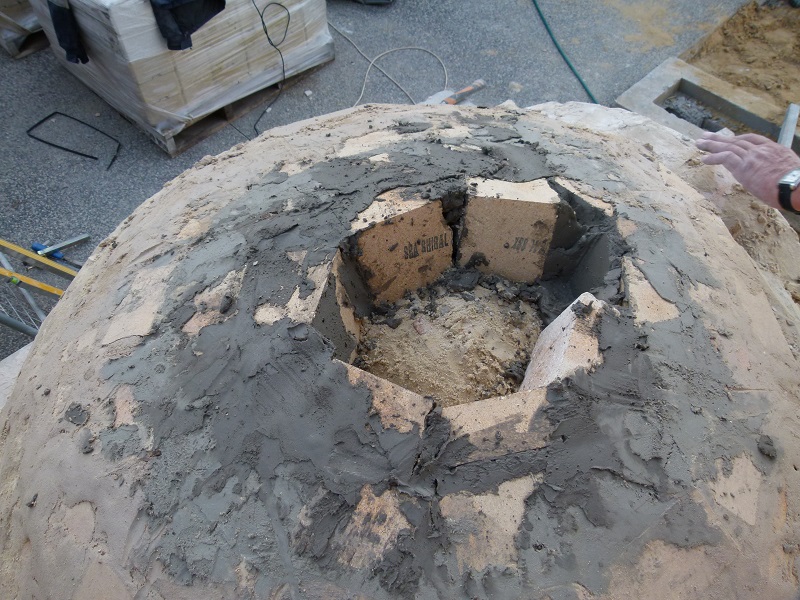

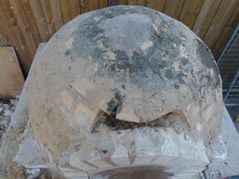

                        Ive mixed some castable cement and pour on the top to close the dome.
                        This is the outcome and inside the dome today.Click image for larger version
                        Thanks Dario

                          The thickness of brick you have should be quite sufficient. If you want to add more thickness and strength it will give your oven more thermal mass, but will require longer firing to heat. Using Shiracast will not contribute much to strength as it is an insulator.The usual method is blanket straight on the dome. If you are building an igloo then a lower quality and cheaper insulation like vermicrete over the blanket to even out the lumps and bumps, providing you with a firm layer to render over. If building a dog kennel, just fill over the blanket with loose vermiculite or perlite or fibreglass roof insulation.
                          Yes you can grind the inside bricks to improve the look of it, but wear a respirator or mask, the brick dust is hazardous, particularly when you're in an enclosed space.

                            G'day Dario
                            I just leave those bricks alone myself. The face of the brick is the hardest if you cut into the bricks they are a little more porous. If you worried about looks once you have completed the entranceway the view inside the oven becomes quite small. All your guests will be amazed how bricks can be turned into a round structure.
                            How long did it take to complete the dome by the way.

                              I wont touch the Bricks i like the way they are it's not perfect but at least they will do the job.

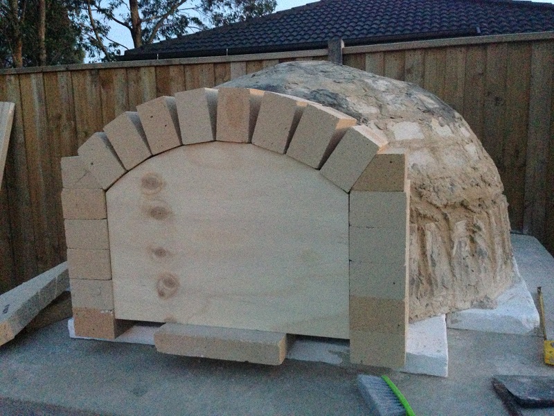

                                Today i have experiment the front arch the way it may look?
                                I've made temporary door and arch and i really like it the way it looks, what you guys think?
                                Any comment, advice?
                                Thank you
                                Dario
