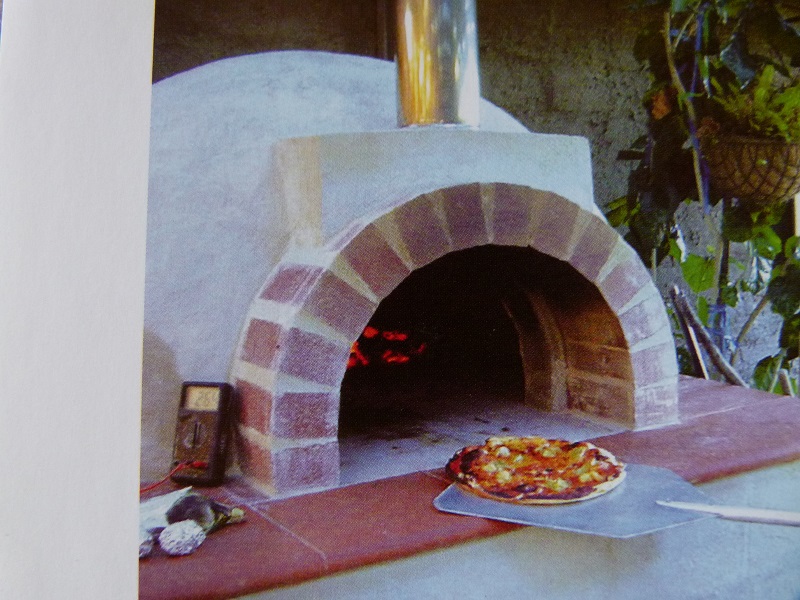

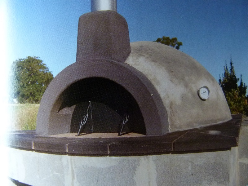

                    Stainless will go on the top as a chimney nothing fancy similar to this pictures.

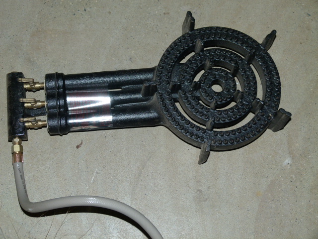

                        I've got gas burner today and i am ready for curing but just need to decide how am i going to finish the oven, blanket straight to brick work or Shiracast then blanket then Shiracast again and then render.
                        Colin seems the gas burner worked well ?
                        Cheers Dario
