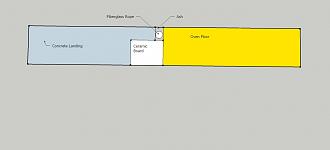

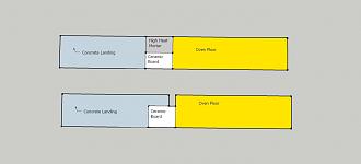

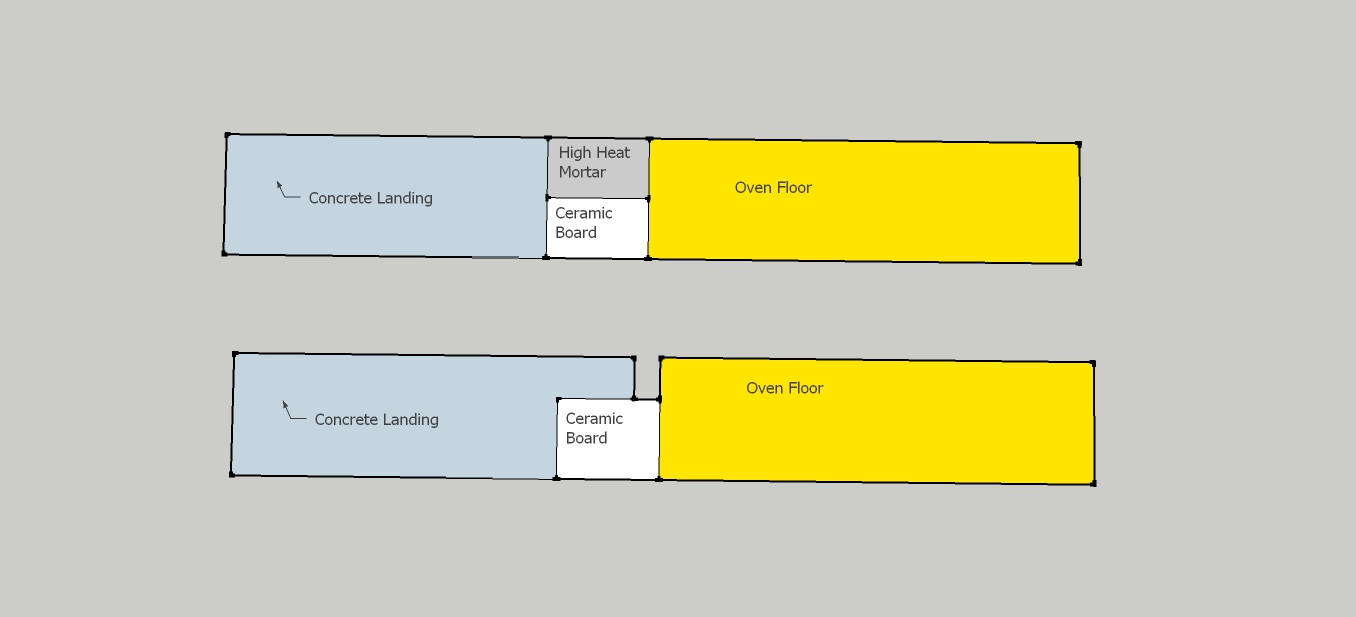

        • #49
          Alright, I think I have a grip on this after looking at your pictures and reading some other heat break threads.
          I've come up with two plans. This is a side view of each.
Name:	Heat Break.jpg
          The first uses high heat mortar (that came with my casa oven) over a piece of insulating board. The mortar would help me get a nice continuous smooth surface between my concrete landing and oven floor.
          The second uses the insulating board and then a small air gap (maybe 1/4" ?).

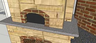

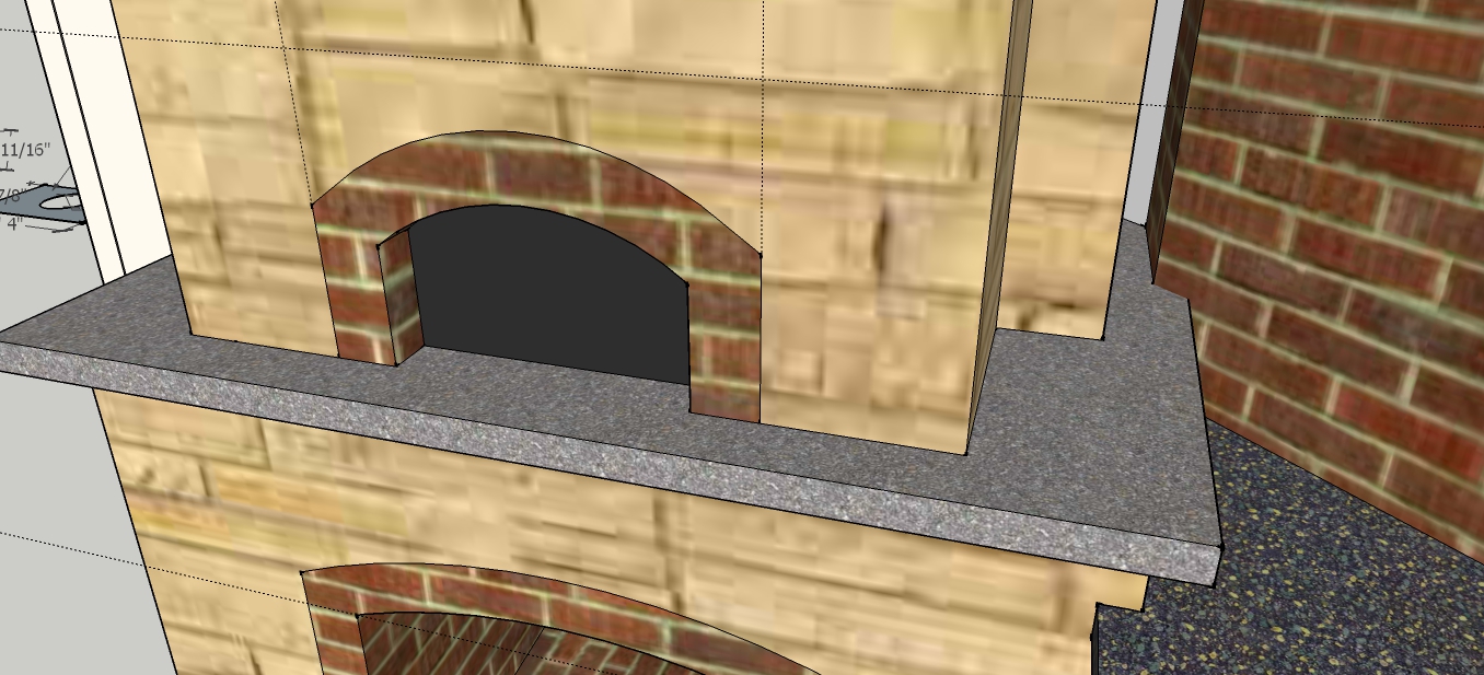

          My primary goal here is safety. I want my landing out in front of the oven to be cool enough to touch. I have little kids running around in a small space. I don't want anyone getting burned. To be clear, when I say "landing" I'm talking about the grey concrete counter that you see in this picture:
Name:	wfo landing.jpg
          That concrete counter will abut my oven floor as seen in my 2 heat break diagrams above. So all that being said, which of the two designs would be best for keeping my concrete landing cool?

          • #50
            Originally posted by terdferguson View Post
            What is the material filling the joint between your oven floor and outer arch?
            I use some ceramic blanket and then to seal it off stuff some 5:1 vermicrete over it for a depth of around 8 mm.
            Your first drawing does not allow for any expansion and heat will still conduct through the high heat mortar. In the second drawing There is provision for expansion provided the insulating board you've used can be compressed somewhat.

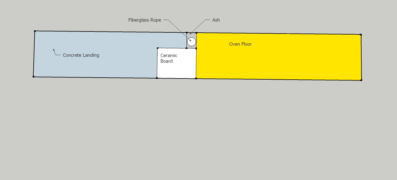

              • #52
                Hey Randy, that gap looks tiny that you are stuffing that ceramic rope into! How wide was that? And you topped it with ash from one of your fires?
                • #53
                  The gap was 1\4"wide. I used 5\16" ceramic rope to fill the gap. And yes the fill on top was just ash from one of the fires. It seams to work pretty good. The front lip on my oven never seams very warm. But that I think is more from the cool air flowing over it in to the oven.
                  Randy
                  • #54
                    That's great Randy. I think I'll somewhat copy what you've done. I'm going to have a lip built with my concrete counter and under the lip I'll put ceramic board or blanket. Then have a small air gap filled with the rope and ash. I think this will be a winner. I only have about 7" of counter from were it meets the oven floor to the counter edge. That's not a lot, so the more I can isolate it from the heat the better.
