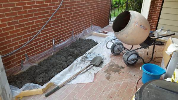

            Got a lot done the past two weeks. Poured my concrete slab for my counters:
            I rented the concrete mixer from home depot. I'm not gonna lie. That might be the best decision I've made in my entire life.

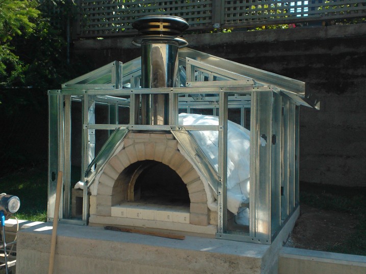

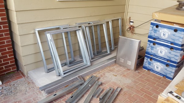

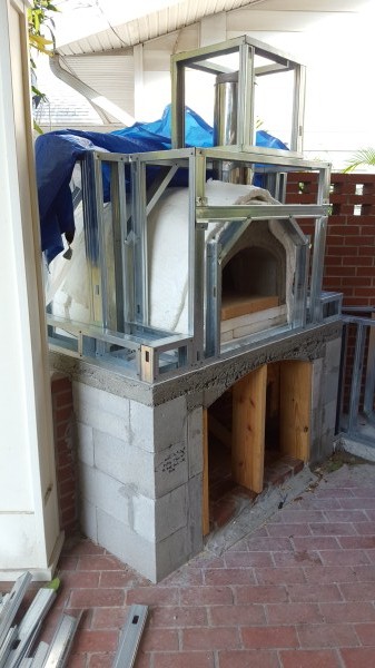

            Then I did my framing for the wfo:

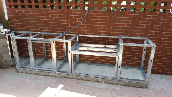

            And the framing for my first counter:

              Looks like it is all comming togather nicely. It really feels good when things start to look like they might actually get finnished. Keep up the good work. It is looking great.
              Randy

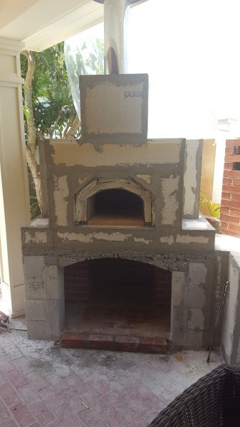

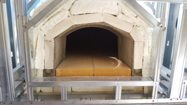

                  As mentioned before, I'm concerned about the counter and brick arch in front of the oven getting hot. I'm insulating the brick arch. What I've done is taken some of my insulation board that goes under the oven and cut it into 3/4" pieces. Then I attached those pieces to the front face of the oven with some high temp silicone (750 degree). Now it looks like this:
                  I'll have my brick arch butt right up against the insulation. You may notice that the insulation doesn't come all the way to the edge of the oven opening. I left about 1/2" all the way around. There will be a gap there between the brick and oven face. I'll fill the gap with a product called insulstick (an insulating high temp mortar).
                  • #69
                    Well, I mortared my decorative brick right to the fire brick and I haven't ever even noticed it getting hot. I used regular mortar too. I think maybe you are anticipating a problem where there isn't one. At least not where it has been experienced by other builders.
                    But since you decided to go this way, make sure you fill the gap between your vent brick and your decorative arch, or you are going to wind up with an oven house full of smoke and soot

                    • #70
                      Oh wow, really? The guys at forno bravo told me the brick arch would be too hot to touch if I mortared it right onto the front of the oven. So I was going off of that. But if you guys say it'll be safe to touch then I'll remove the insulation pieces and mortar it right on there.

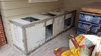

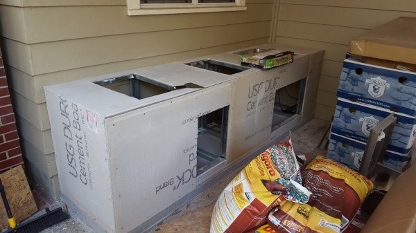

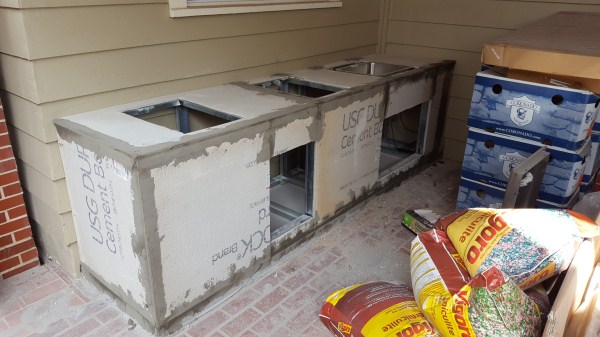

                              Got all my durock up last weekend.
ID:	387332 Click image for larger version

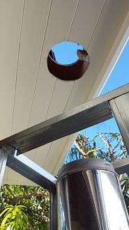

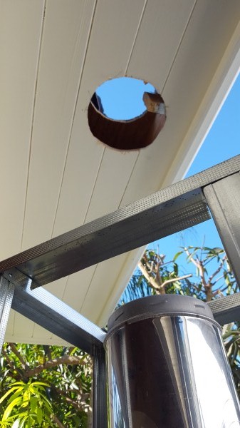

                              At the same time, I had the flue installed. I had my contractor who built my roof come out to do it. The flue goes through the ceiling.

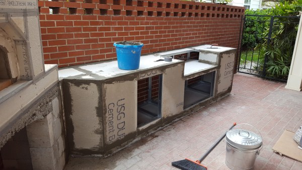

                              • #75

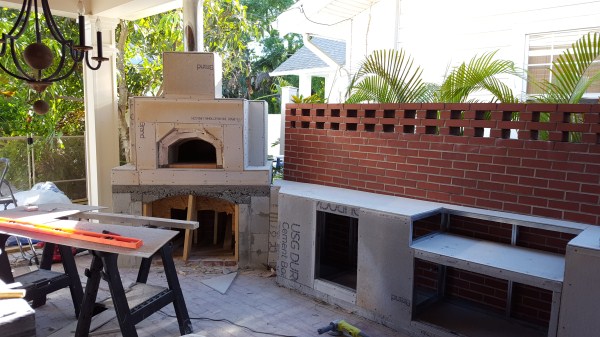

                                Yesterday I got all my seams taped and covered with thinset.
ID:	387336 Click image for larger version
ID:	387337 Click image for larger version
