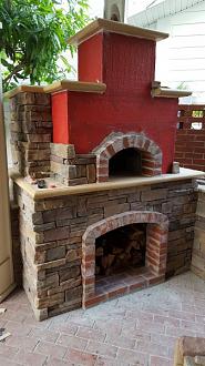

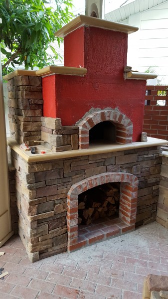

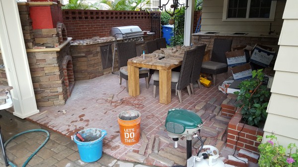

        No I have not forgotten about this thread. I had vacation and a lot of other stuff going on so the project had minimal progress for a while. The big hold up was my concrete pieces that I subbed out. Those guys took an extra month to finish the pieces, but once they finally went in I could continue with the stone veneer. Here are the concrete pieces in and some stone veneer done:

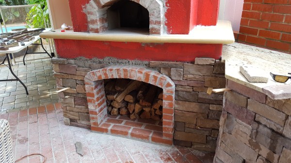

        each day I made a little progress....
        until I was placing the final pieces....
        Somewhere in there I also built my small brick arch which turned out well.

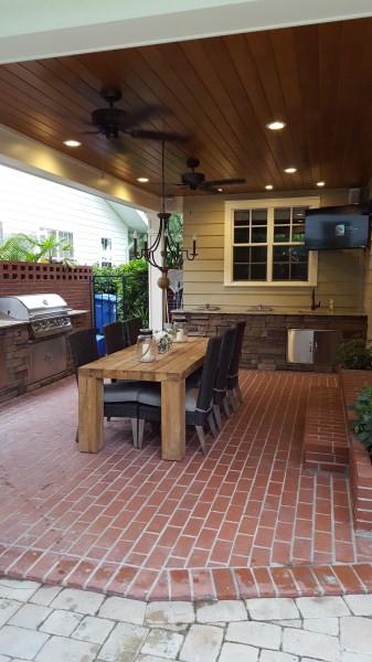

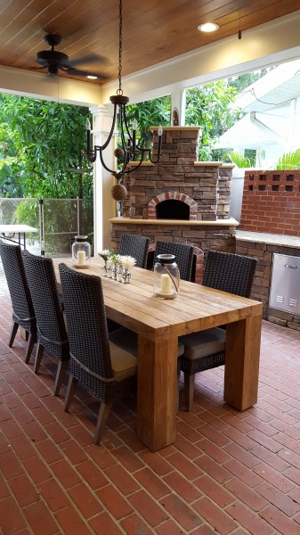

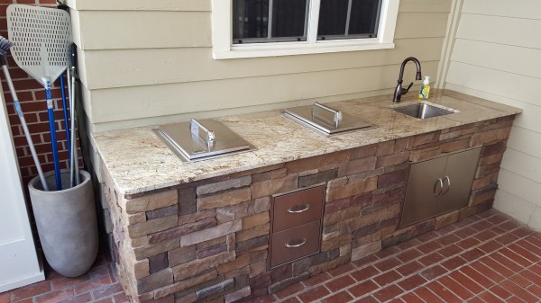

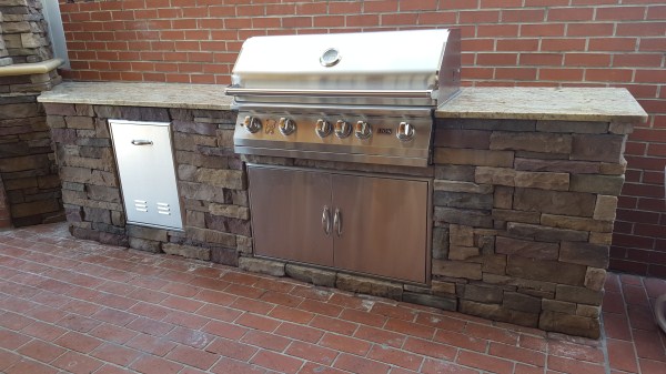

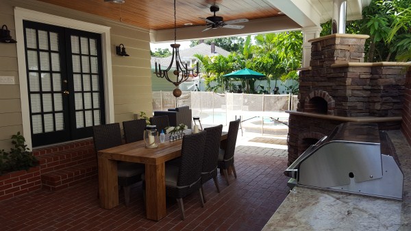

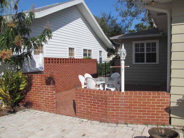

          And now the project is complete! Woooo! Here are the final pictures of the wfo and outdoor kitchen with a pic of the original patio for comparison:
          Huge thanks to Randy, Utah, David S, and others who provided invaluable help along the way. This site is an amazing resource. People have been amazed that I was able to build this thing (frankly I'm kind of amazed too). When they ask me how I did it I mention this site of course. Thanks guys!

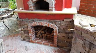

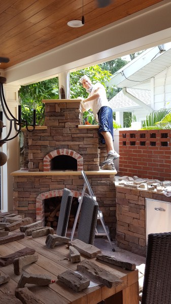

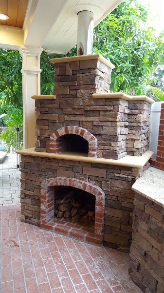

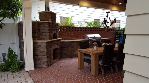

            A few more pics...
