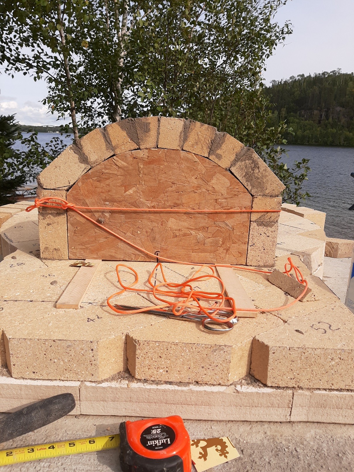

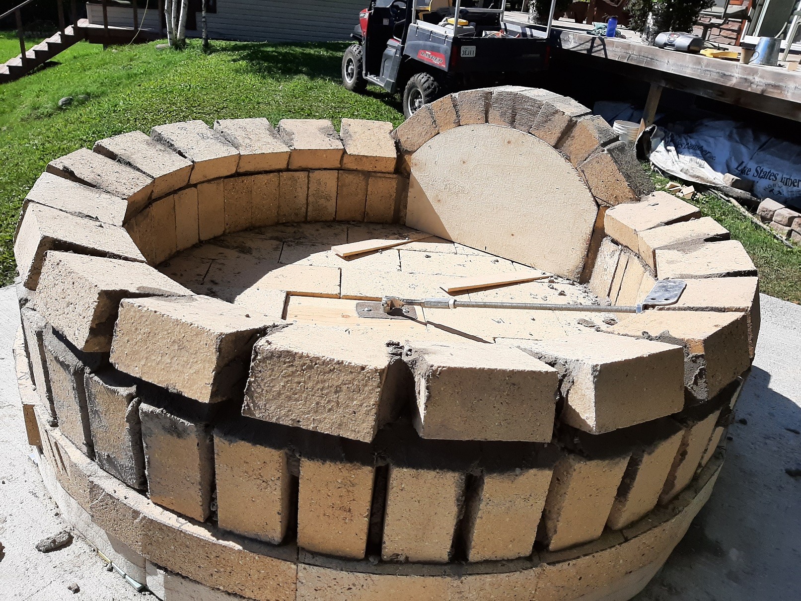

    Made more progress this week. A bit of head scratching as I learn but coming along ok. I know mortar joints are supposed to be as thin as possible or around 1/8" but when I looked at many photos on line, the outer gap seems much larger. Does the 1/8" refer to the inside width? I did cut the second course bricks a bit to reduce the exterior gap a bit. I think the 3rd course will require both more cuts and side tapers. Going to work on an adapter or table sled to do that. Cutting the angles was not easy with my saw, despite being a 10" saw. Fun project so far.
    I am a little worried about getting the opening form out. I put wedges under it to give me some vertical clearance but did not allow for side clearance. And I stapled it together. Should have screwed it. I will leave it till I have a few courses about it or I have to move it. I have an oscillating saw and I think that might be the ticket to getting it out.
    Any input thus far would be appreciated.

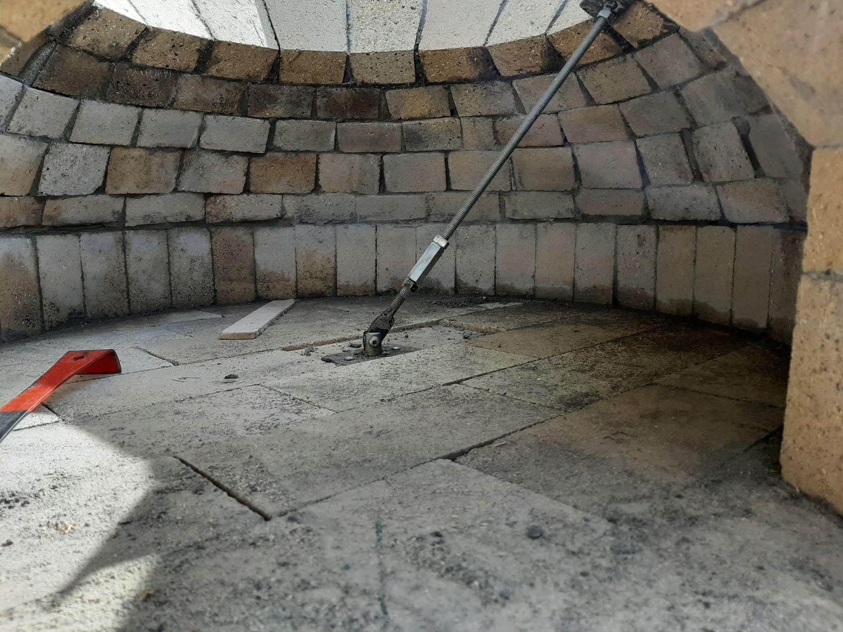

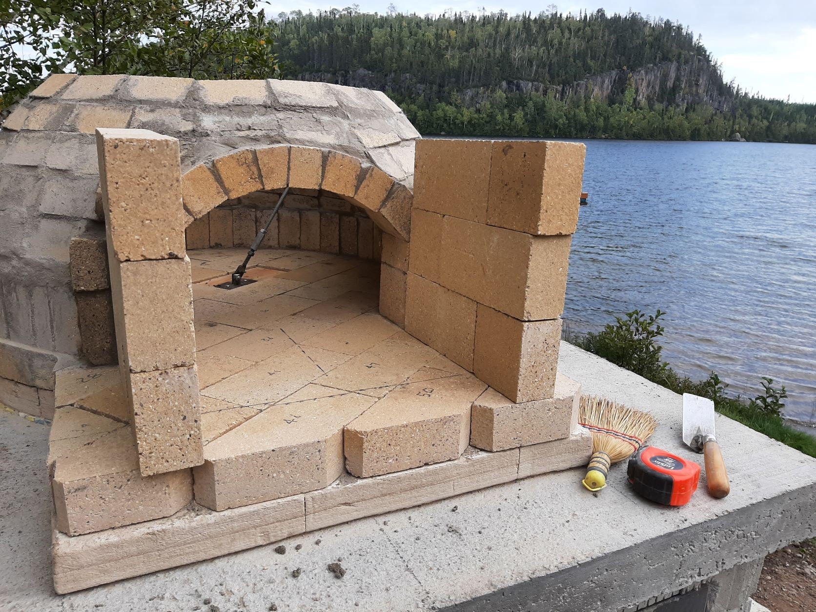

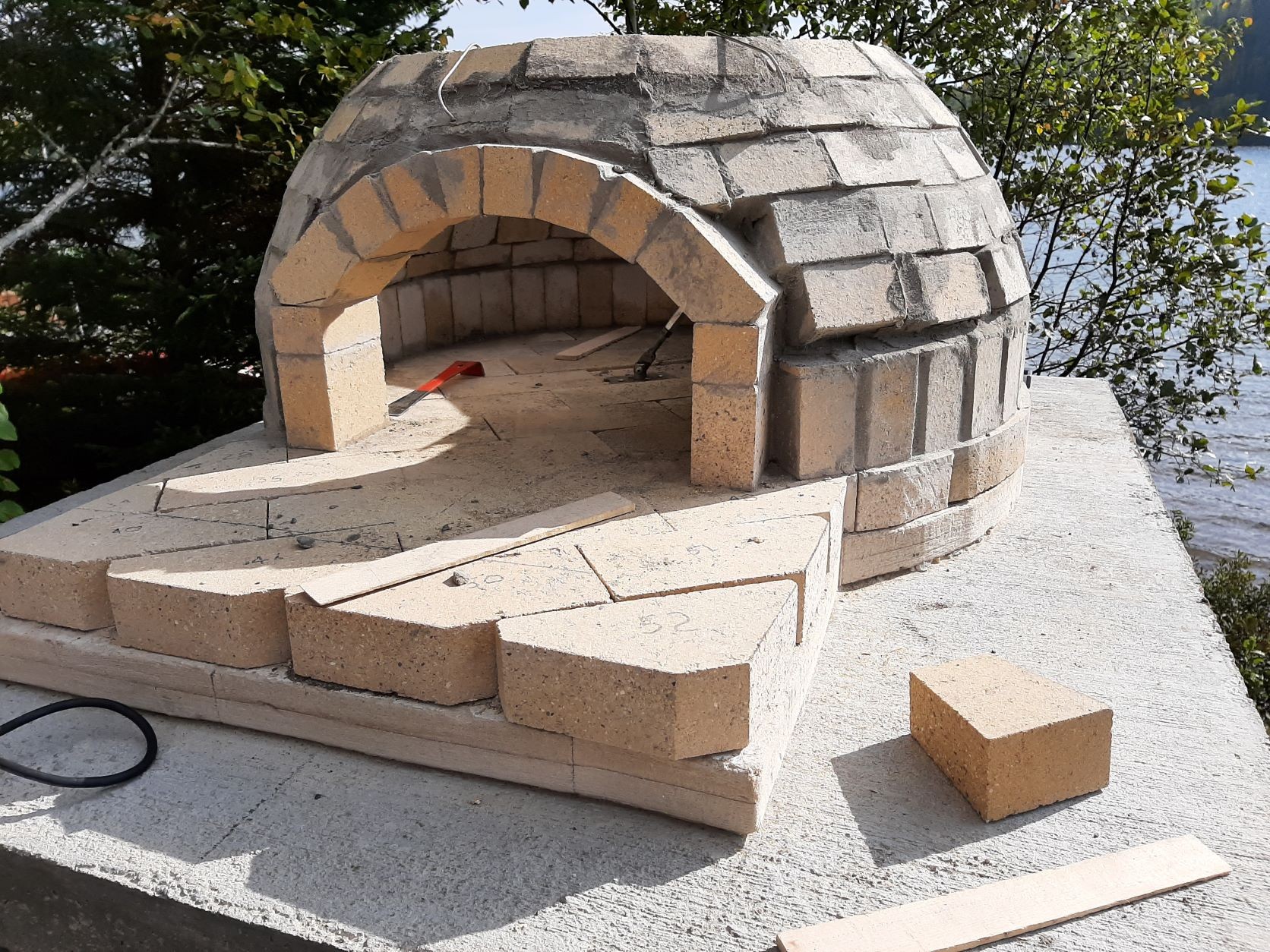

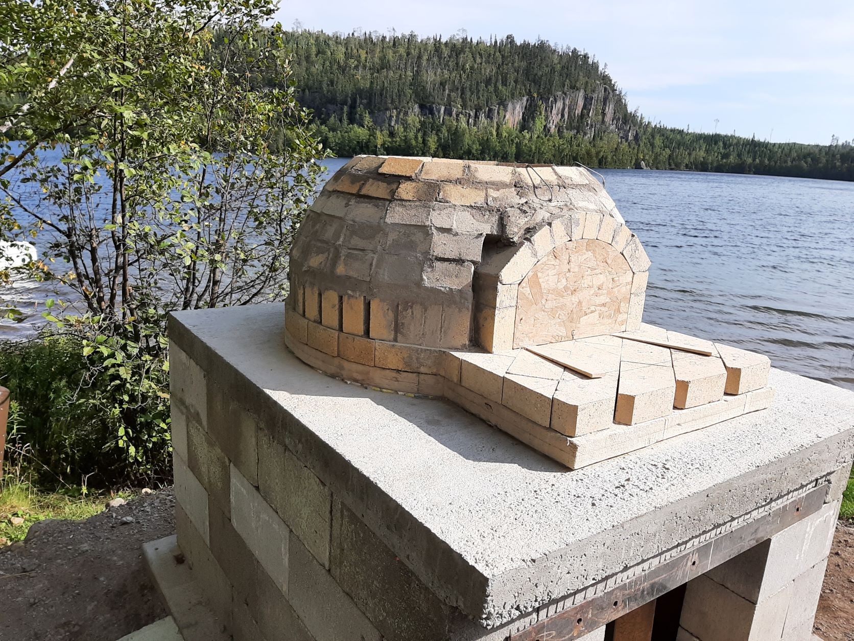

                            A little more progress. Some joints good, some, not so much. Starting to look like a pizza oven though....
                            Today, I stopped adding courses and spent some time in the dome while the top is open enough to work in. I definitely won't be crawling in through the opening like some photos I have seen. I mortared in pieces of brick around the inside of the opening, maybe adding strength, improving air (smoke) flow, and for piece of mind. I can see where building 2 of these things would be good. You learn a lot by doing. I also did the same small brick inserts around the outside of the opening and started looking at how the vent landing will be. I figured a brick and a half long but now thinking maybe just a brick length for the landing. I think the actual vent will be a half brick wide by the opening width, around 16 inches.
                            Any input appreciated.
                            Thanks
                            Shawn
                            My build

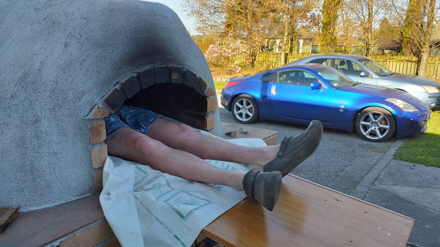

                            • MarkJerling
                              • Oct 2020
                              • 813
                              #29
                              Crawling in like this? LOL
                              Click image for larger version  Name:	241219002_10225589518675575_7388133370469196875_n.jpg Views:	0 Size:	290.2 KB ID:	441788
                              I sent my son. He's thinner than me!
                              • Shawnr
                                • Jul 2020
                                • 55
                                #30
                                lol...I think that is the photo I was thinking of. I am not a large person but at a 16" x 10" opening, even I would be struggling.
