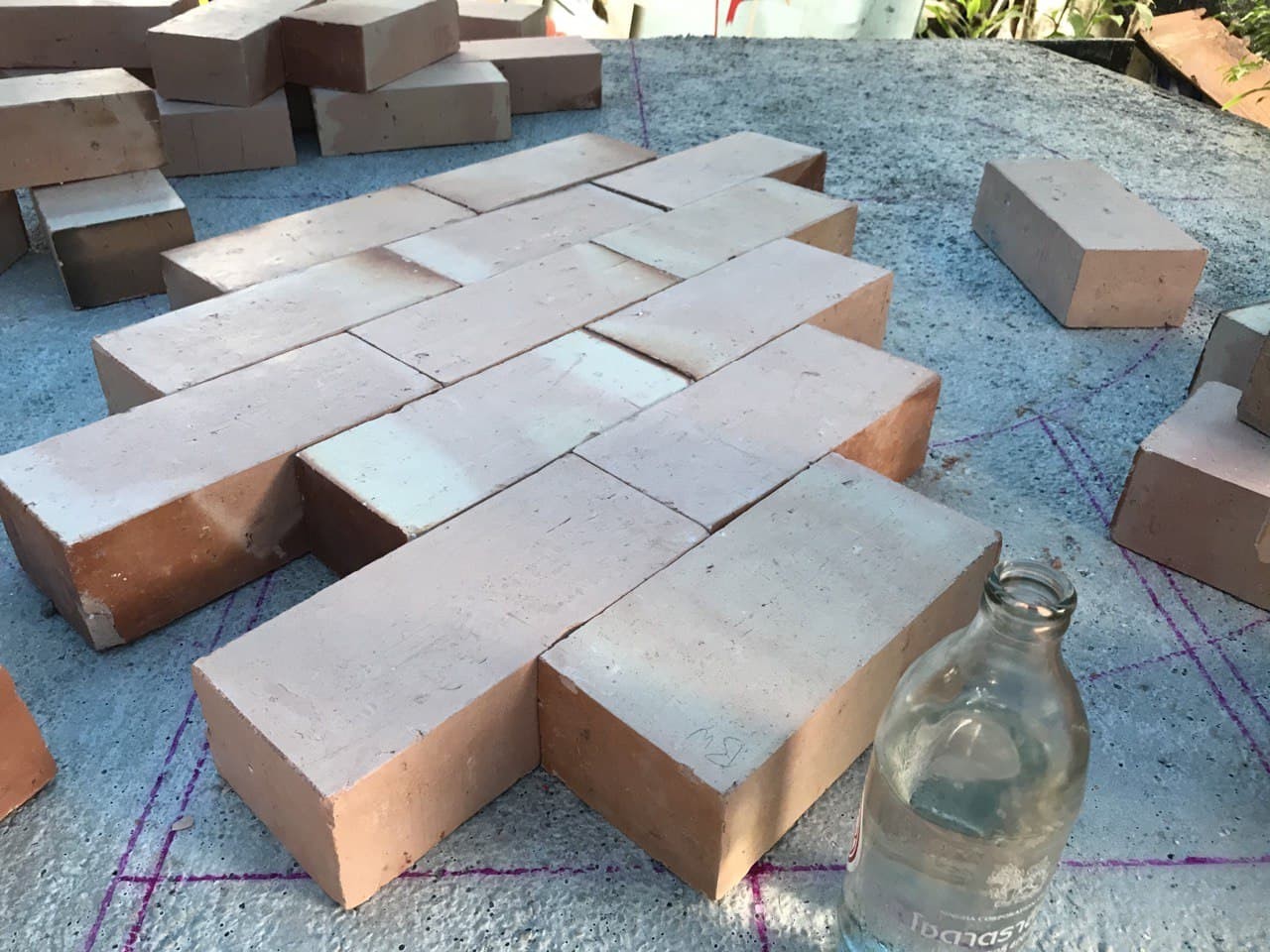

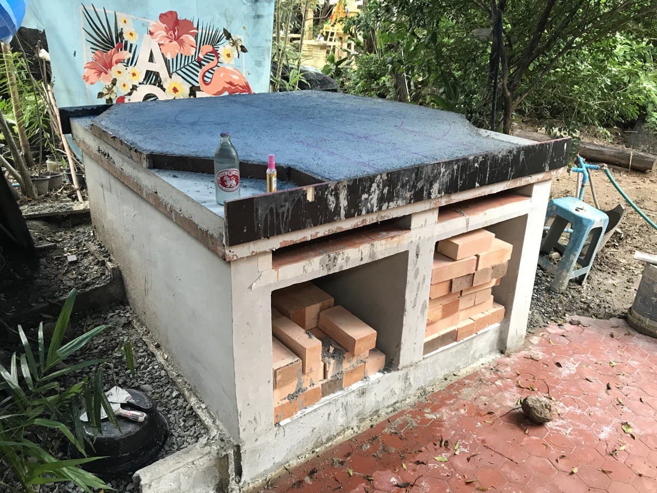

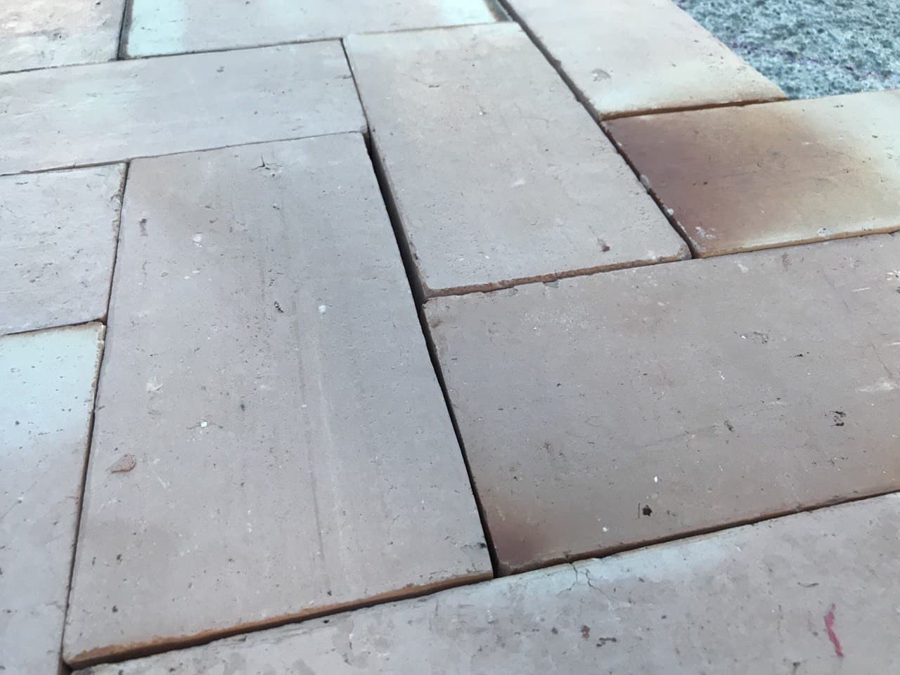

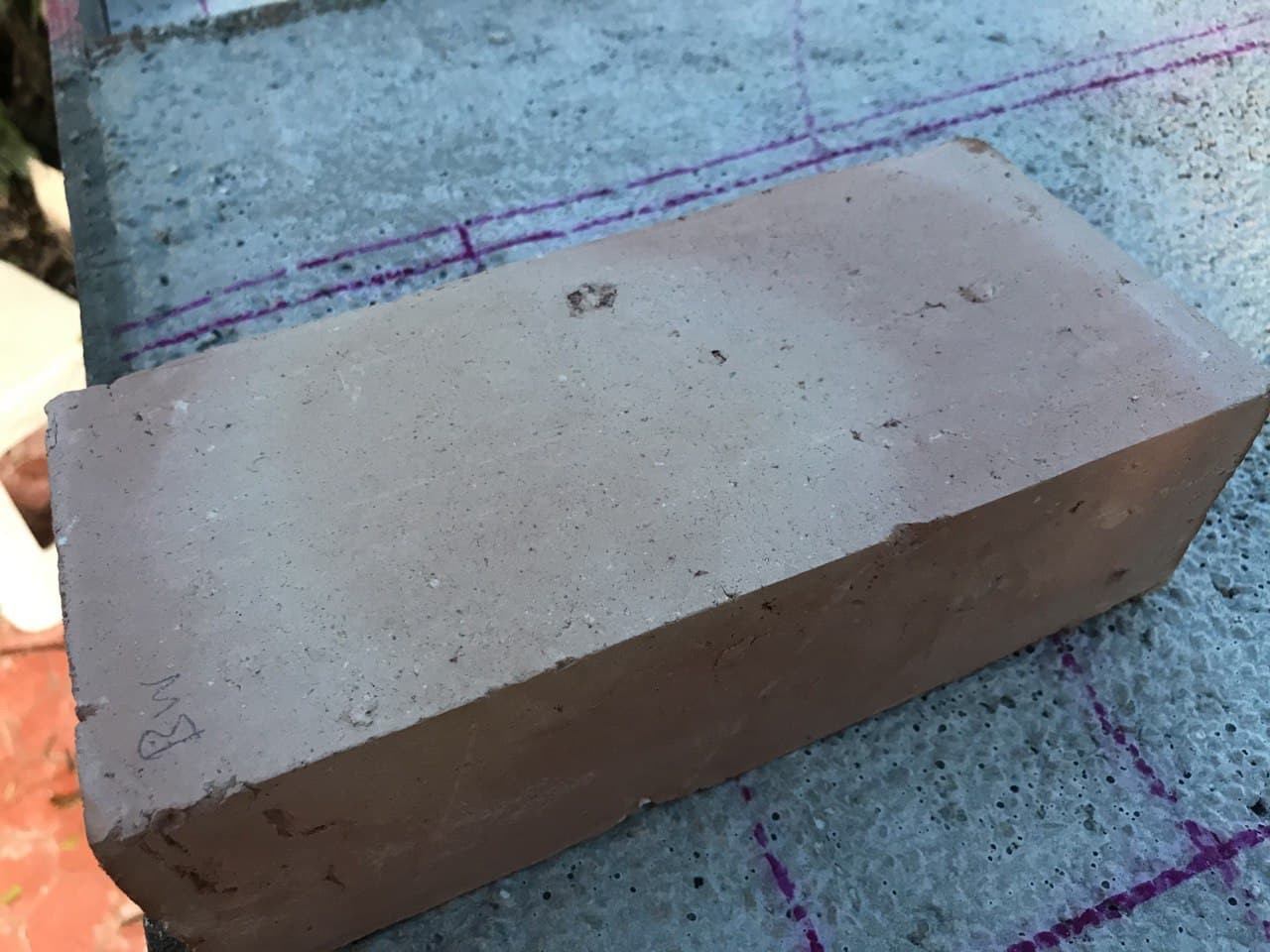

    So a few weeks ago I began my build, and I have just completed the base and poured a perlite layer on top. Due to the current situation, I had quite limited success in finding "proper" firebricks in the area. I did however find some firebricks (quite cheap as well,6 baht per brick ~ 0.2 usd), but they are not of very good quality I think.. It seems like they crushed some old chimney and made new bricks of it, they are very inconsistent and some have bits of what looks like iron/rust in them
    Today I sorted out the best bricks of the lot and tried to arrange the bricks on top of the perlite base.
    Now I have a few questions if I may
    1. Will these bricks be good enough for building the oven?

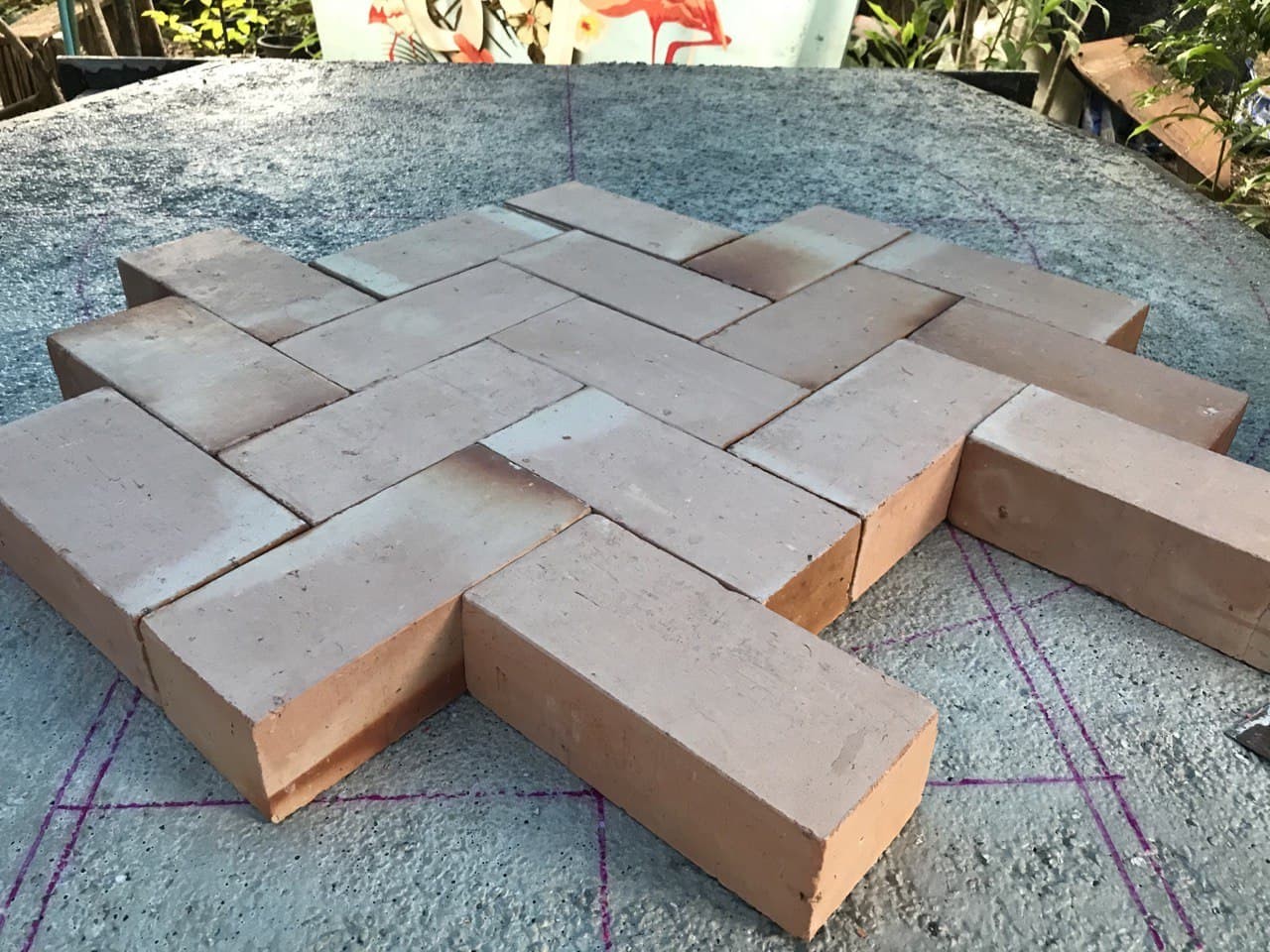

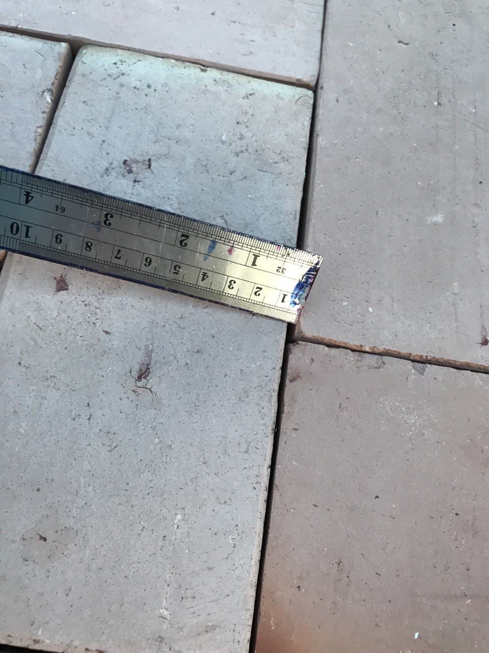

    2. They bricks seem to vary slightly, so it's impossible to make them to perfectly align against each and there is some places where gaps are up to 3-4mm
    3. Initially I tried the herringbone layout, but the gaps gets worse than if I just lay them in a sideways pattern (for lack of a better word!) - will the sideways pattern be good enough?`(cons vs herring?)
    4. Can you add fireclay mortar in places where the gaps are to wide?
    5. The perlite base is not 100% even so I will need some fireclay mortar underneath the bricks, is this ok? (I saw somewhere that you shouldn't for the expansion?)
    A huge thanks in advance, I will spending my arvo browsing this forum for inspiration!

    You are well on your way. I suggest you download the free eplans from the Forno Bravo store website. It is a good baseline for building ovens. Don't believe everything you see on YouTube as being the best practice. There are some really bad ones out there and some decent ones as well. Do not fall for the p.vcrete domes over a yoga ball. They are not in your best interest.
    Bricks appear to be okay, I would just play around with them, switch locations, turn over, turn around etc. For level on pcrete, use a wet slurry mix of 50% sand and 50% fire "clay" (not mortar) laid down with a 1/2" notched trowel.
    Do not mortar in floor, it needs to float for expansion and contraction. Ash will fill in the gaps, any high points that will catch a peel can be knocked off with a angle grinder with a diamond cup.
    "Important" - the floor insulation is on the thin side, you do not say what ratio you used. A min of 2" of CaSi board is recommended and a typical 5 to 1 p/vcrete requires to be at least 4" thick to be equivalent. Click image for larger version

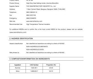

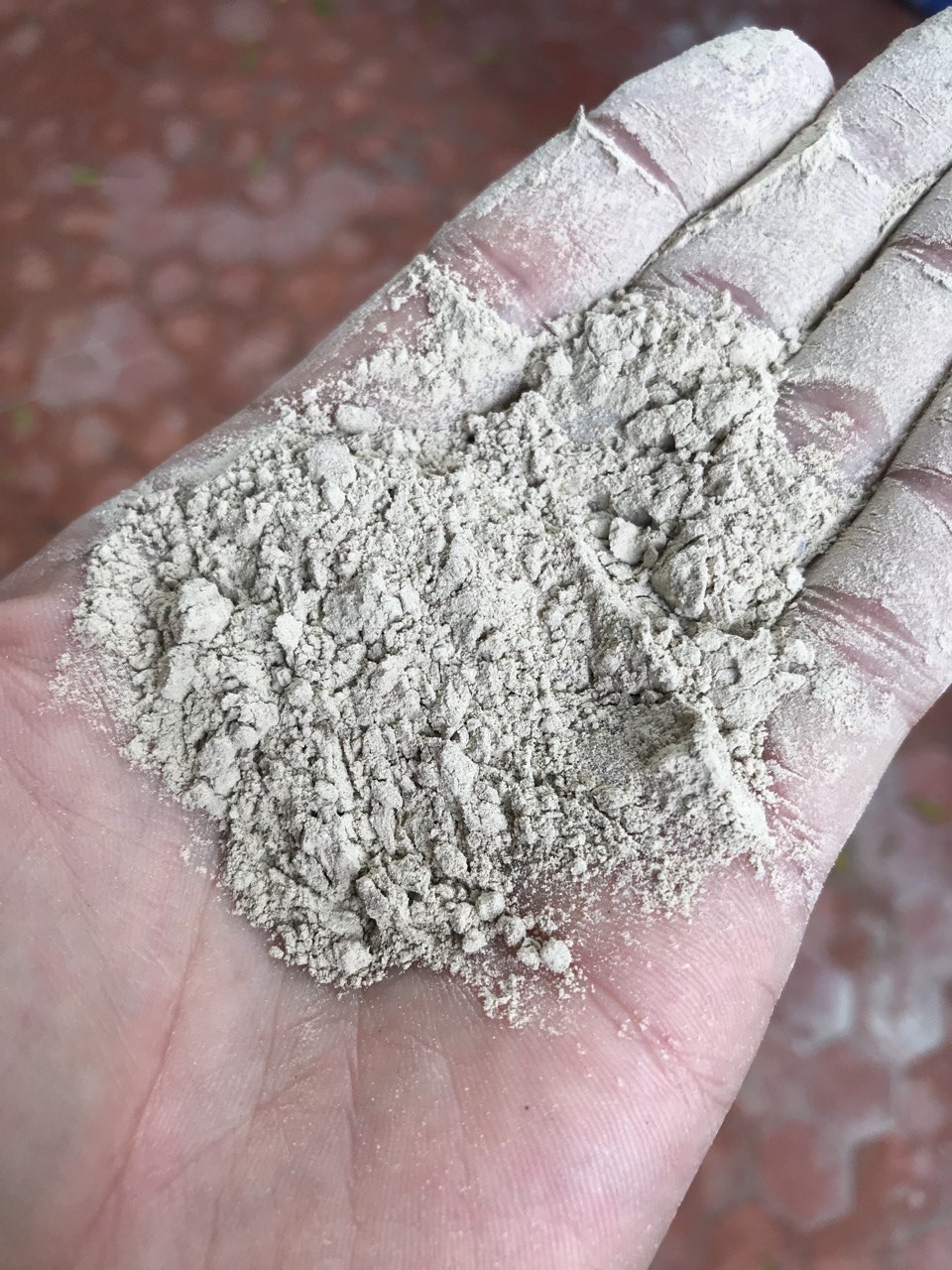

      Sorry for the confusion, so I shouldn't use any mortar for the floor due to the expansion/contraction - gotcha, but what do you mean with the 50% fire clay and sand mix? Will that not set the bricks like mortar? I'm not sure if I have fireclay or fireclay mortar, the only thing i could get hold of here is SK30HM - is this fireclay, or is this something different? (see attachments)

        Fire clay is powdered clay only. I can be found at brickie or pottery supply stores. The clay/sand mix does not set like a mortar, the clay just binds the sand enough so it will not free flow away. I would search some more for adding a layer of CaSi or AlSi board on top of pcrete. Now is the the time to do this, once to bricks are laid you cannot go back.

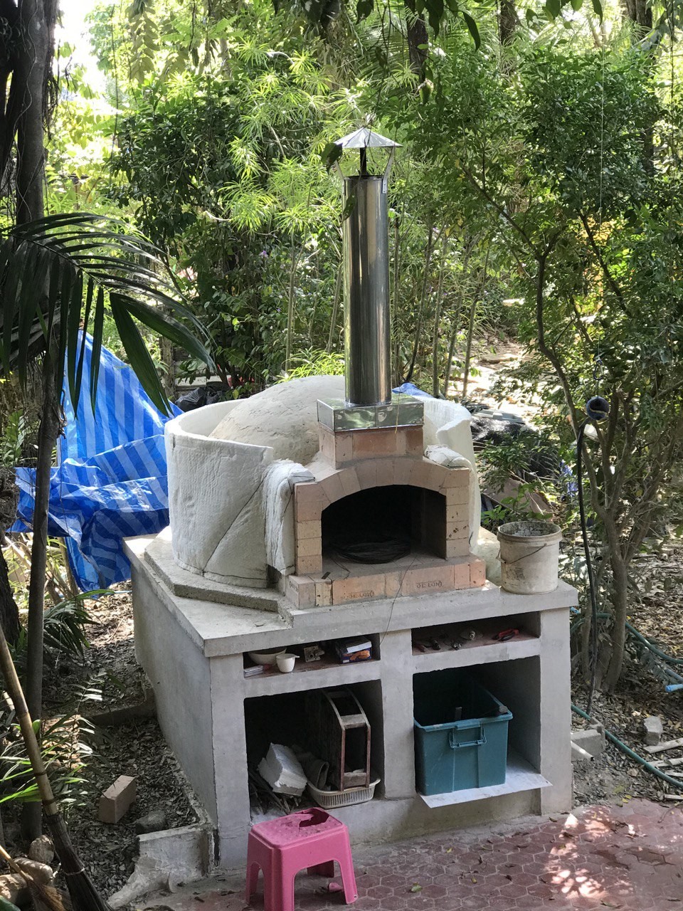

                  Latest update Taking way longer than I originally thought, lol

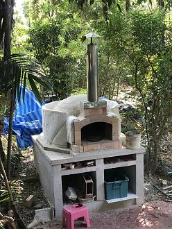

                          The other day I received a custom-made double barrel isolated stainless steel chimney, really happy with it! I good a great deal too, only 4000 baht for the lot (thailand) which is about 120 USD. I've made curing fires every day since, and today I'm starting the isolation job. Still need to figure out a good ratio mix for the perlite which I will cover the ceramic fiber with..
