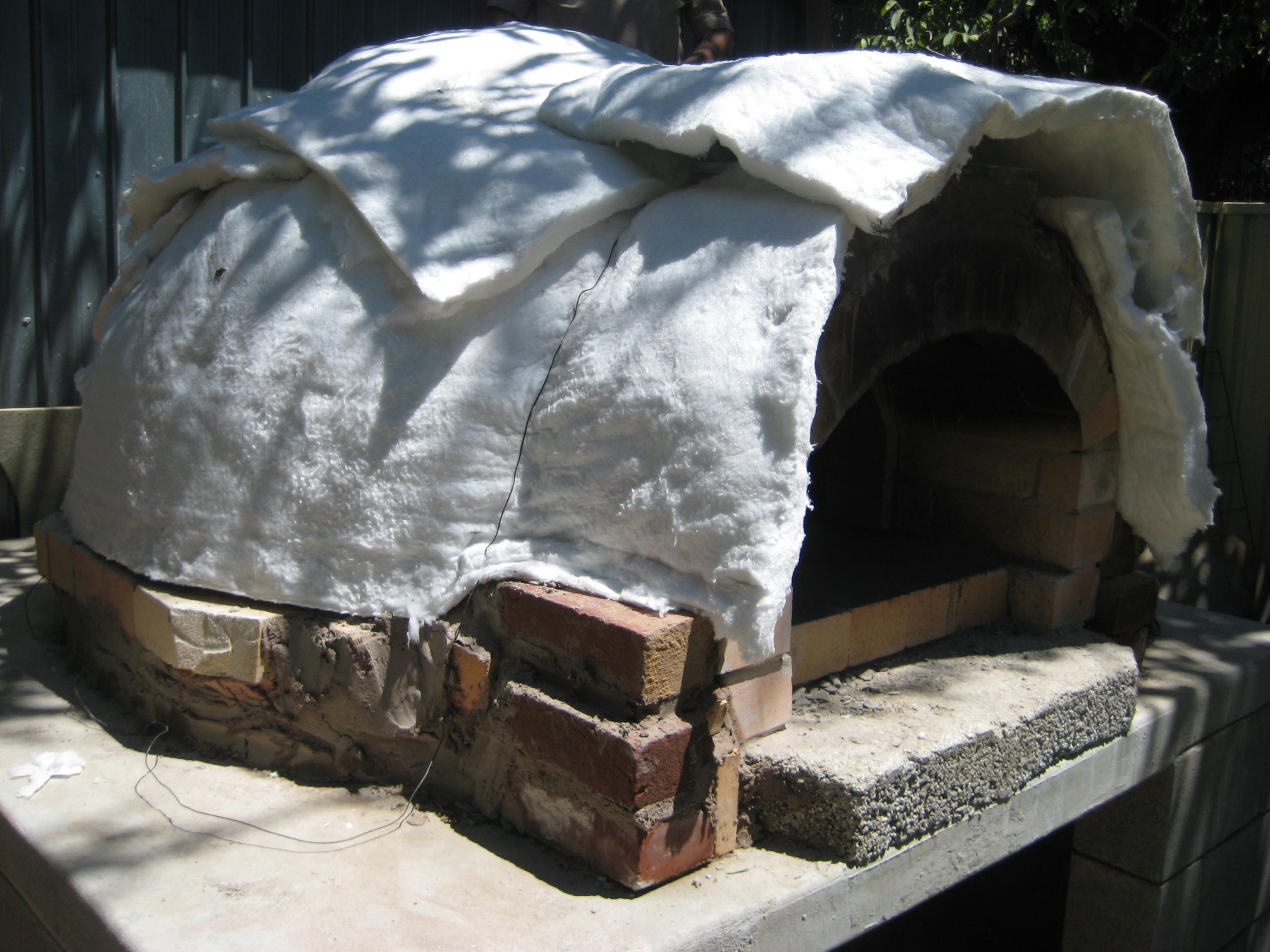

          I cant wait to do pizzas again but I may have to wait a bit as I am planning to properly insulate the dome with ceramic blanket and vermiculite.

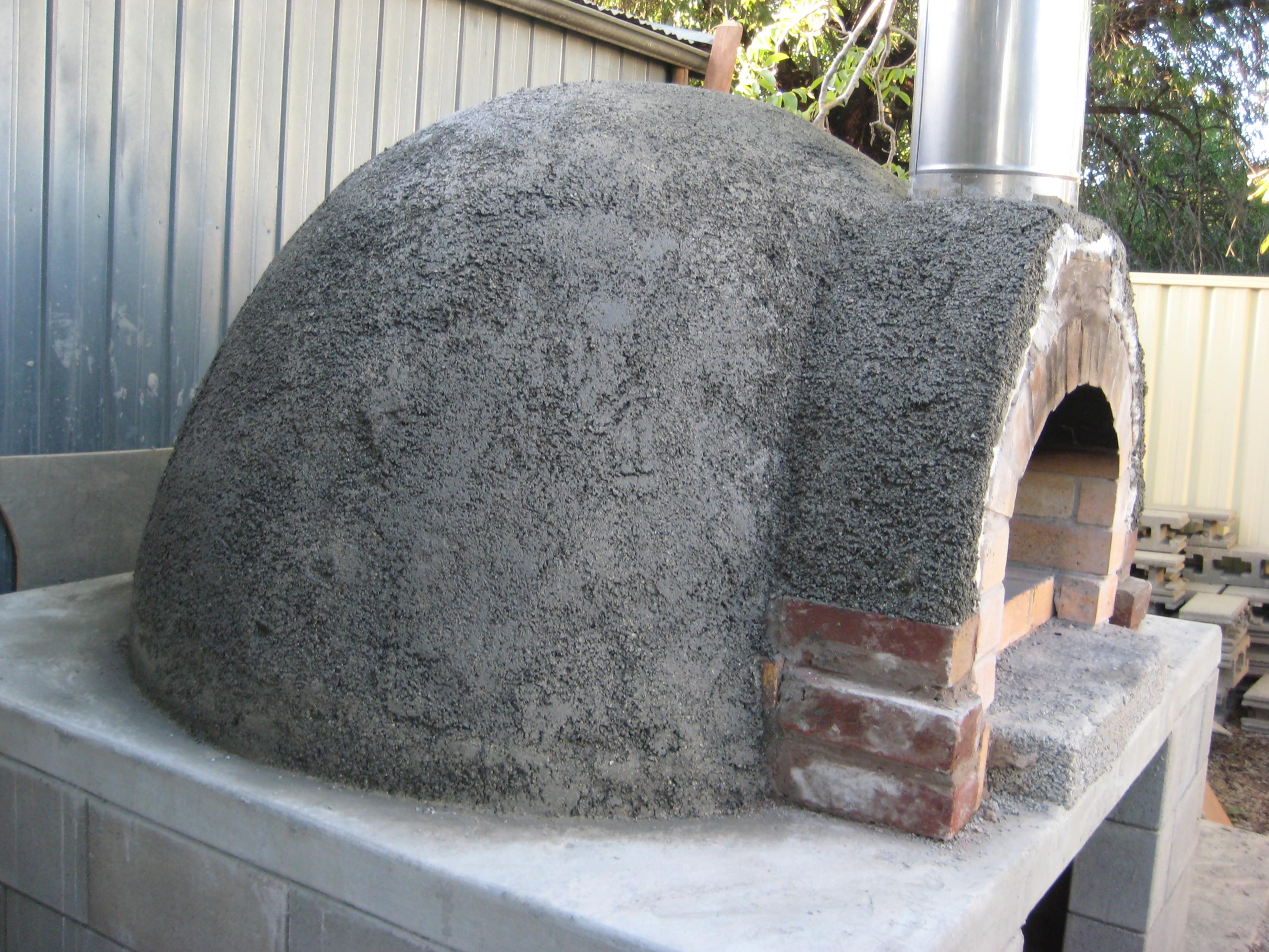

                  Thr first thing was to sort out what to do with the two cracks. After reading up quite a number of threads I decided to patch up the cracks on the outside with high temp mortar and then give the whole dome a thin render (about half an inch maybe) with the home brew mortar. I then put on the ceramic blanket
                  I then put on 4 inches of vermiculite over the top. Boy that was a challenge - We tried the method of stacking from the bottom of the dome but it was just taking too long. In the end it was a two man job where we started from the top - one holding a shovel full of the vermiculite mix and the other scooping and trowelling it on. We seemed to go a lot quicker this way and it worked out okay.
