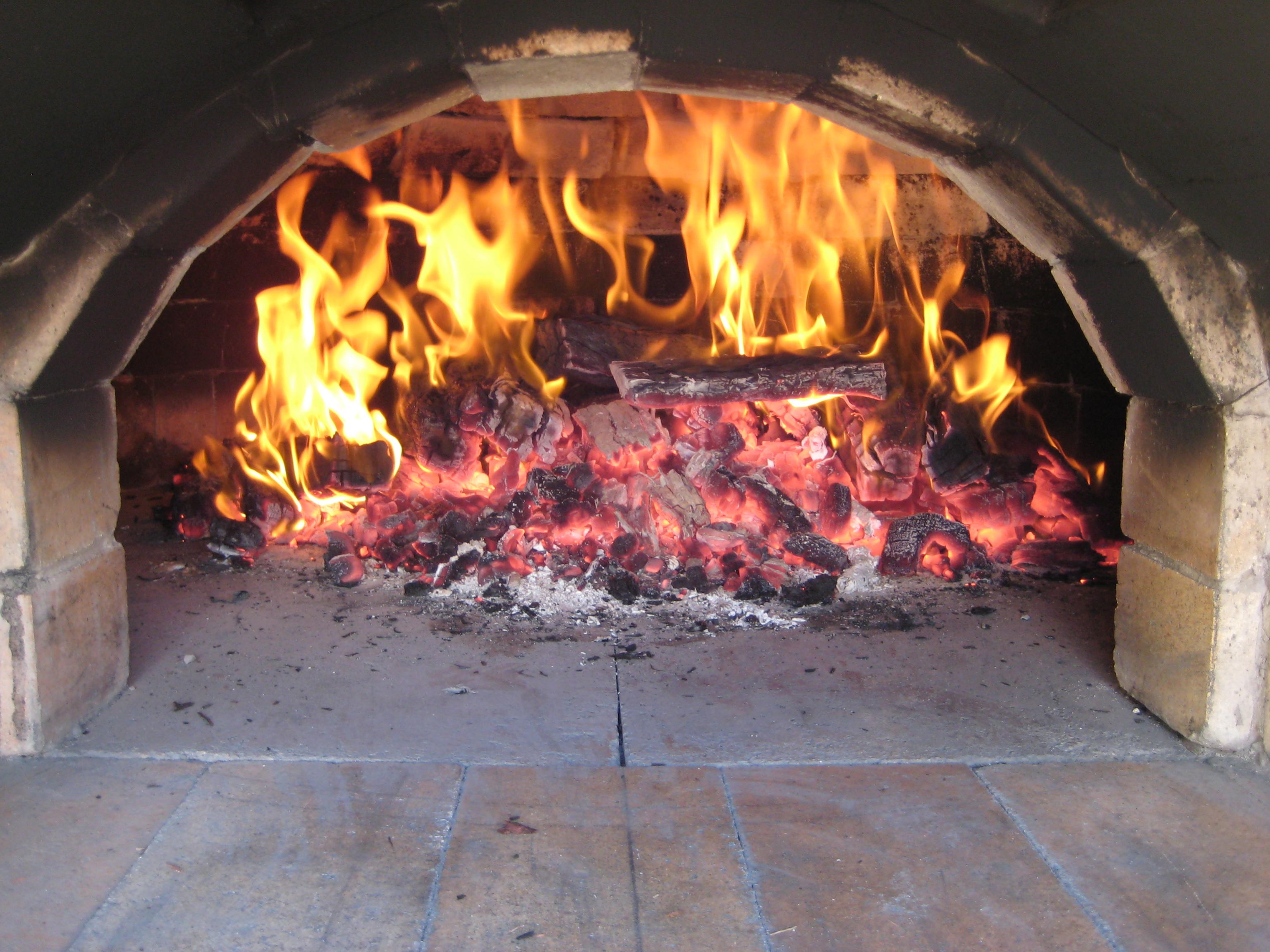

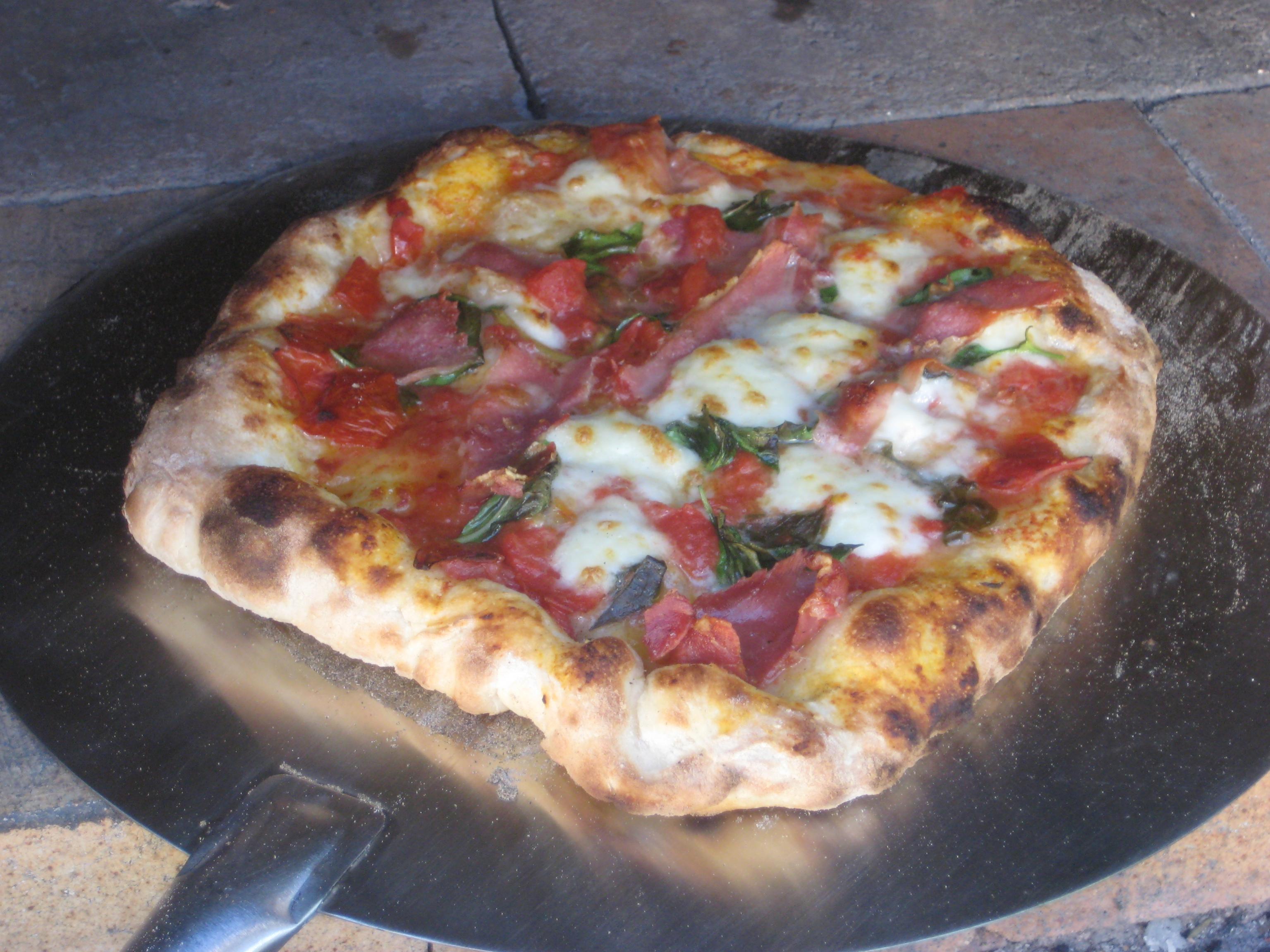

                        I finally managed to get some decent browning on the bottom of my pizzas. I realised that I really wasn't getting a big enough fire going. So this time I burnt longer and bigger
                        I also added smaller pieces of wood more regularly to the fire once I had raked it to the side to keep a bigger flame going than I had previously.
                        This worked great and the six pizzas we did all came out well cooked underneath. I am not too sure if I could have browned then a litle more - this is generally how they came out

                          Looks great to me! I'm hungry!

                            Those are very mouth watering pizzas. They look delicious!

                              The pizzas look perfect to me. Nice work!

                                The bottom of the pizza looks perfect, you nailed it!
