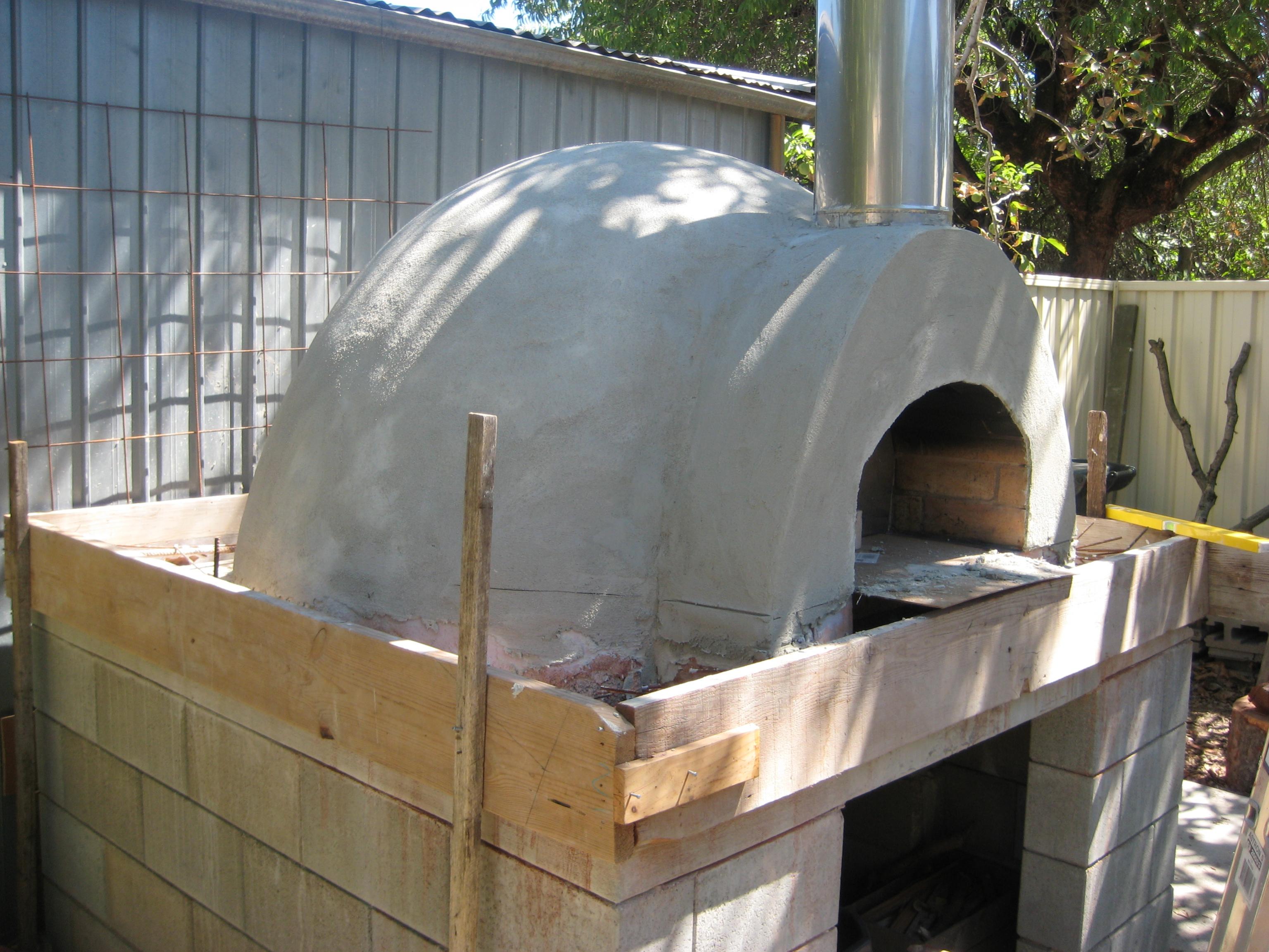

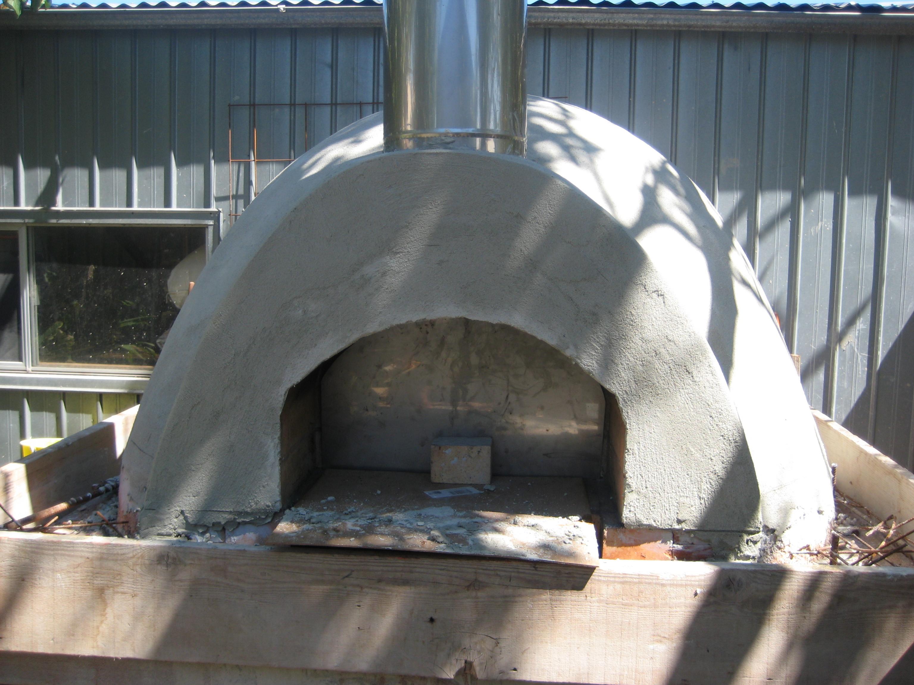

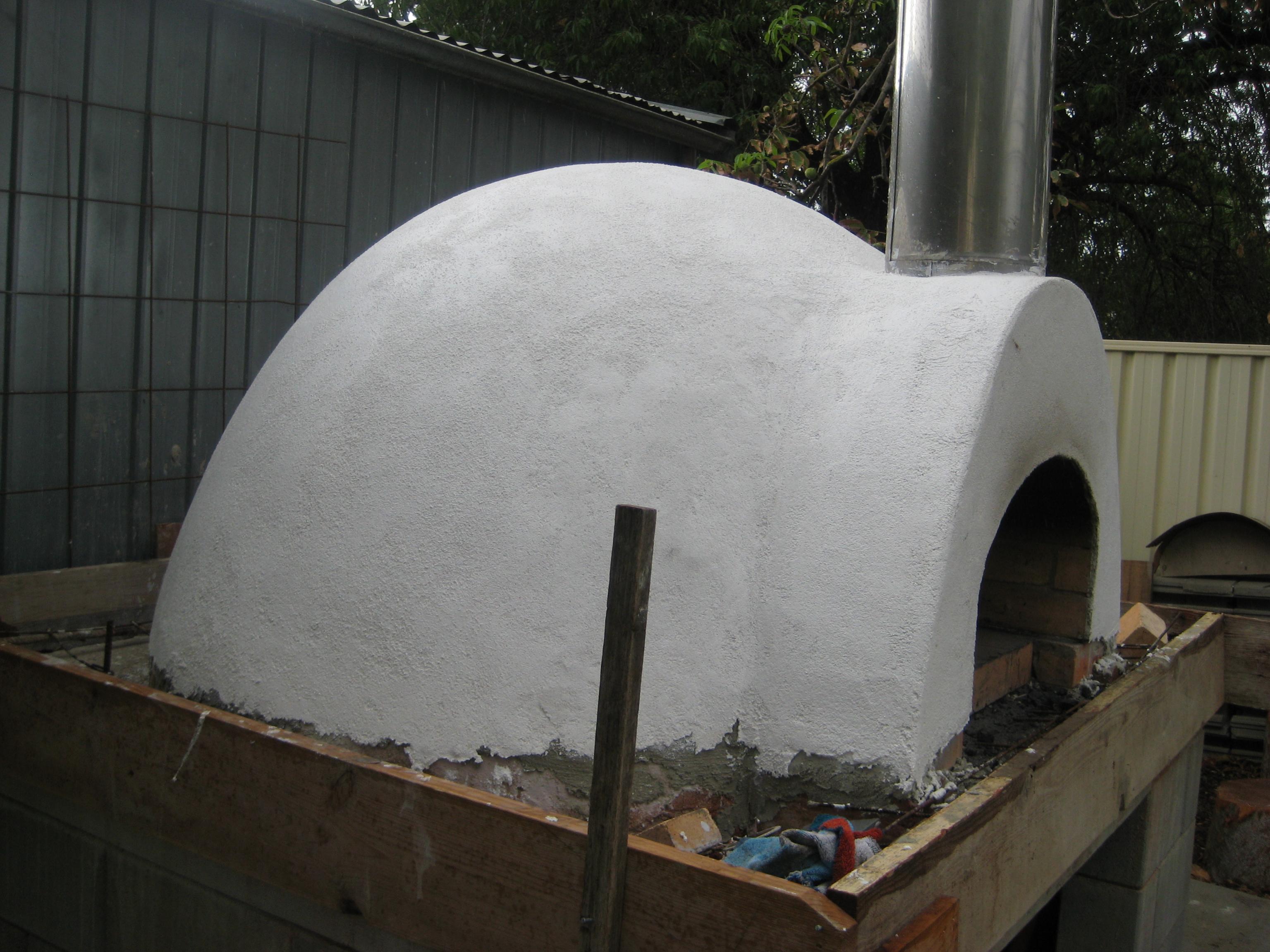

          I finally got some work done on finishing the oven on the weekend. Managed to get a polymer enhanced reder onto the dome. I used a product I mentioned earlier called pro render. It was really good to work with and it dried really hard. Heres a pic

          I also got around to organsing a stainless steel door - but haven't yet sorted out the handle! Any suggestions would be welcome. You can see my present system for the door with firebrick in the photo below.

          • Tim F
            • Jul 2008
            • 163
            #65
            Re: Salv's WFO Build
            Hey Salv, love the render. I have to get on to that myself soon.
            The bread looks delicious to me, looks like the crust is pretty brown although is it hidden under the flour a bit on top? One thing that can help with crust browning is a longer fermentation, which breaks out more sugars and gives you that really reddish golden brown colour (as well as better flavour). How long did you let that one rise?

              #66
              Looks great, Salv. Love the big air pockets in the bread. I can almost taste it! Have you decided what to do about the granite?

                Tim - looking forward to seeing the progress on your finish.
                Thanks for the comments on the bread. You are right there was a lot of execess flour on top - need to be more careful next time. This bread included a bulk fermentation of about 2 hrs and then a proof of about an hour and a half before baking. I was a little rushed and disorganised as a I baked the bread after having a small pizza party. I was thinkng of maybe doing the bulk fermantation overnight as I do with my Pizza dough. Does this make sense?
                Carlos - I think I wil linclude the granite in the front of my landing bricks and then use dark grey tiles for the rest of the floor. As you can see from the picture I have the forms in ready to level up the floor. By the way thanks for the earlier advice on the granite - I tried some drops of water on it and it didn't seem to absorb it.

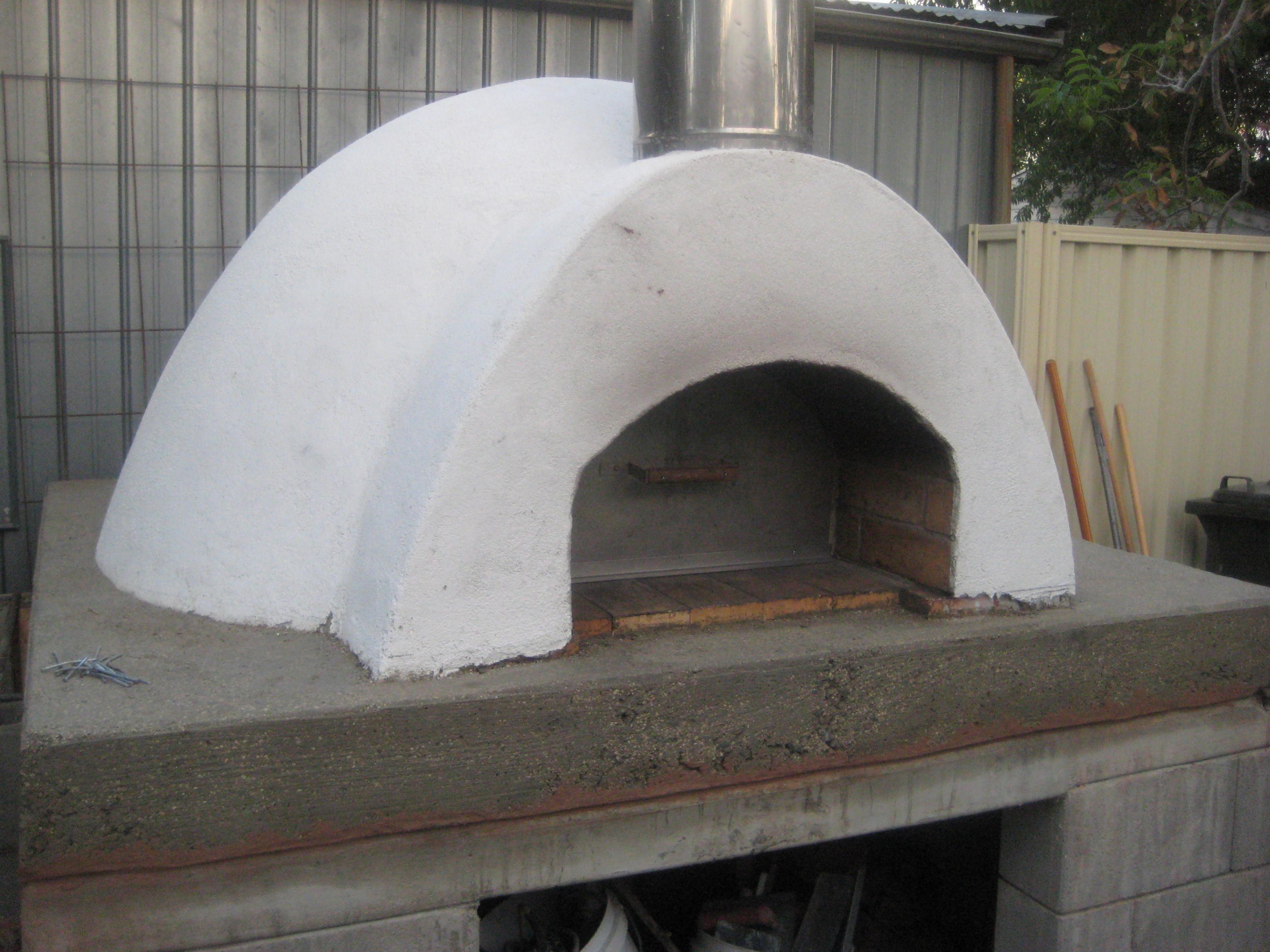

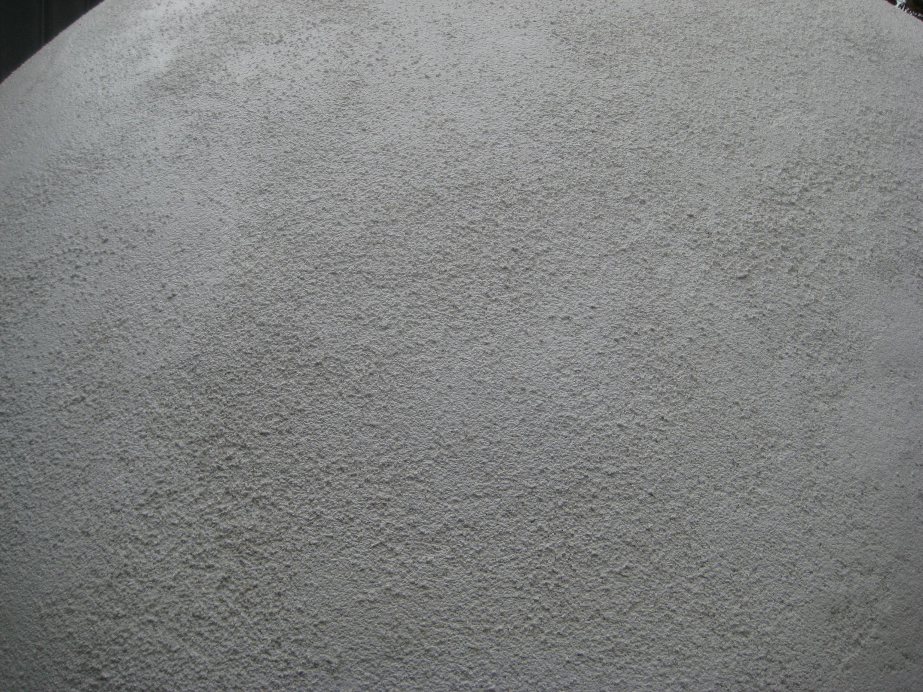

                  A quick update on the snail pace effort to finish my oven. Put on the final texture coat on the dome. I ended up using Marblecote, which, as the name implies, has marble grains in the mix. It came out ok - I don't think we applied it very evenly and ended up using much more than the theoretical coverage on the spec sheets. It is meant to provide a strong water resistant finish and, amazingly, it rained in Adelaide a few days after I applied it! It seemd to work. Here are some pics

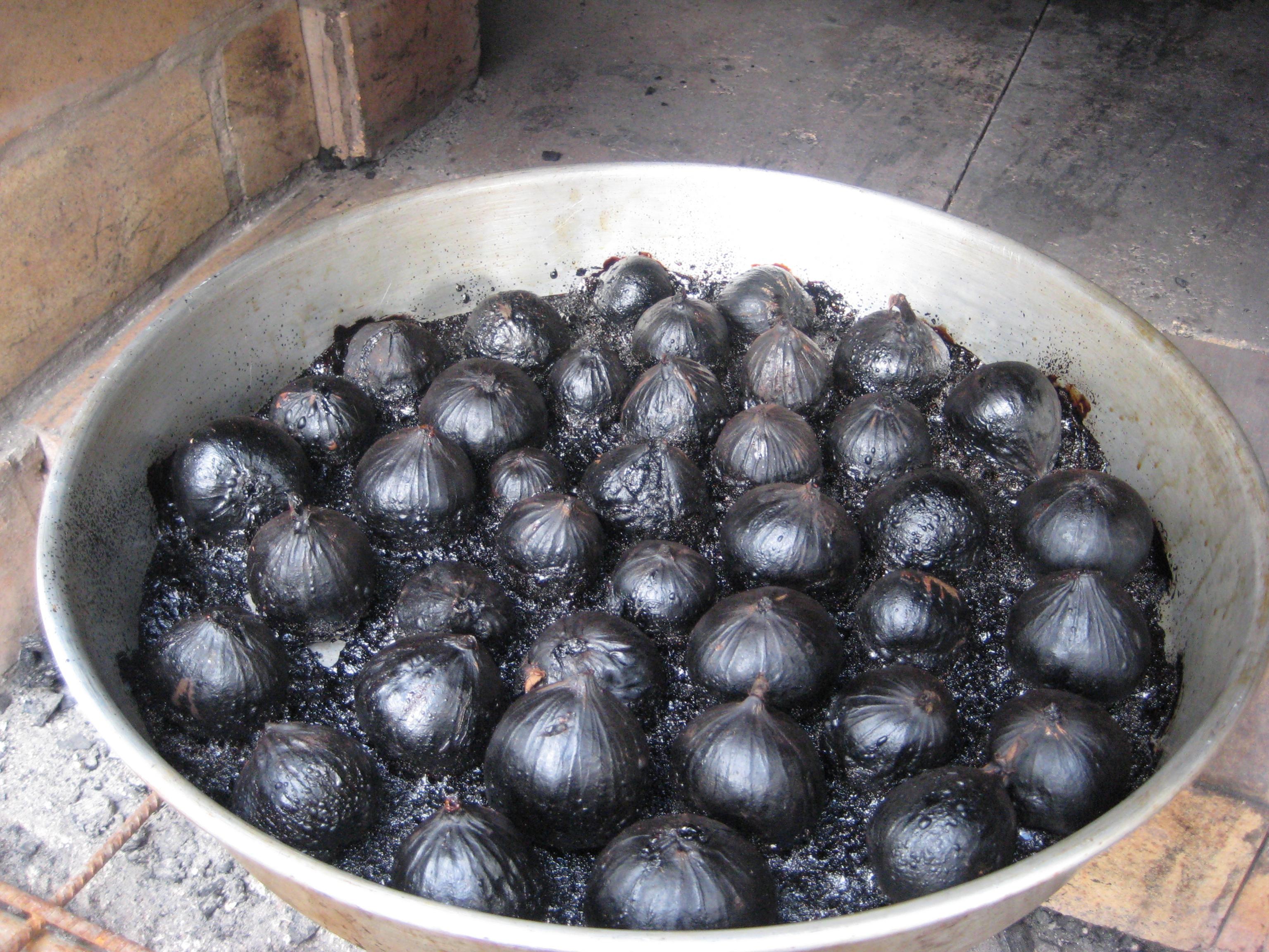

                  On a funnier note - I put some figs in the oven at the end of a night of cooking and forgot all about them. The result was the following
                  They are perfectly charred - could be a piece of modern art almost

                    Those figs do look very pretty . You could imagine they're out of cast iron or something.

                      spot on Frances - the figs do look like cast iron! Like some sort of paper weight.

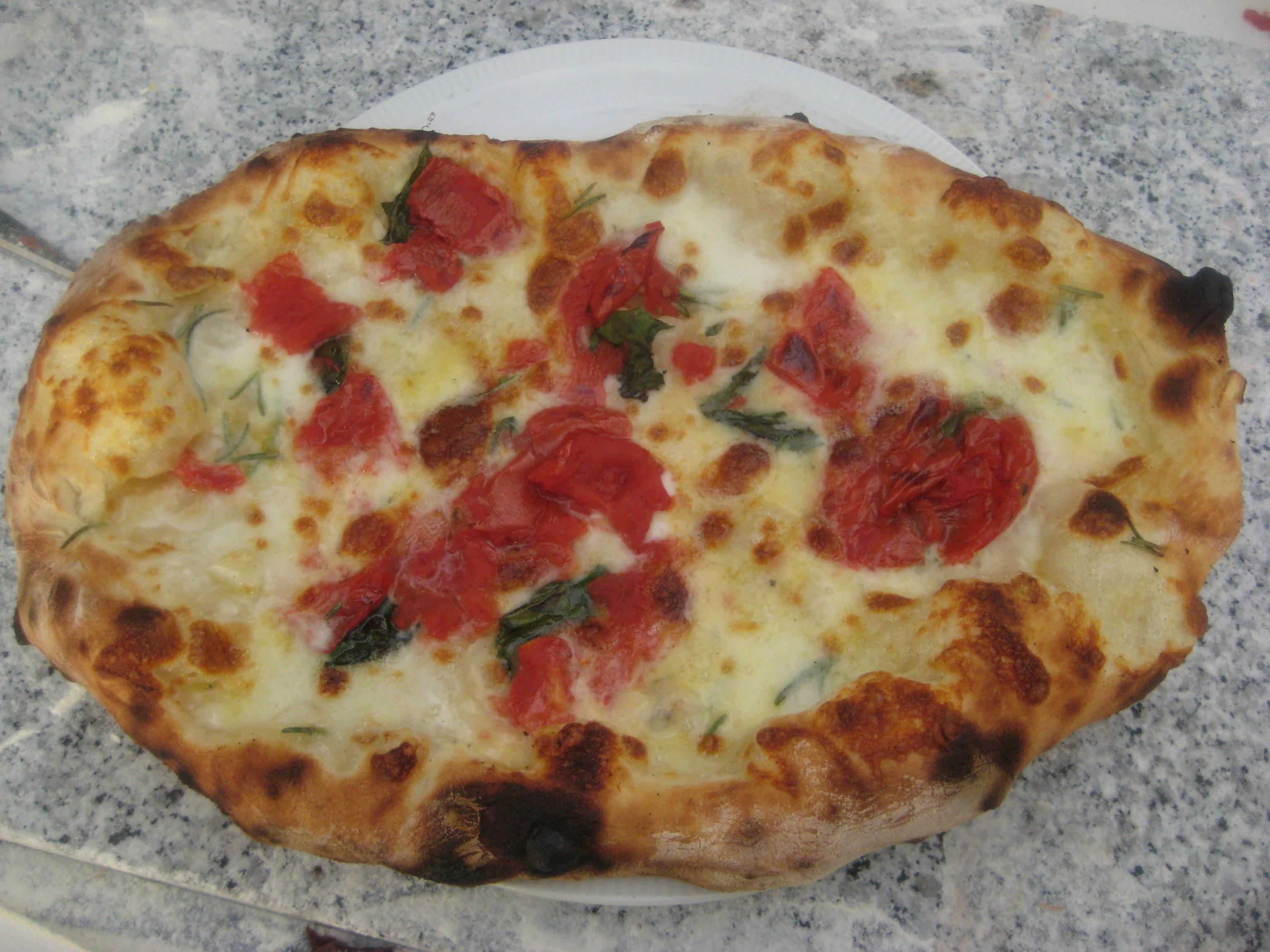

                        I've been using the oven every weekend and my favourite pizza at the moment is one with a little tomato, fresh mozzarella, reguar mozzarella and a bit of rosemary and basil. Heres a pic.
