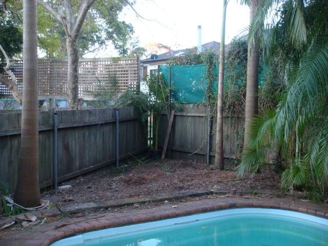

    After several years of pondering & wishing for a pizza oven I have now started on my own build. Actually, one of the reasons that it has taken me so long is that I didn't like any of the manufactured ovens on the market, They were all too small and too expensive. Once I stumbled on the Forno Bravo site I found a good oven that I could imagine in my back yard.
    Above is the corner of the back yard before I took the axe to it. I would have like the oven closer to the house but I had to accept the planning approvals from the BOSS.

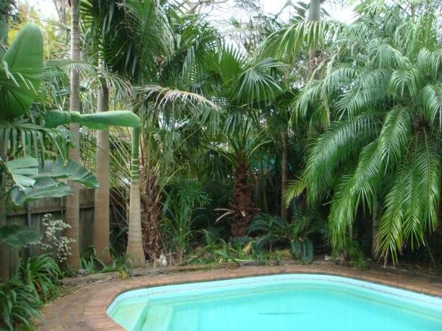

    Clearing the jungle took a weekend and I am forever amazed as to why palms in Australia always seem to come with long sharp spines and/or thorns. All of the jungle was taken to some friends who have 2 goats. They just love any new vegetation and they don't care and complain about thorns! The WFO will sit in the corner of the yard and I will also install decking around the oven and new edging around the pool (this was a requirement of the planning approval)

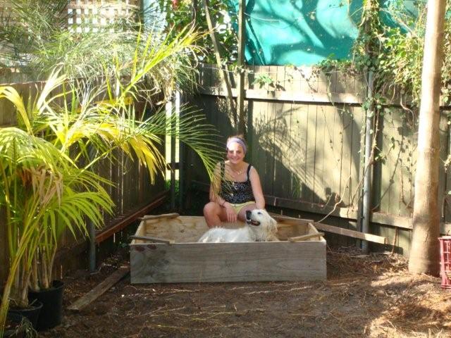

    This weekend I finished the form for the base slab and I ran a conduit and cable from the house for lighting around the oven and decking.
    That's it of the weekend and next weekend I will be pouring the slab.

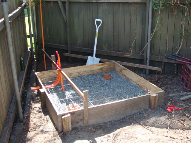

      During the week I dug a trench across the back yard to take power to the WFO (to add lighting around the decking & for the WFO)
Name:	Base Slab Ready to pour.JPG
      Ready to pour.
      My 16yr old son, Tim helped mix & pour the concrete. The last concreting job he helped me with we mixed by hand. He is impressed with the technology of a cement mixer!

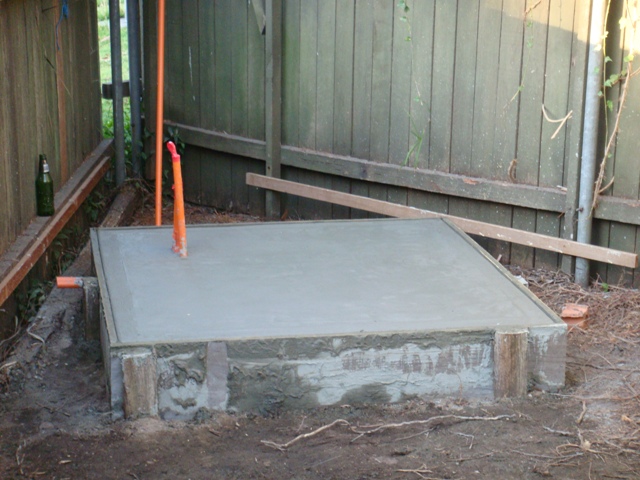

      The completed slab.

            I am interested in what the size of slab you have there. I only looks to be about 1200 x 1200, what size oven do you plan to build?

                Rodney, you were very close. The slab is 1300 x 1300 and I am planning to build a 1000mm internal WFO. I didn't want the supporting structure to dominate the oven so the harth slab will be hexagonal and overhang the base. If i can figure how to convert a Google sketch dwg into a jpg file I will post a picture.

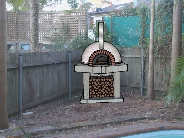

                    I figured how to convert a Google Sketch drawing into a jpg file so here are the details of the intended design.
                    I didn't draw the WFO (it was one of the free 3D models available for download) but it will be similar to the style that I want. I mainly used it to determine how it would look on the base & slab.
Name:	Pizza Oven Design.jpg
                    I have gone for the hexagonal base to allow the oven to fit easier into the corner of the yard and to have the smallest hearth slab that I could get away with.

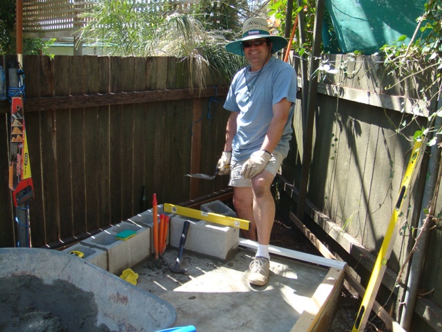

                        I managed to get off work early this afternoon and lay another course of concrete blocks.
                        Below is a pic from last weekend when the first course was going down.
Name:	Laying Blocks.JPG
                        I have a new respect for brickies! Thay make laying brincks look easy the way they slap the mud quickly on a brick/block, give it a gentle tap with the end of the trowel and it is all straight & level.
                        But I am getting faster so there is some hope for me yet.
