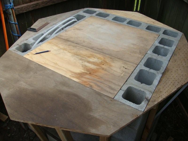

If you are not confident to lay blocks, use a mortar bed to position and level the first row then use a masonary contact adhesive (Liquid nails for mortar in Australia) to join the rest. Fill some of the cores with concrete and rebar and render over.

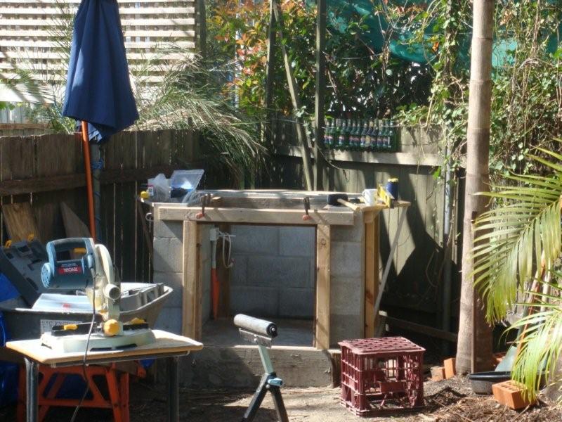

If you are referring to Field furnace insulation bricks, they have worked well for me now they are dry, but on the first and second firings the heat did transfer through to my slab and it got up to 70C. It is now not even warm to the touch when the floor is up near 400C. I set mine inside concrete with some more reo and it has worked just fine. The last photo is the earth slab and the first photo is the insulation bricks, i just uploaded in the wrong order.
