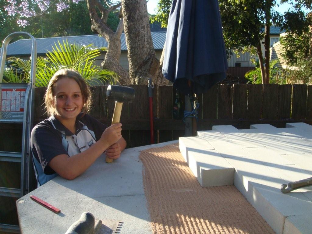

        The bricks and saw turned up during the week and today, I got a full day of pizza oven building. Even better was that I got to use heaps of my power tools including, the brand new brick saw, grinder, battery drill, jig saw, welder and electric drill. What better way to spend a Sunday?
        The insulating bricks are down and the floor bricks are all cut and bedded into position. My "indespensible tool" has been manufactured and I also managed to cut all the soldier bricks ready to slap some mortar about.
        In one of my previous posts I refered to my daughter as the "Brickie's Apprentice" she took exception to this and now whishes to be known as the Brickie's supervisor.
        Here she is in action checking that the insulation bricks go down straight & level!

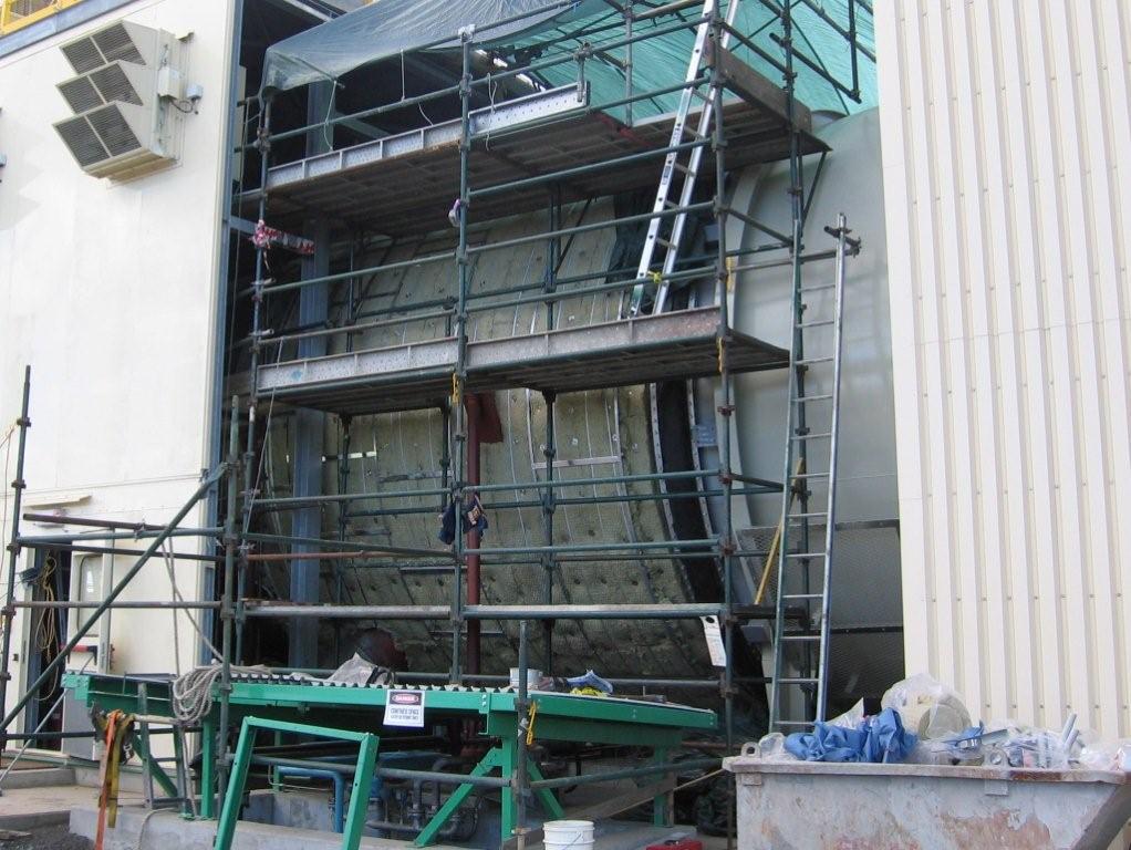

                                Rodney, the insulation that I will be using was a freebie! The company that I work for recently did the electrical on a new gas fired power station and I scavanged offcuts of the insulation that is used areound the exhaust of the turbine. In the pic below you can see the insulation around the turbine and the skip from where I rescued the off cuts.
