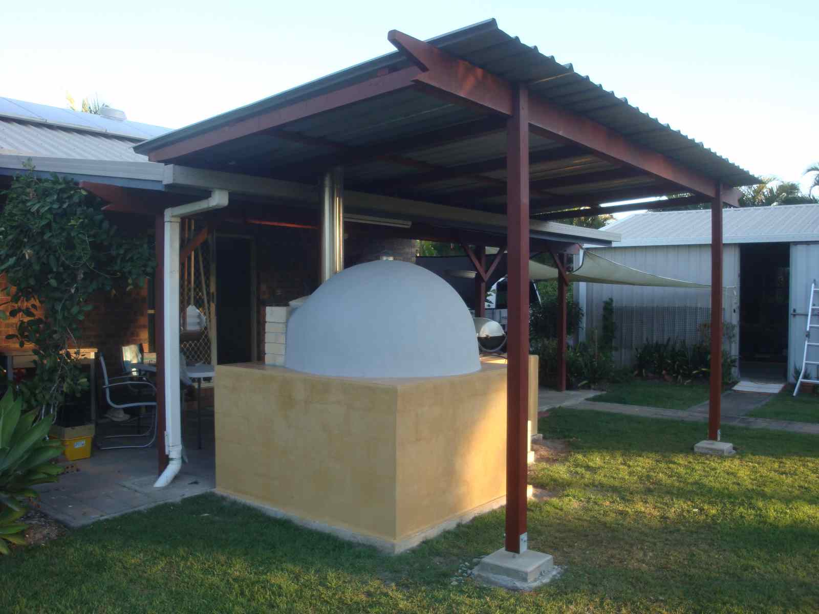

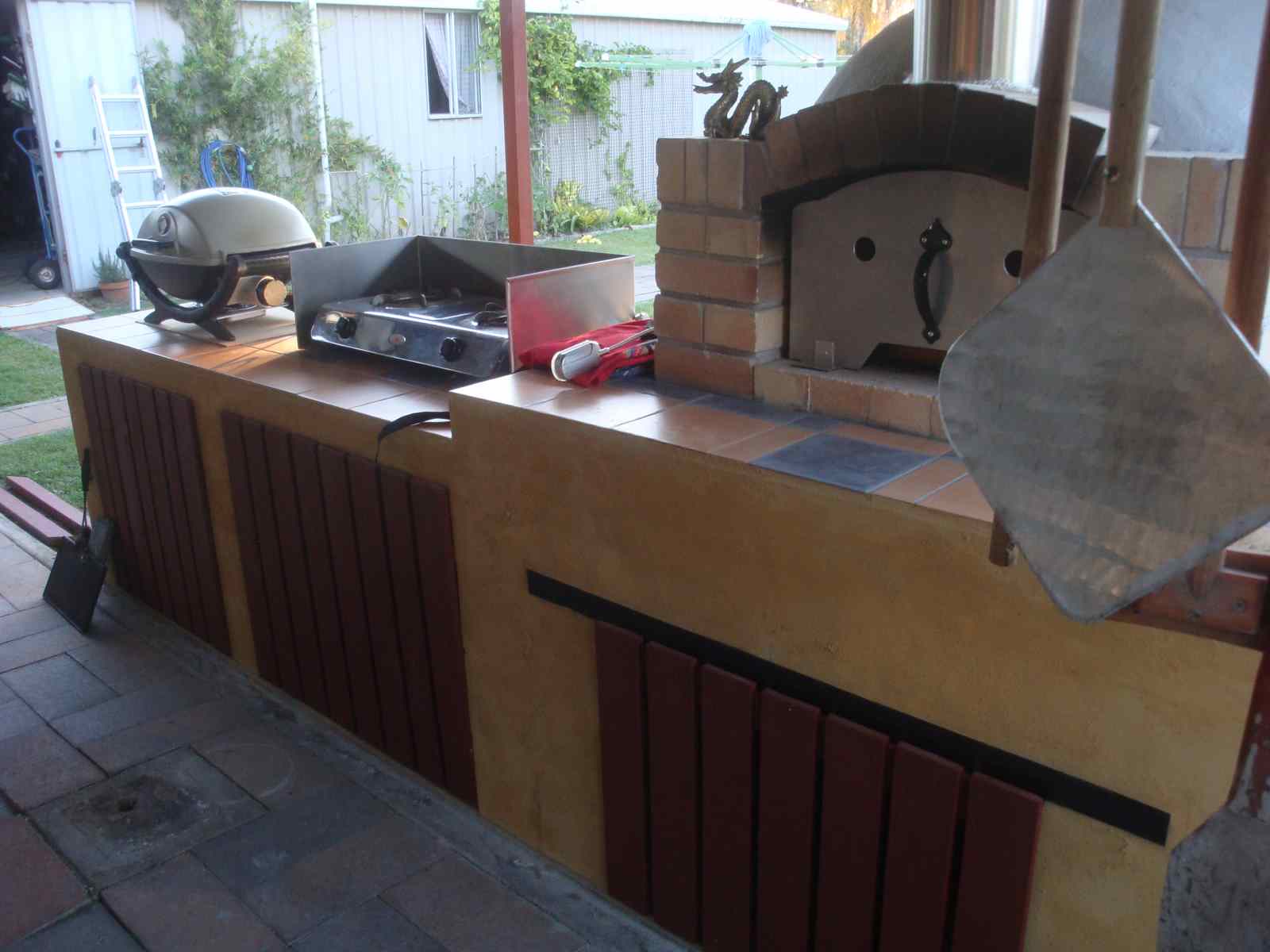

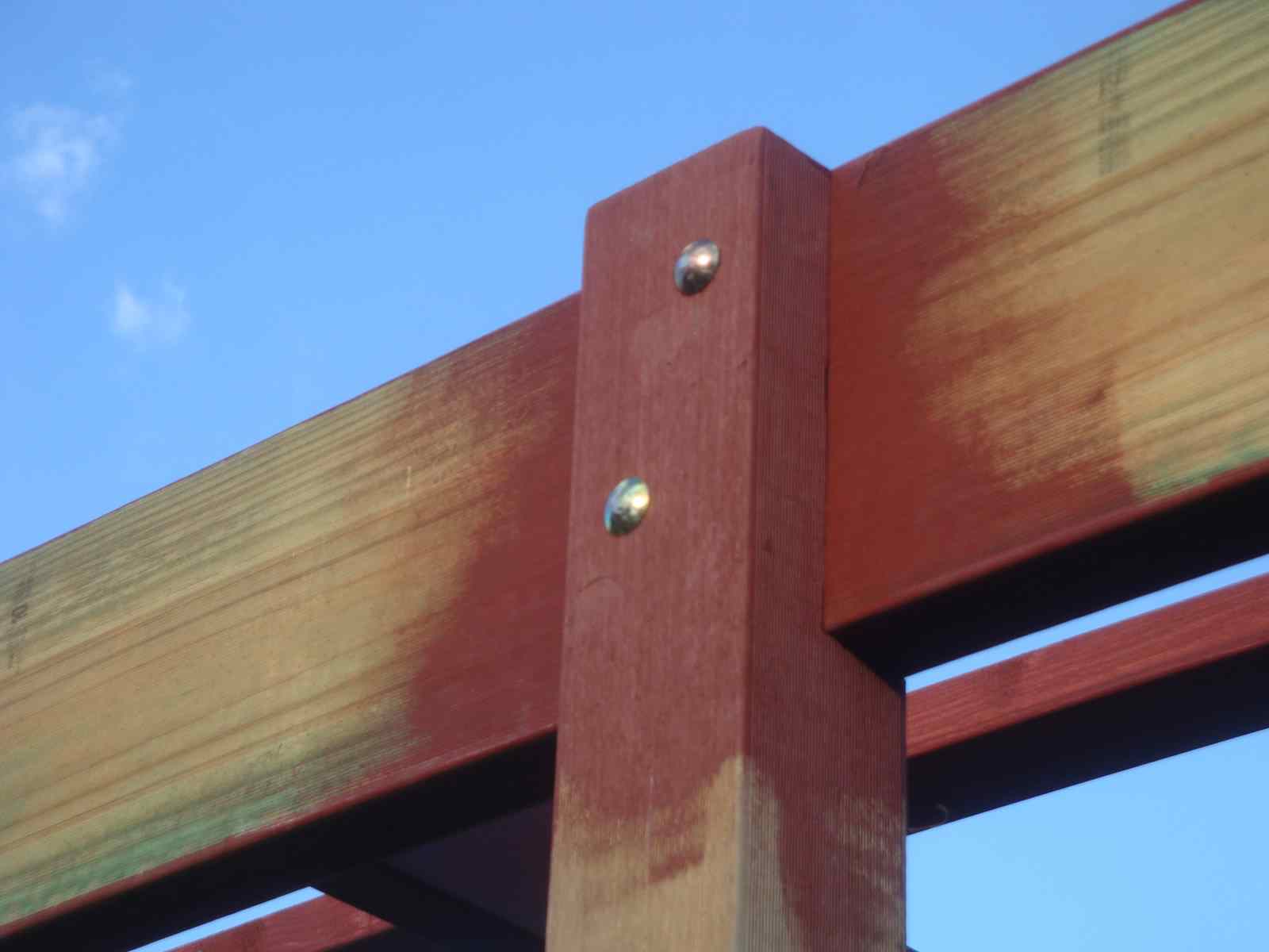

    It has been a while since I updated this but I have now finished the roof over the forno and installed outer chimney pipe complete with cowl that I had fabricated by a local sheet metal shop. Charged me $90 for the job so I am happy with that. No more putting a bucket over the flue either. I sealed the roof/chimney with high heat silicone and it works a treat. I was surprised at how cool the lower portion of the outer pipe stays.
    The job is now complete and after using it for some months I must say that it was worth the doing. Very tasty food, my domestic gas bill is nearly nothing and if we could get a drop of rain, all would be good indeed!
    These are the wrap up pics.
