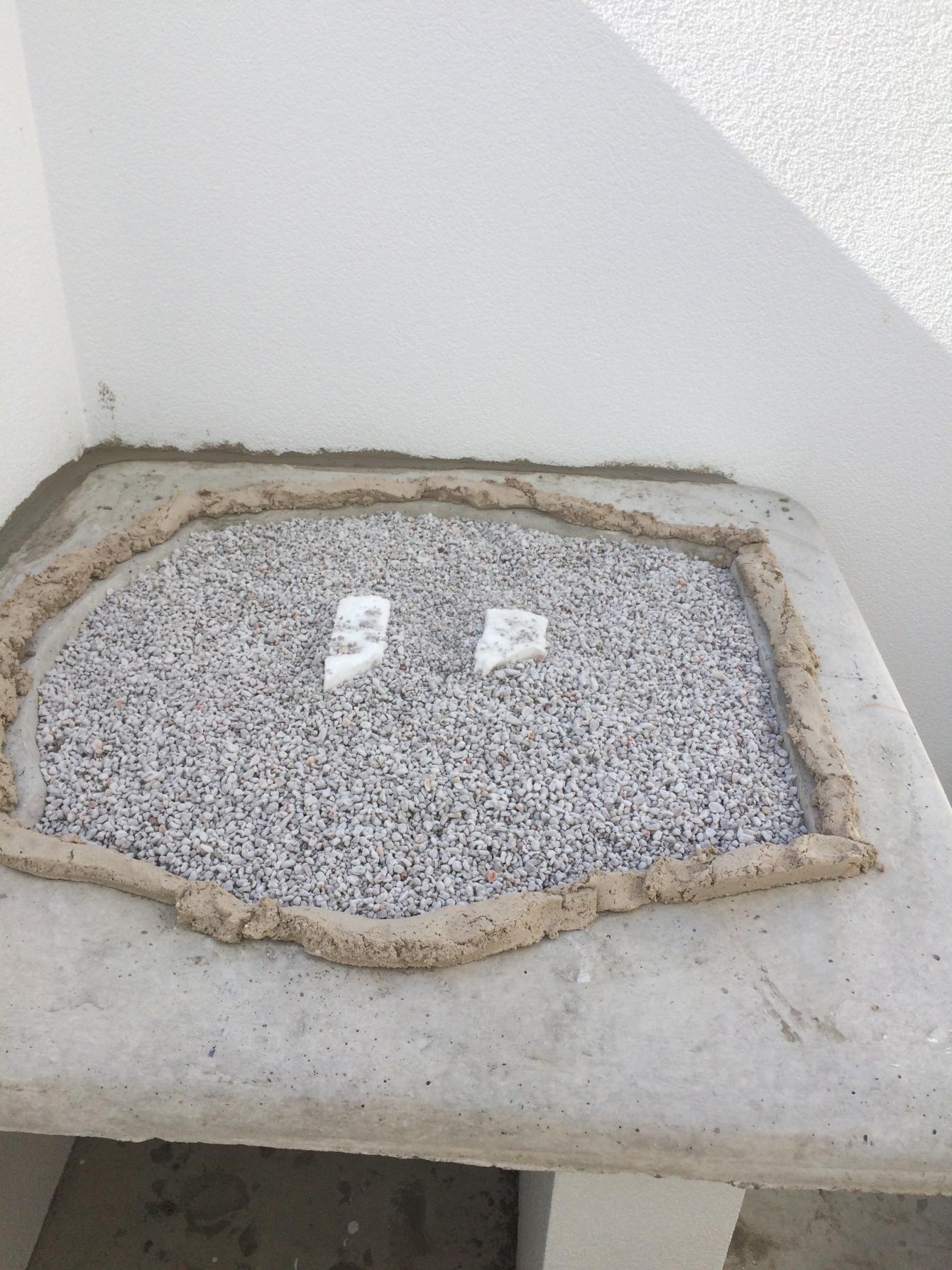

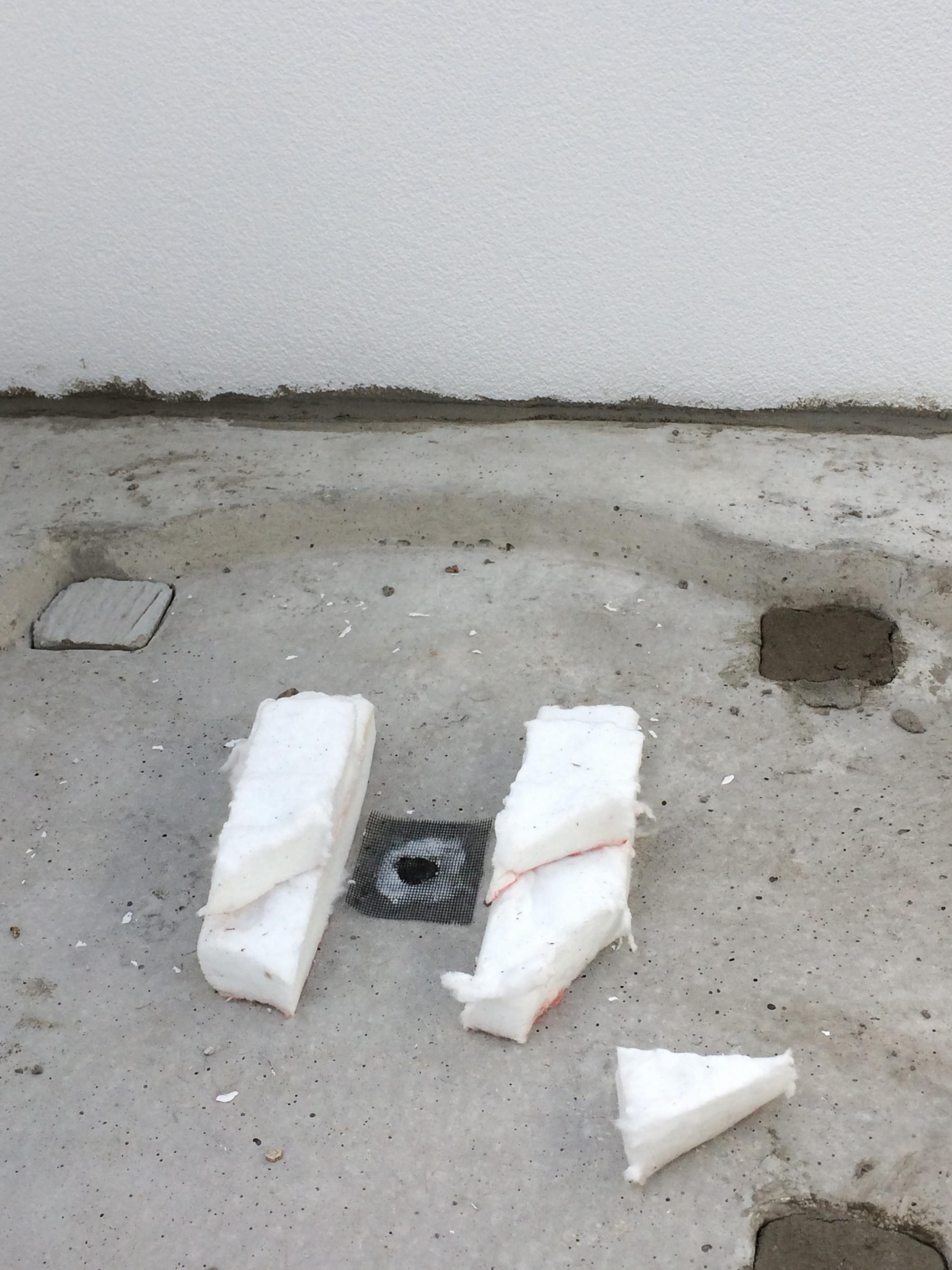

          In my build I have a small hole cast in the centre of my precast supporting slab. It allows the release of steam and water, should the underfloor insulation get wet. It works on the same principle as the little hole in a saucepan lid which prevents the lid from blowing off. I use loose insulation (perlite) as the underfloor insulation material so moisture passes through it more readily than solid board, but I think it would still work. My oven is small so I only have the one hole, for a larger oven you may consider two or three. Click image for larger version
