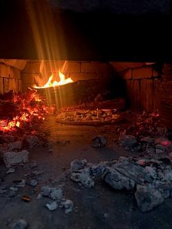

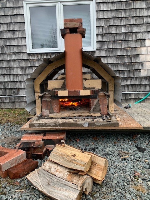

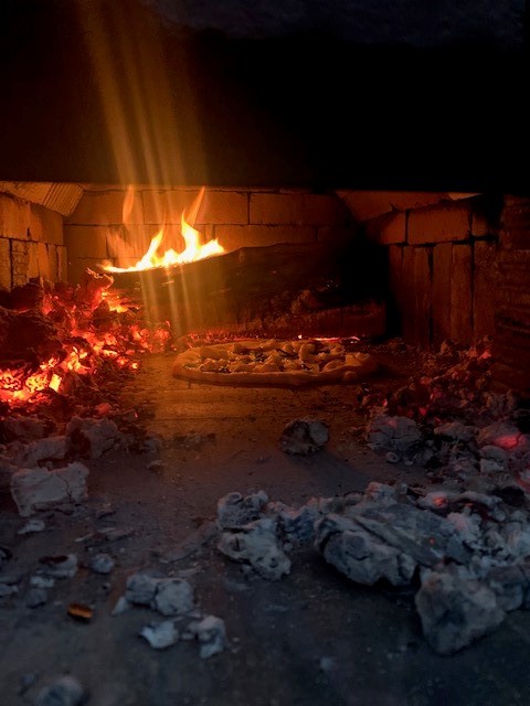

    This fall I had a week in-between jobs so I decided I had time for a short "me" project, so decided to use the 100 old clay bricks and 20 saved fire brick splits to use using a modified version of Make Magazine's stacked barrel oven This thing went together super quick, by my build took me longer than "a day" but I knew this would happen (especially since I needed to put a roof over it to keep clay from washing away!). There are plenty of things to improve upon, even at the most basic level, no insulated base! But after using it 1/2 dozen times, I finally figured out how to use the oven and have had decent results. And yes, my oven is currently set on top of a dock; its definitely temporary!

    Welcome to the Forum community! I'd definitely advise thinking about building a cover or "doghouse" enclosure with your climate. Be careful, it looks like you have the cooking floor bricks set directly on the plywood...bricks can get easily get hot enough to chat & ignite the wood. Look forward to your "real oven" build.

      yeah it isn't easy to see, but I put plywood on top of deck, Concrete pavers on top of that, then sand and the fire brick splits floor. Good thought though, Maybe I’ll try and temp scan under the deck next cook.
      also in the not easy to see category is the steel dome roof on top. Kind of weird, but it keeps the water off that clay.

        Before to go to far with the permanent base, I would check with the local building code how far or offset the chimney needs to be from the flammable wood siding on the house. In the the US it is typically at least 10 feet from any flammable structure.

          Thanks - that's a good consideration! It felt a little weird putting this temp oven where I did, but I rationalized that since evrything is contained in stone I'd go for it. That was the other reason I went with a temporary oven; we don't have the final layout of the location yet. it'll be well away from the house when all is said and done.
