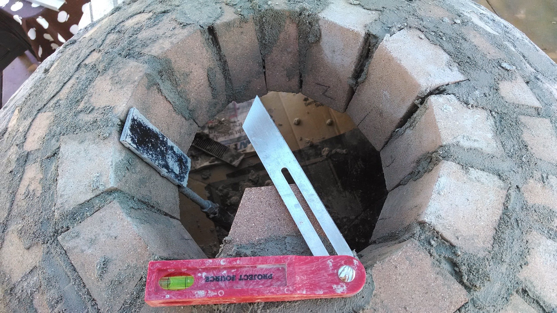

                    Michael, I had not noticed you started posting to your thread again. If you had any pictures of what is happening it would help. Not sure if I made this recommendation to you or not but you should pick up a sliding tee bevel from the hardware store if you don't already have one. They are cheap and very helpful in checking your angles and even transferring angles from a brick back to your saw.

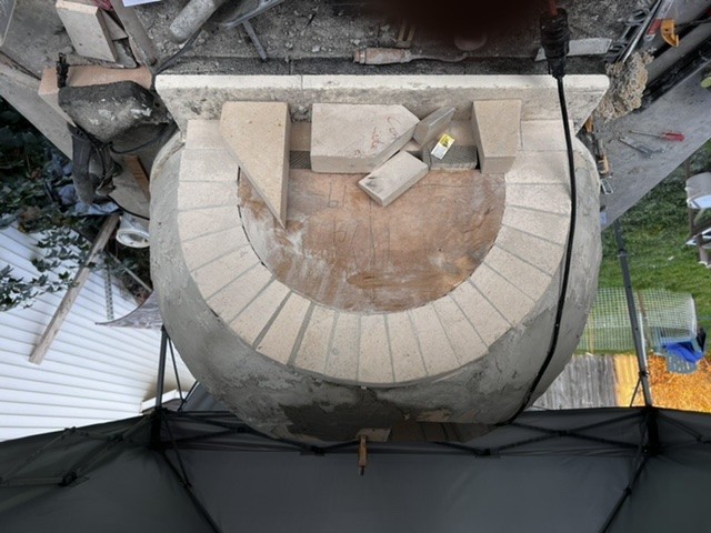

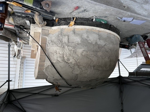

                          I have not posted for a while and worked on the oven until it started to get cold again and I had to cover it for winter. I got over the inter arch to row 8 took a long time to get the arch completed let me say it is not pretty inside but I think it is structurally sound. I do not have any pictures of the arch inside but here are some pictures l do have.
