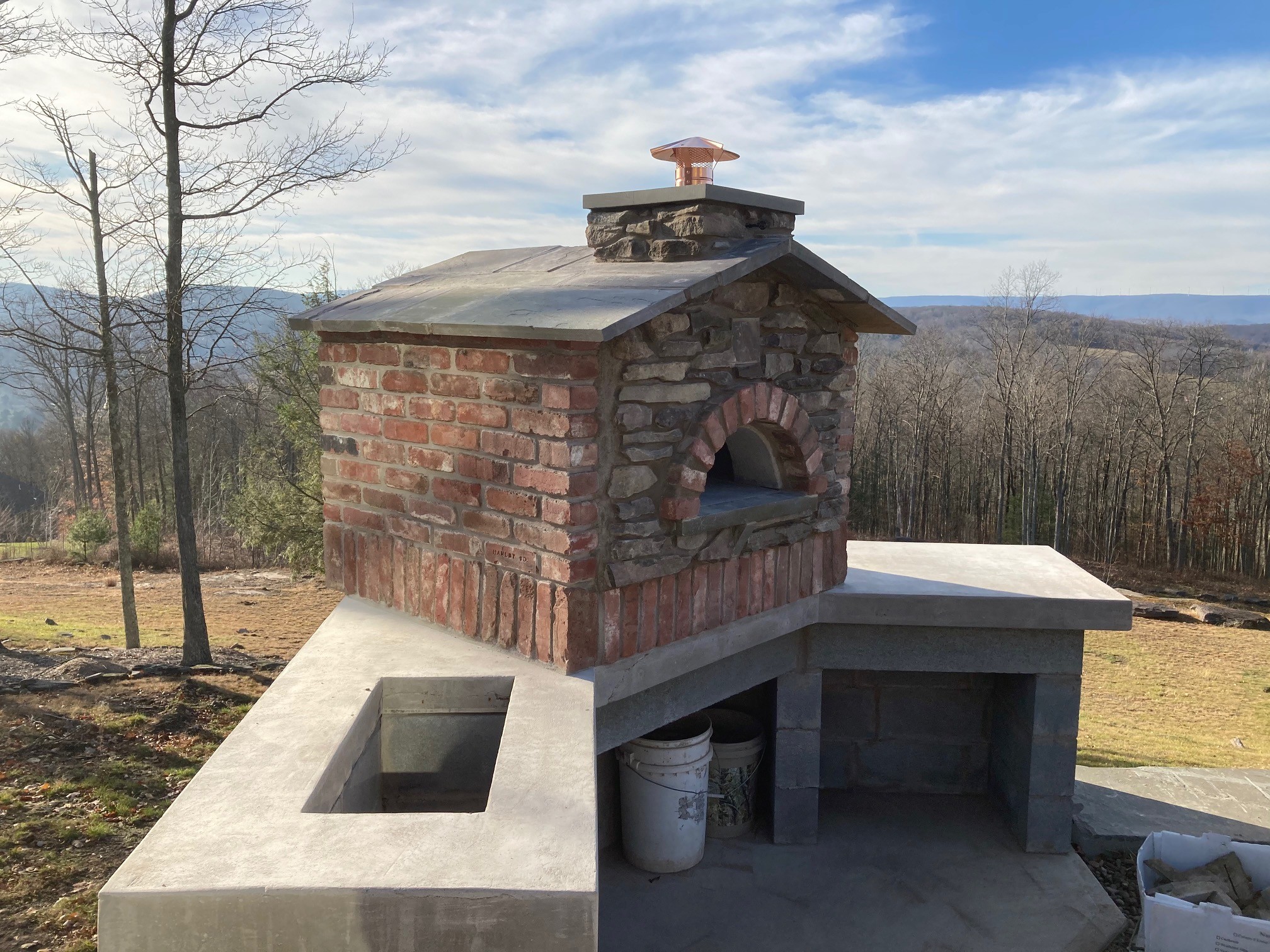

        One suggestion, build your counter area MUCH BIGGER than you think you will need. If I ever do it again, I will add 6 additional feet of counter space next to the oven on one side and 3-4K on the other. I have 3’ on each side and it’s nowhere near enough.

          I would absolutely 2nd the opinion of w650gb500. If the space and resources allow, definitely add more counter space!!! Who knows.. you may decide to build a larger oven.

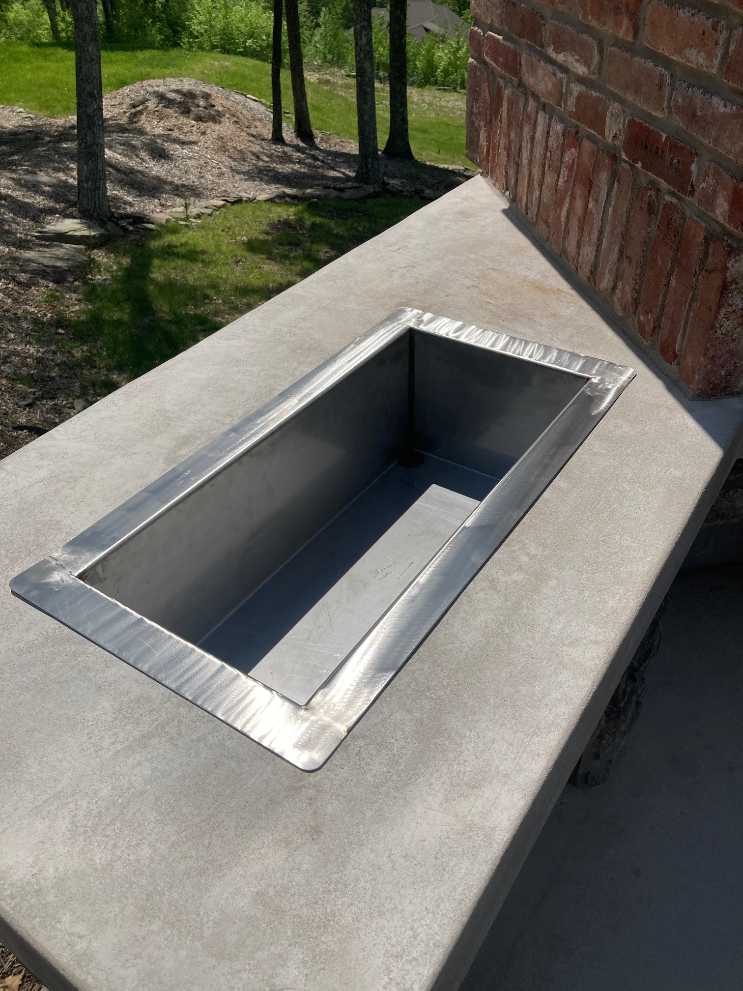

ID:	440679 I built my countertop with an open area on one side for a “drop-in” ice bucket. I figured we would be filling it with adult beverages, but the first night we used the oven it was obvious t would be used to keep all of the toppings cold. It turned out great and was a fantastic idea, but screwed me out of 3’ of counter space. It works for keeping items cold but next time I will make a longer countertop and still incorporate a similar area.
