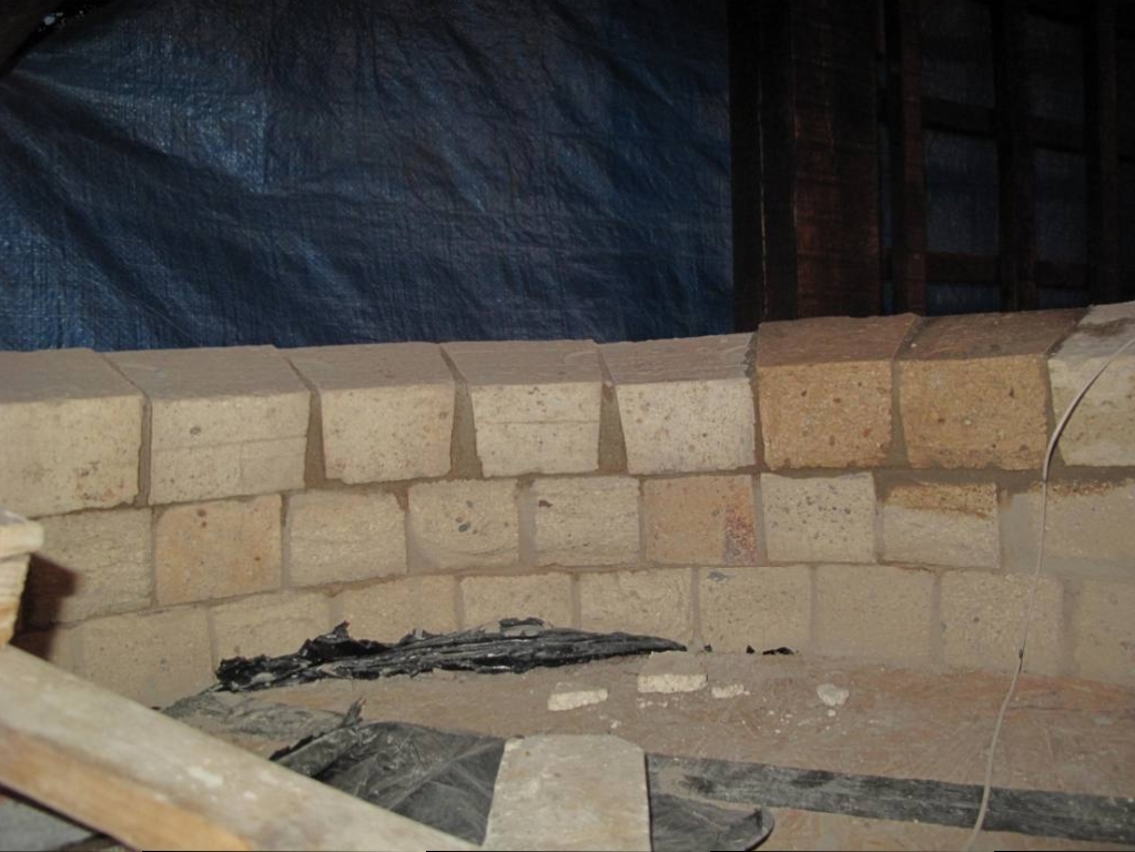

Hi Agrasyuk, The damp coarse is a plastic membrane the width of the bricks and it normally goes on top of the 1st row of bricks. It prevents the rising damp coming up from the ground and making the bricks go green with algi . it is used and n the UK on all buildings, and as I was planning on a white cement render I didn't want it to keep going green with damp.
Regards Roy
