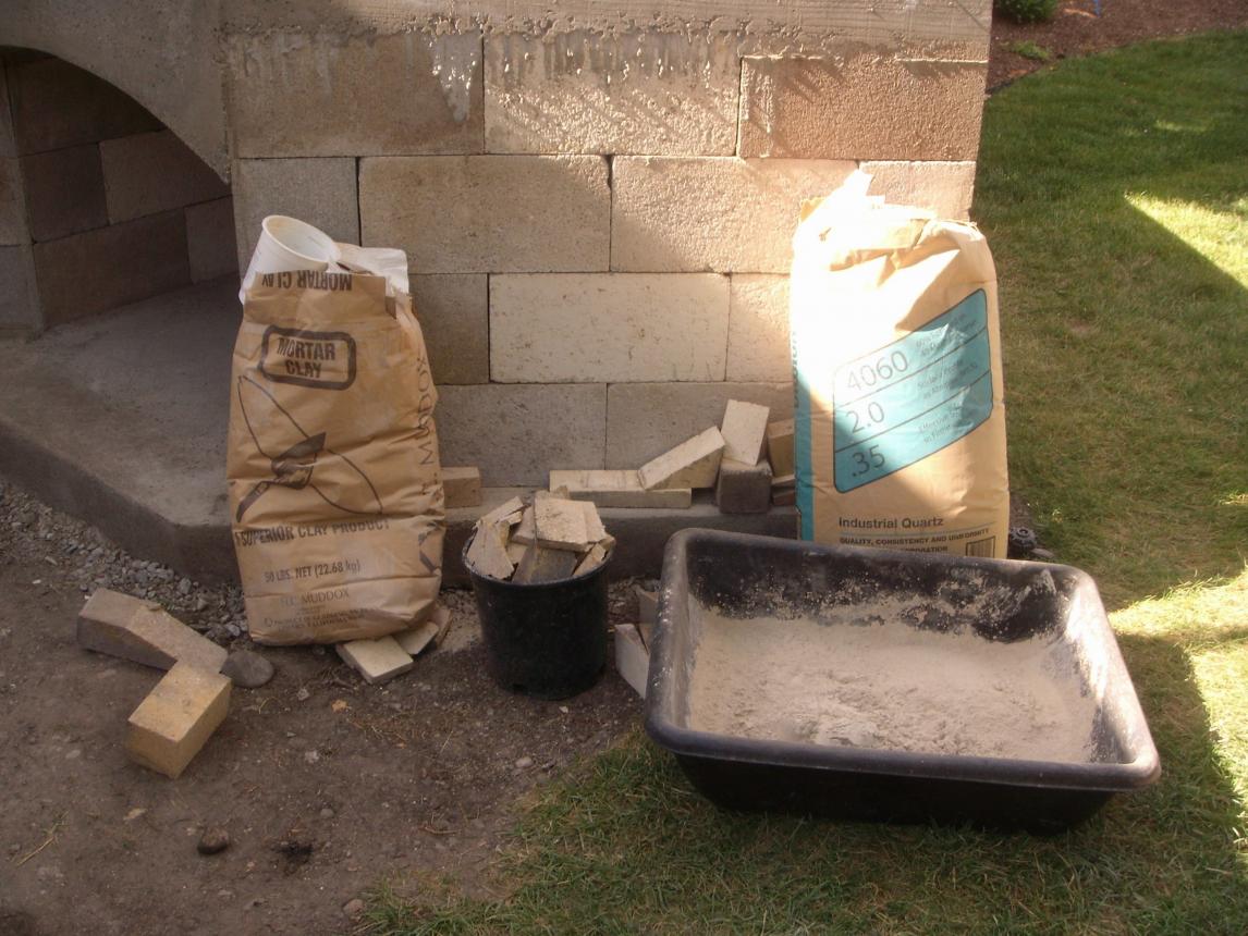

        Mike has given you some great advise. I second the need to add fire clay to any heat exposed brick joints. HC Muddox mortar clay is a California product and very inexpensive. You will need to go to a masonry supplier to get it, most likely not a big box store item. Click image for larger version
Name:	30 Fireclay and Sand Bed 5.30.12.JPG

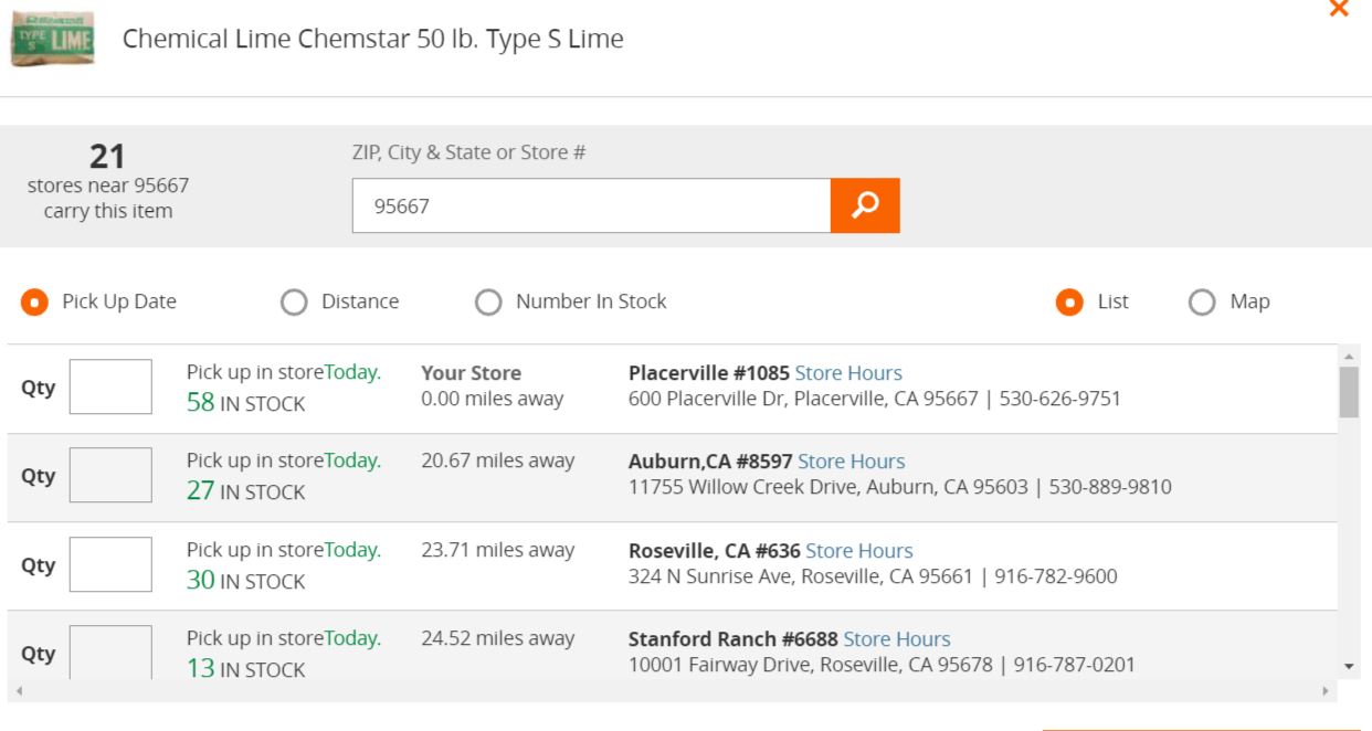

                      I don't know where you are looking but Home Depot in Placerville, near you, has type S lime. Probably worth the drive over there versa mail ordering

                      • #26
                        No, it doesn't and hasn't for a full year. Every time I check, it is Unavailable at Placerville
                        Check Nearby Stores and "This item is not available in any stores within 100 miles of 95667."
                        • #27
                          Then something is screwy. I just looked and here is a screen shot of the store stock. Click image for larger version
                          • #28
                            Holey socks!!
                            I'll just call the stores. Maybe I am misspelling or something. Anyway, I have to bags here, so dlrymixed now and adding water in the morning to get the inner arch set. Here we go!!
