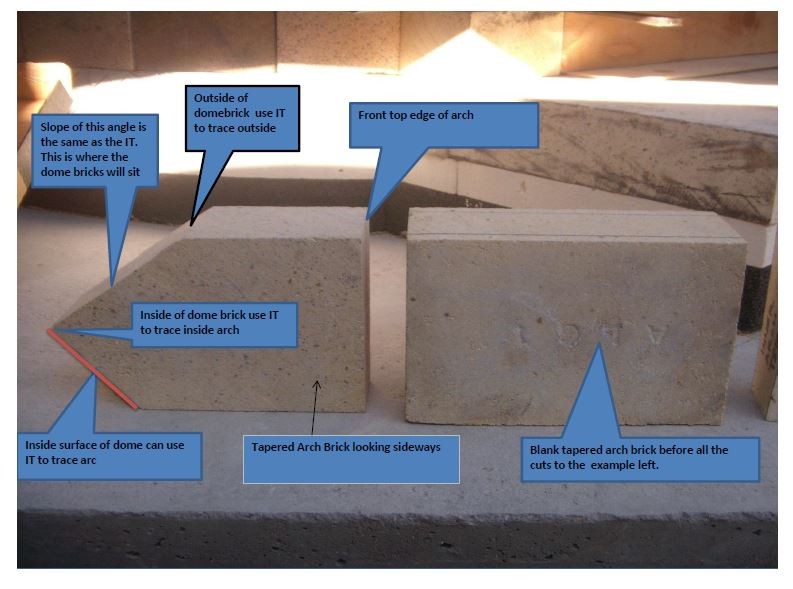

                    Do I need to taper the arch bricks for the support of the arch?
                    • #25
                      Builder's choice, although the outer joint width gets quite wide and sometimes this is an issue with factory mix, IE heatstop 50 which has a recommended max joint width of 1/2".

                        • #27
                          Cut the first arch brick to be flush with next dome course?

ID:	417070 You really should start at the top of the arch (commonly called "top dead center" TDC then work your way down left and right of TDC. TDC will be the longest final cut brick in the arch. The brick you have cut is only part one of the final shape (which was the ID of the dome, the brick still needs a cut the matches the slope angle from the pivot point to the ID of the dome then extending to the OD of the dome. Go back to post 9 and study the pic I attached.
