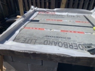

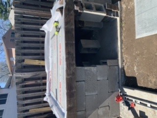

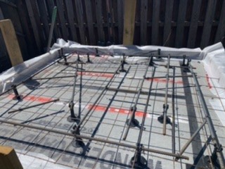

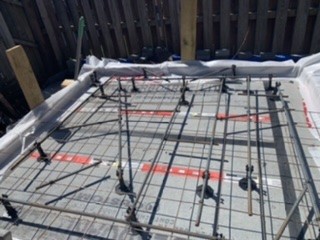

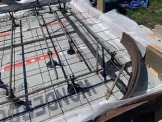

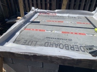

        So this is today work. Not bad for a gal
