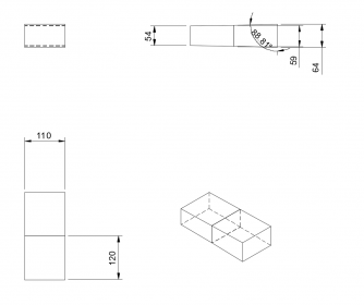

        A question: In which direction is the taper?
          Not sure how to define the direction... its the height of the brick (laying on its 110mm width, with the 240mm being the length that's supposed to cut in half). Uploaded a sketch of the brick. You can see the angle that is created in the taper, as well that the height of the brick in the middle is 59mm.
          Thanks,
          Benjamin
Name:	Screen Shot 2021-06-07 at 19.30.27.png
            Sorry, I'm not sure I understand your sketch. Please see attached sketch. I'm guessing the taper is in one of the two directions as per my sketch? Please confirm which one. 20210608_110349.pdf

                  Thanks Mark for that question, it seems that I misunderstood that as well, and thanks to your drawing I went back to the supplier, and it is like the bottom brick in your sketch. This answers my question I think, as I can simply cut it in half
