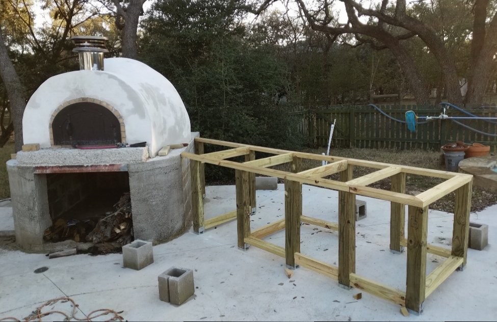

                      • It looks like we're past where it would be freezing*, so I can start to work on the rest of the outdoor kitchen. I am planning to use pressure-treated pine for this and have been getting some stuff towards that. I have a pile of 4x4 concrete brackets, and a new mitre saw with an appropriate blade for cutting wet wood. I think I'll end up covering both the inside and out with hardipanels; the range is specifically rated for looser conditions, but I don't want to bank on that grill forever. It also doesn't factor in the burner I'm installing.
                        I have one tight section where I really could use a 2x4 post, but I can't really find a suitable anchor. Does anybody know of a place online where I can get a good 2x4 wood/concrete anchor? It has to be something that mounts the wood a little off the ground and preferably takes something like one of those concrete wedge bolts; the 4x4 one expects 1/2" ones and I have a pack of them. I have found a few with wings, which cuts into the width I'm trying to avoid.
                        I can try to run some wood across the section and the put a 2x4 along the top, or anchor a thin sliver of 4x4 and then run a 2x4 the rest of the way, but I want to avoid as much shenanigans as possible.
                        *No Australia. I don't want your heat wave right now. No thanks.
                        • Wow this forum really moves, doesn't it?
                          I'm moving on to the "easier" side of the outdoor kitchen. This is for a fridge and two bins. The rest is counter space:
Name:	IMG_20180225_175155 Cropped.jpg
                          I can get a little bit of a wobble out of it still, but I also haven't installed all the screws and supports. I will have to do some goofy stuff against the side of the pizza oven in particular.
