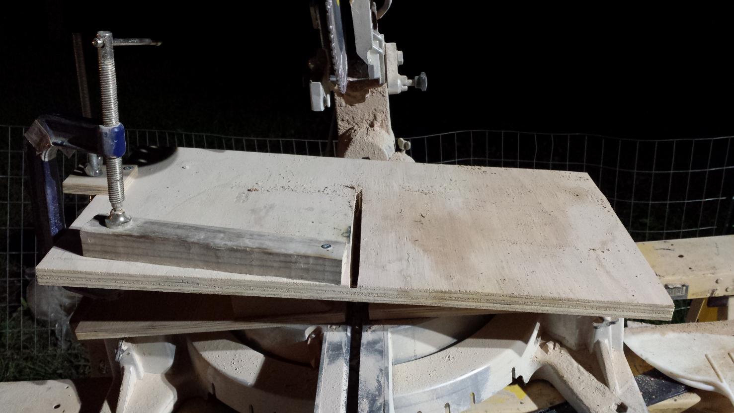

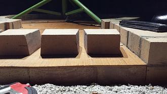

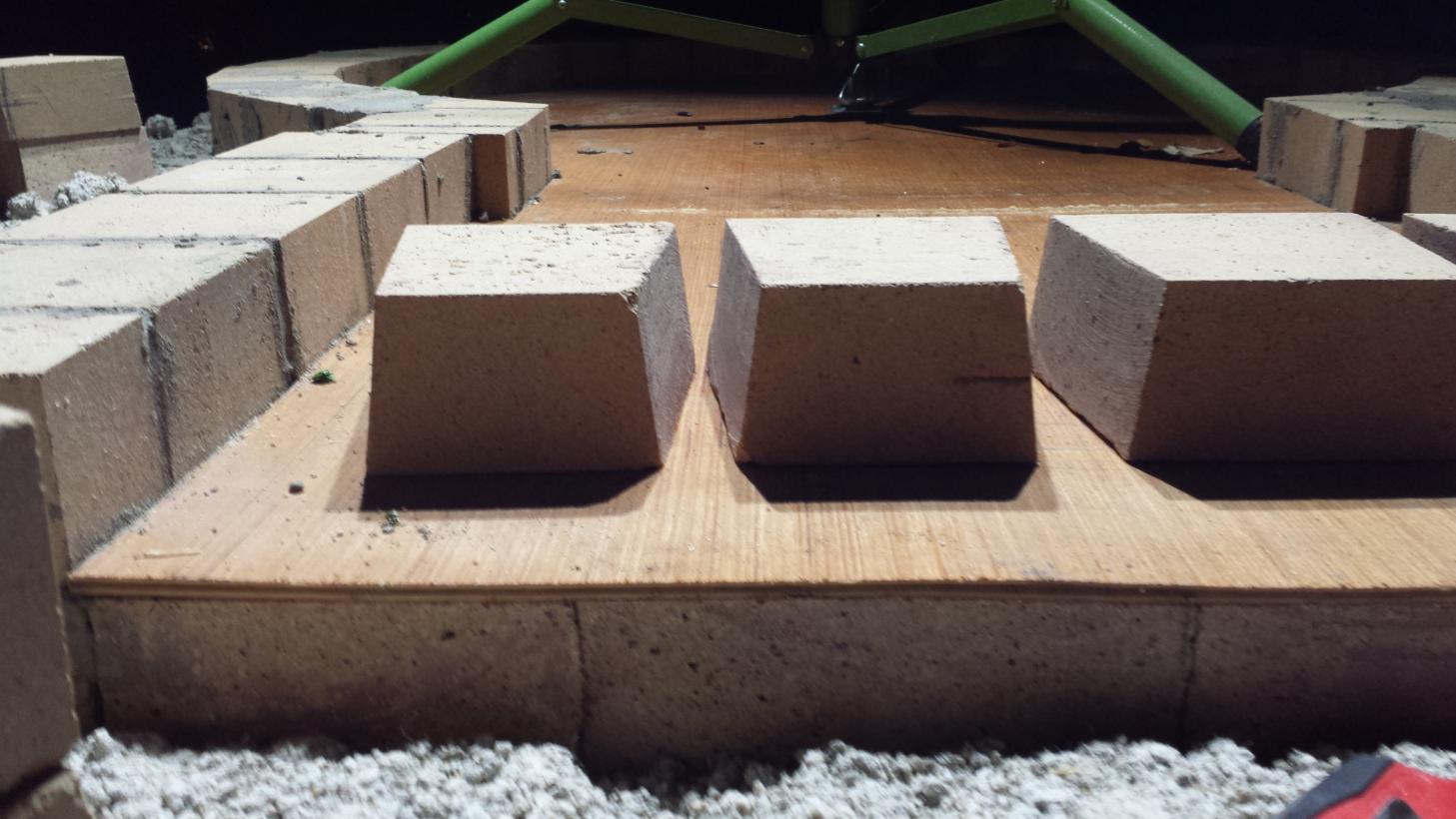

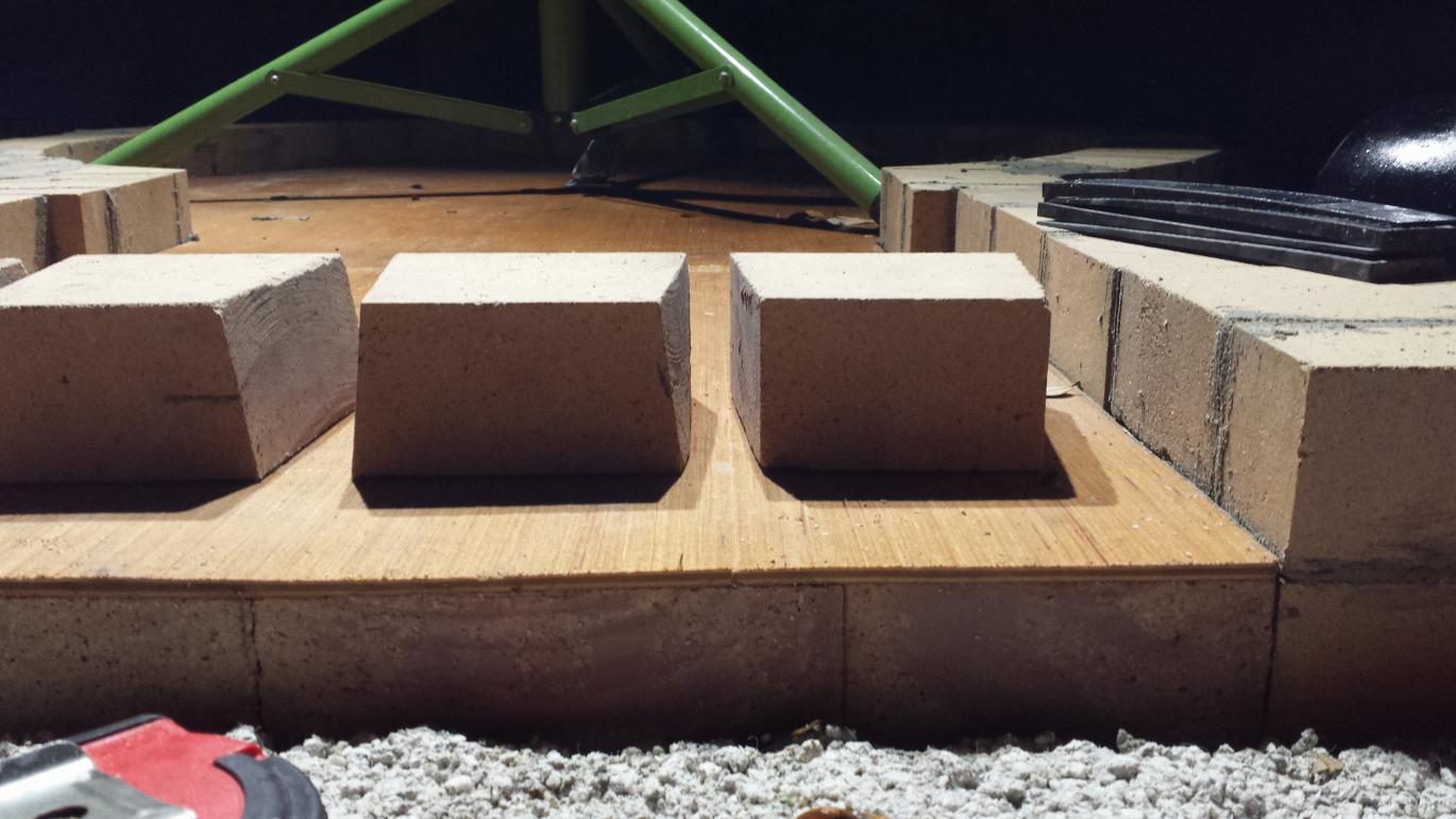

    I am planning to work on the front of the pizza oven, but I wanted to experiment with doing some of the angled cuts with my jig. I got some very inconsistent results. I have different angles from an otherwise static jig. Could it be wobbly? I wedged some stuff under it to make sure it wouldn't move around, so I don't know what is up.
    IMO these bricks have too sharp of an angle.
    These came out better.

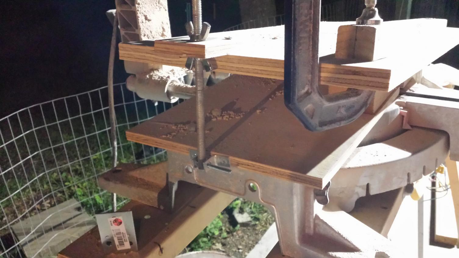

    Here's the jig:
