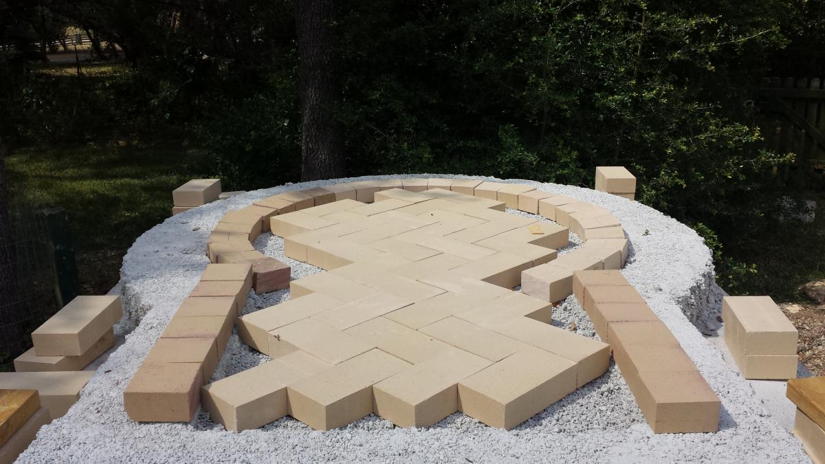

                                I laid down the floor. I actually cut the bricks to fit. My motivations were:
                                1. Not having excess brick going out past the perimeter that would have to be heated up.
                                2. I might need to actually replace these bricks because I may not be kind to them. I'm particularly thinking about dutch ovens and such.
                                3. Getting some practice in on cutting these bricks and improving my technique and rig for the dome cuts.
                                I concluded that my cutting jig needs some changes to the top. I had cut the slit for the blade too wide, which made the left side bend independently of the right side. This led to some wonky cuts. I also could have used a little bit of overhang so I could actually clamp down the bricks. I was using my hands, and things would wiggle a little. There were some scary cuts in there IMO despite a huge exercise of care.
                                When I was cramming the last bricks in, I kept thinking, "I really need something like a hammer and a 2x4 to softly tap these in. You know, if you only I had a hammer like that." I honestly went two nights planning ahead for that before, you know, grabbing one of my rubber mallets.
                                I found that doing the more intricate cuts was much simpler starting with making a cardboard template. It's very quick to snip a bunch of cardboard and dabble with that before playing around on the saw.
