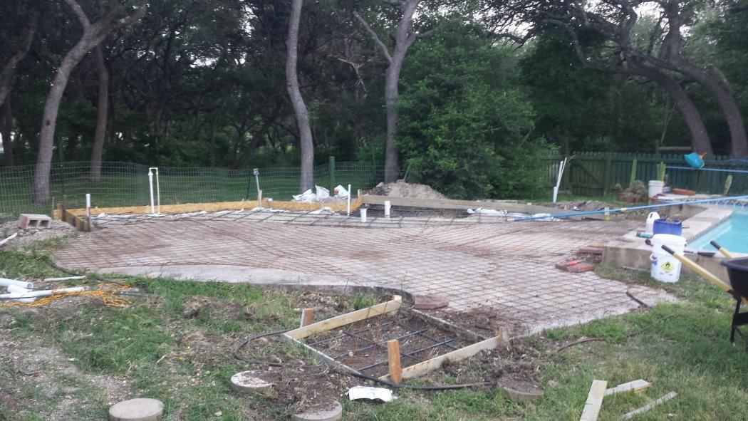

This has been real slow going. They finally got the rebar in although the forms still aren't complete. I am finding the result unsatisfactory based on things I read here some concerns:
1. Rebar goes right to the perimeter of the forms, which means they will likely be exposed after pouring.
2. Rebar put straight on the ground instead of slightly suspended by rocks or something non-ferrous.
3. Where it is suspended, it is actively tied into the ground with rebar. I thought I read it here, but doesn't this basically cause something like an electrolysis that eventually disintegrates all the iron inside the concrete?
4. They haven't finished the forms.
5. They ripped the cover off my outdoor outlet
6. They left a charger randomly
7. They threw--actively threw--a roll of rebar into a far-removed section of the yard that we weren't mowing to foster some wildflowers
8. The section they finished for the walkway required a bend that the ended up cracking. So there are splinters of wood in that part of the form.
9. They didn't drill into the existing slab and extend rebar--as the contractor had promised even without my prompting.
Attached is what the back yard section looks like right now. The pour is supposed to happen Thursday, and the guy's coming to see it Monday. Unless they do some major work Tuesday and Wednesday, that ain't happening. I'm tempting to make the fixes myself and take it out of what I owe him.
Do insist on work done and redone properly, but if forms are not yet done I'm not sure why you stressing about rebar on ground. Much easier to walk while working. If you going to insist on "taking it out of what I owe them" chances are good that you will find few unpleasant surprises left in for you in the work.
what this comes down to is - "they". I'm guessing that there is a possibility that at least some of the contractors are responsible tradesman that take pride in work well done. But so far I didn't meet to many of that kind. Hence "want things done right- do it yourself" is how I go about life. Your expectation of "they" caring about stuff like your wild flowerbed is either strange or naive.
Good luck with your project!
They are correcting a lot of it. They'll be propper up the rebar when they're actually pouring. That's fine. I was surprised they didn't know about the problems with connecting all the rebar with ones staked into the ground, but they'll be correcting it.
I suspect I will have to be really aggressive with them on pour day, which looks like it'll be this Thursday.

I recall reading somewhere never to attach a new concrete pad to a pool (with rebar and all). It'll separate and you'll have to deal with that, but it is better than either party trying to move independent of the other and causing it to crack. Namely--the pool. Well, the crew here drilled in and died some rebar before I could catch them. I had told my contractor not to attach them, but that got lost in a month of farting around.
So should I be alarmed by this or be happy for it?
They poured yesterday and I was checking it today. It was supposed to drain away from where the cabinets and the oven are going to be and instead flow along the side and also into a drain I had installed. It does the exact opposite. Not a drop of water reaches the drain and it all flows towards the pizza oven and cabinets. All I can think to do now is to basically etch a drain into the slab right in front of all the cabinets and have that run off to the side. It's that or obliterating all of this and basically starting over. I'm extremely unimpressed with either option but I will at least give the contractor a fighting chance to explain himself. He knew all of this--repeatedly.
The walkway also has some divots in it.
Update: I guess he just heard "pizza oven" and just tried to manage that, despite me going on and on and on about "outdoor kitchen," "cabinets here," and having plumbing and electrical sticking out of the ground.
It looks like I would also have build an elevated base for the cabinets anyways but now I have to set up channels through that.
