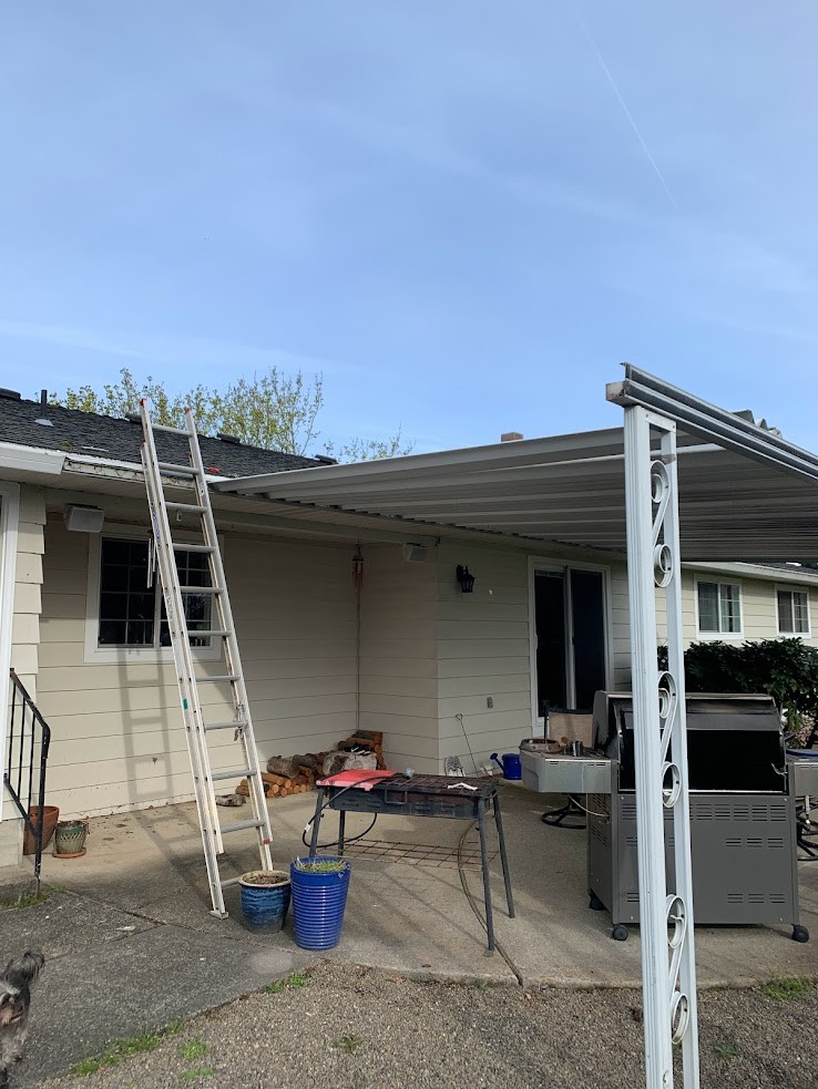

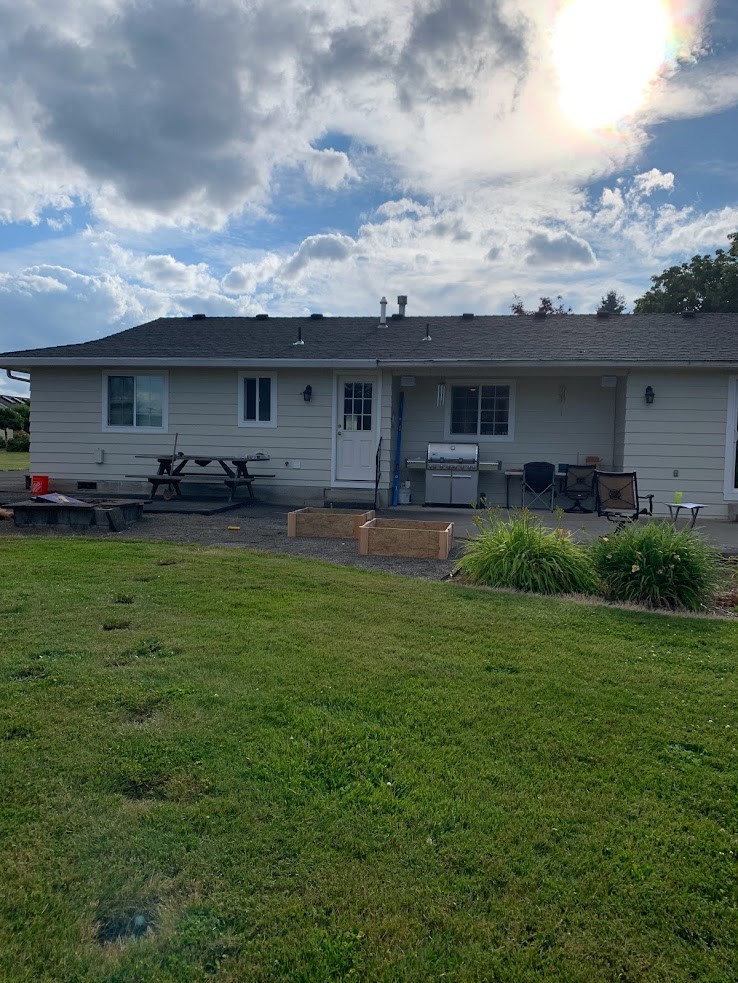

      We began the project last summer by tearing down the 45 year old patio cover. This was a hell of a lot harder than I thought it would be.
Name:	AIL4fc_gRgbe6FVApuJkXpeeIyvRnrOu1CKDLYJpcmnlIeVv1TqiKRmdzZX7f3_LrKlZcaJ1eL06IVkrtA3ewQ7zwoKd1sQtQ1t3y3VPEYaIuPMbCgDNahu7QGCNDRLtDFzLKwIJc1NLlaBNjTGNQ5z_pFL8KeHHjAN_xGREv2Wgdd2LIOYm4MRzIGQbGwNXVWrEd-pxJzTWac3AKOGrQMV6qoyrPoFyd2VVHCyb6_DysXvNL9IyktuwaHuJbO6

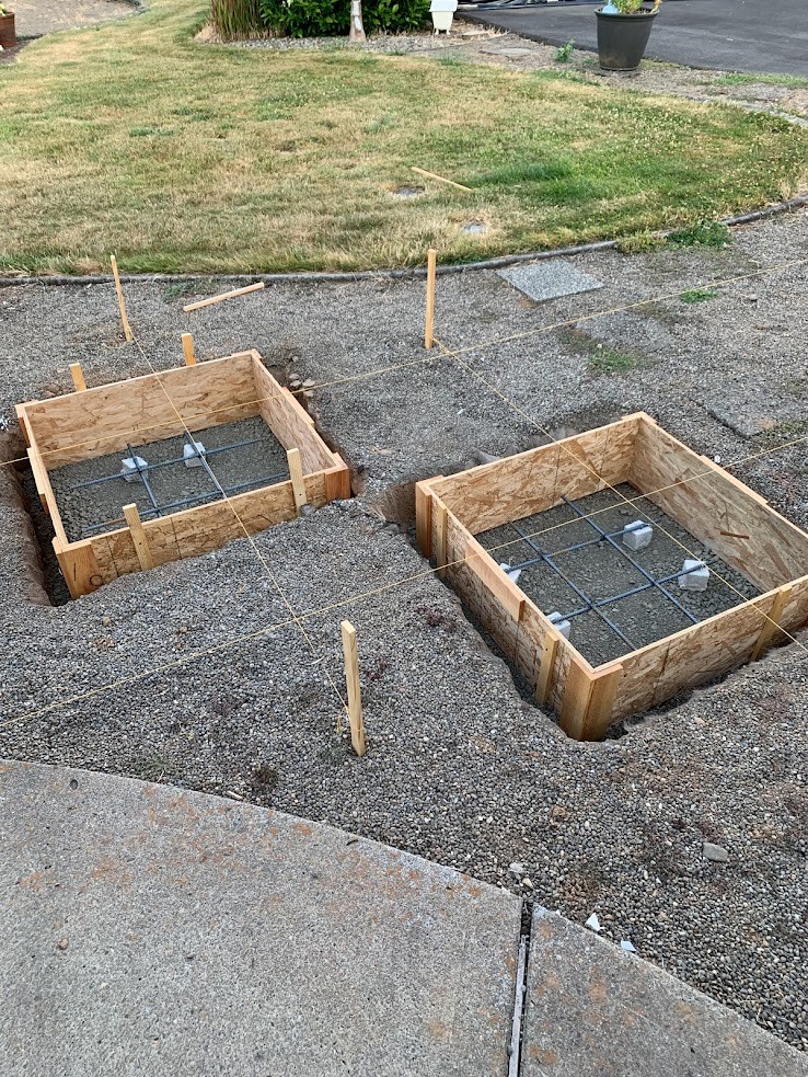

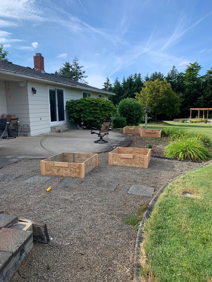

        Laying out the footings
Name:	AIL4fc-k87WiyO9P0bOODExqP6q41zw349_dwjfIe5S9vpef1dydr4wuhgNp_-X5FSYmhaMCsF4h3QYId-ZxxQkJYH5w2yy67LMB_6QKEPacKSxeSh-FwJB2kAD43RVJk3pCcB_hlyOrA_TJkolZ3fuxUDkB1yllKLTSJOd7RaiIPxe722en2p9dAlb-5sHJ5e_xFj_L4LXZ55AwvCCVkM8PnZSeat4iAVKv8TUlEc_2Ffxy0O-ezXAPaek3p-g

          Little different view

            Dug the four by four footings by hand
Name:	AIL4fc9jJmT8DAk9f-4LhxXkr8kXK45bKm31fNUWaVYLjj0teG5Pn7OugFByobF9ycsLLpRohZD7UJB9OagkDeiaFqd1isX5ruE4nlU7HZ_urlXfhL7_OtIj2-USbhhcVA008ozosrjT-x4Bn1mrhQZ2zhTud7nzzDfEQ94OCimsJ7fflfYkDnak-KZWMnIXlLRjJCJbaDn11Se6AS52JcMi2abKVVTLpU3zE0SnYA5SxbAa9tC72-IU0RlqoO4

              Used string lines to set it all up which was pretty fiddly but worked out well

                Tied rebar together. and used some blocks to keep off the ground

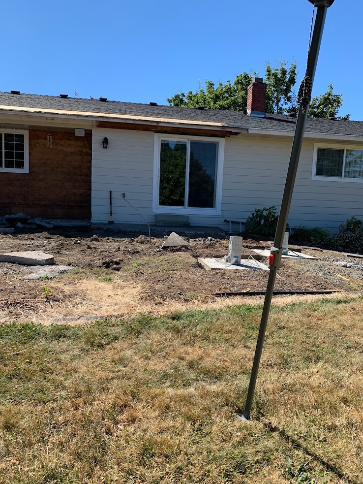

                  Broke out the old patio. You can see we have poured the footings and set the post bases.

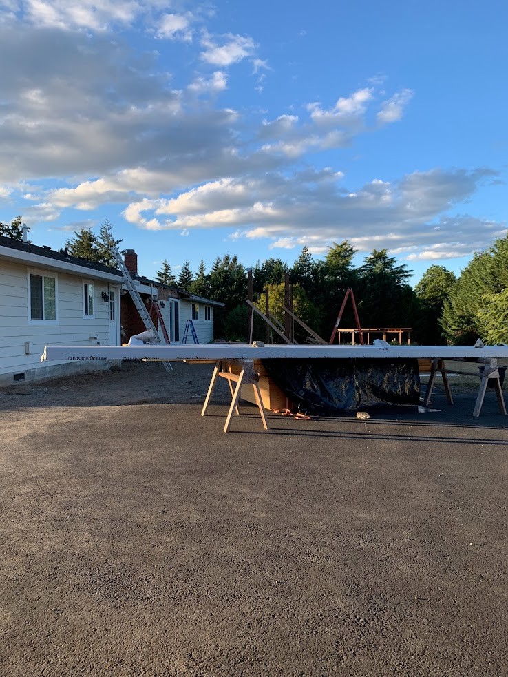

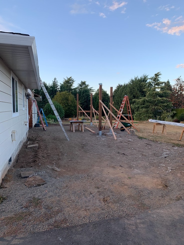

                    Beams and posts were delivered. Beams were several hundred pounds apiece and we humped them around the yard foot by foot to get them into position.
                    Click image for larger version  Name:	AIL4fc_x_Toq7qEY5DQzcrAo6NQ67ywZdk6jYp0fhCO7ZgN1MoktRkfmrwx5VGZaBrRmuv8HbIblpv3HF8iMWRtwnRlxqfdCB2kD8ZtGdWxI7Y0MXVMpLszjIUjk-zrW-5o5Ff-WdiFmwI-_mKXtXz5E_6sePBPfe818MhxIuyZq3ILDxXo9dqmEnNN_07US1QPXvzFNz8yd0HjEbs3mYK5HK_wFBOp_aoMXcZrtGl8v-h6rLnYJ0CPScgmIxQM Views:	0 Size:	241.9 KB ID:	455203

                      We set the posts in the brackets so we could measure the tops for final trimming. I purchased a Bosch laser to help with a lot of this project knowing I was going to do framing, tile and other layout and hoped it would pay for itself. Turns out it did. It was ideal for figuring out how to trim the posts to the exact height (I am sure professional framers know a better way to do this) and they turned out perfect.
Name:	AIL4fc8cr_GH6DMW1rCnbqI8K0mSW8IXqdv9cV6xdvU_kQoI3-E4gAgysZVyV6_SwA388PYNMwKK7tpcTat0irtxaZagiLfSVFzCgkjDxqk4MuYDT6PtZ5nzJ-RgYqABTmJ2-rP4Jbh5mL_mtyBiGbNQ2rFWh-I822xBF-esdEQr8xScwBEII1q3g5zfv8XlANKKXTtFTf75xw3asJcgToczYNpbDnQuBaYgbFt5JDd9AoatFjvXoet6jMl_9wp

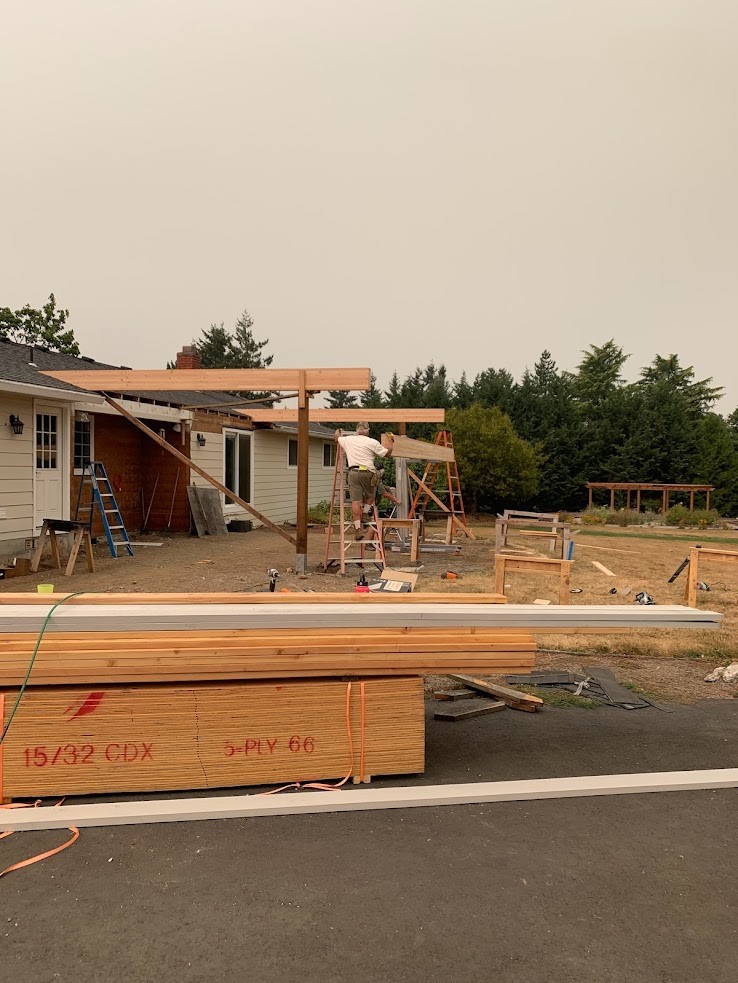

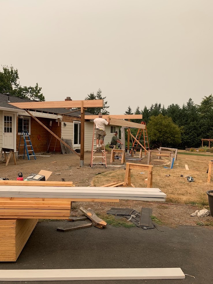

Name:	AIL4fc95PprVMPyJriHzIblZllsAkYj6yW4oIX5vo7PQ3TVTi8qil4zfhW04TXCX-wF269eS2x7FHtdcBTbQsoEh6PfMce6HKfPjCtzy47t0MmHsamZWT8oFcnEU1iizIrBi378kFvhDCNGEqy5fuXVVmAhjaAJJ6tJIQ5UYKvLwaJcCEBO6ETTvBmsWjYg2YKPXyYh2B7_y72zmXLwBmH3l4W5Ses9xHZQNSMecJW65kdRQJqZBzuax2Mck7Vo
ID:	455304Setting the beams. This was pretty terrifying as I rented a material lift but the beams were so long it was totally dodgey. We got them up in one afternoon though which was a solid accomplishment.
