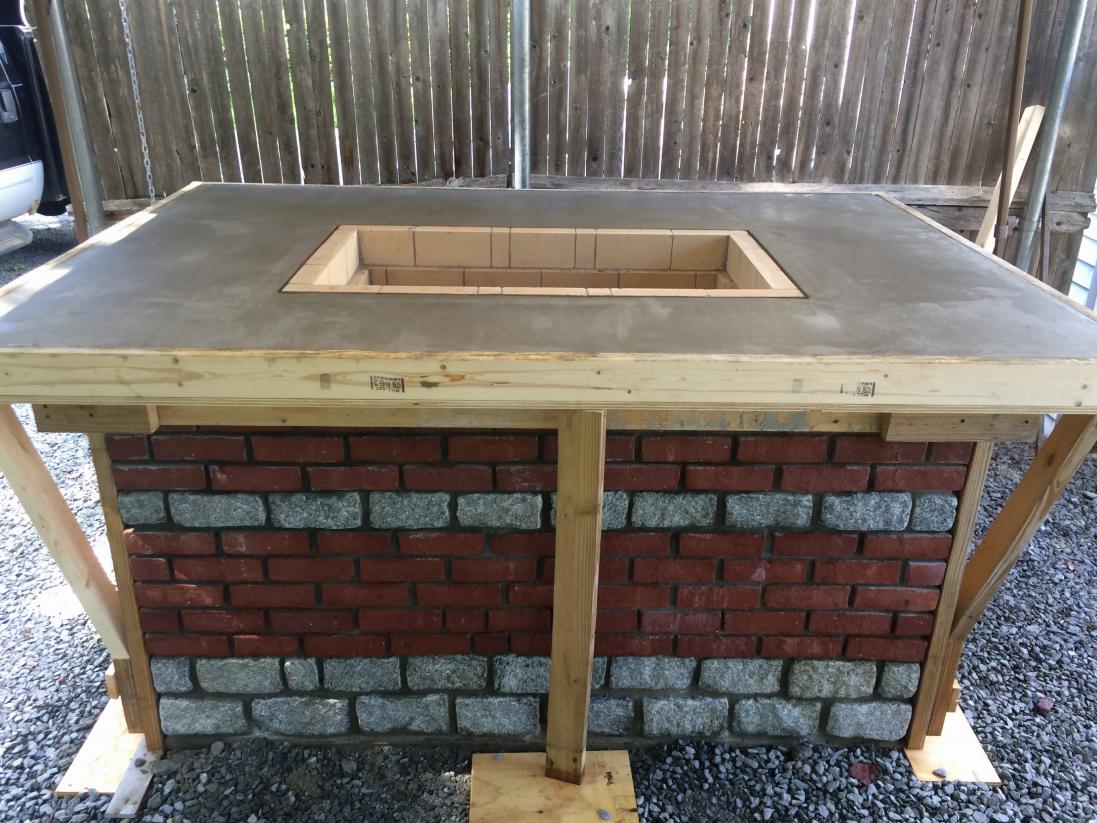

ID:	400251 Ready to cure for about 28 days then forms will come off.

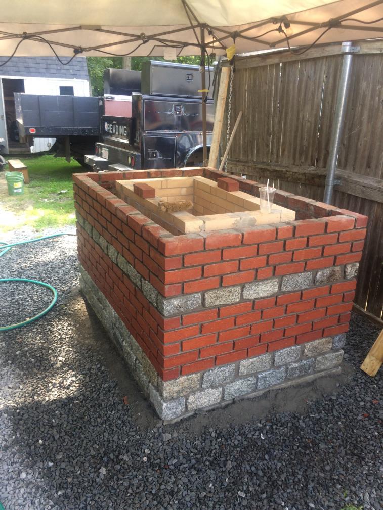

      The photos don't show the fire box with air intake located on the floor of fire box. Grates will be installed flush with cement counter

          This was an original design that i had thought about for some time. having a bbq island has many benefits.
          The ability to have plenty of area to cook and to present meals for cook outs or just a place to conjure around a couple of burgers cooking. Not to mention the total length of counter is 20 feet .

              Wow, that looks amazing. I might be seeing your advice on staining and polishing concrete if I end up going that route.
              Well done
              David in Calgary
              My Build Thread
              • Indresano masonry
                • Jun 2016
                • 10
                  Beautiful concrete finish! Did you use acid staining? Have you installed the grates and cooked on it? I'm looking forward to some pics of it in action .
                  • Indresano masonry
                    • Jun 2016
                    • 10
                    I did use acid stain . Was awesome to work with. More pictures to follow in spring
