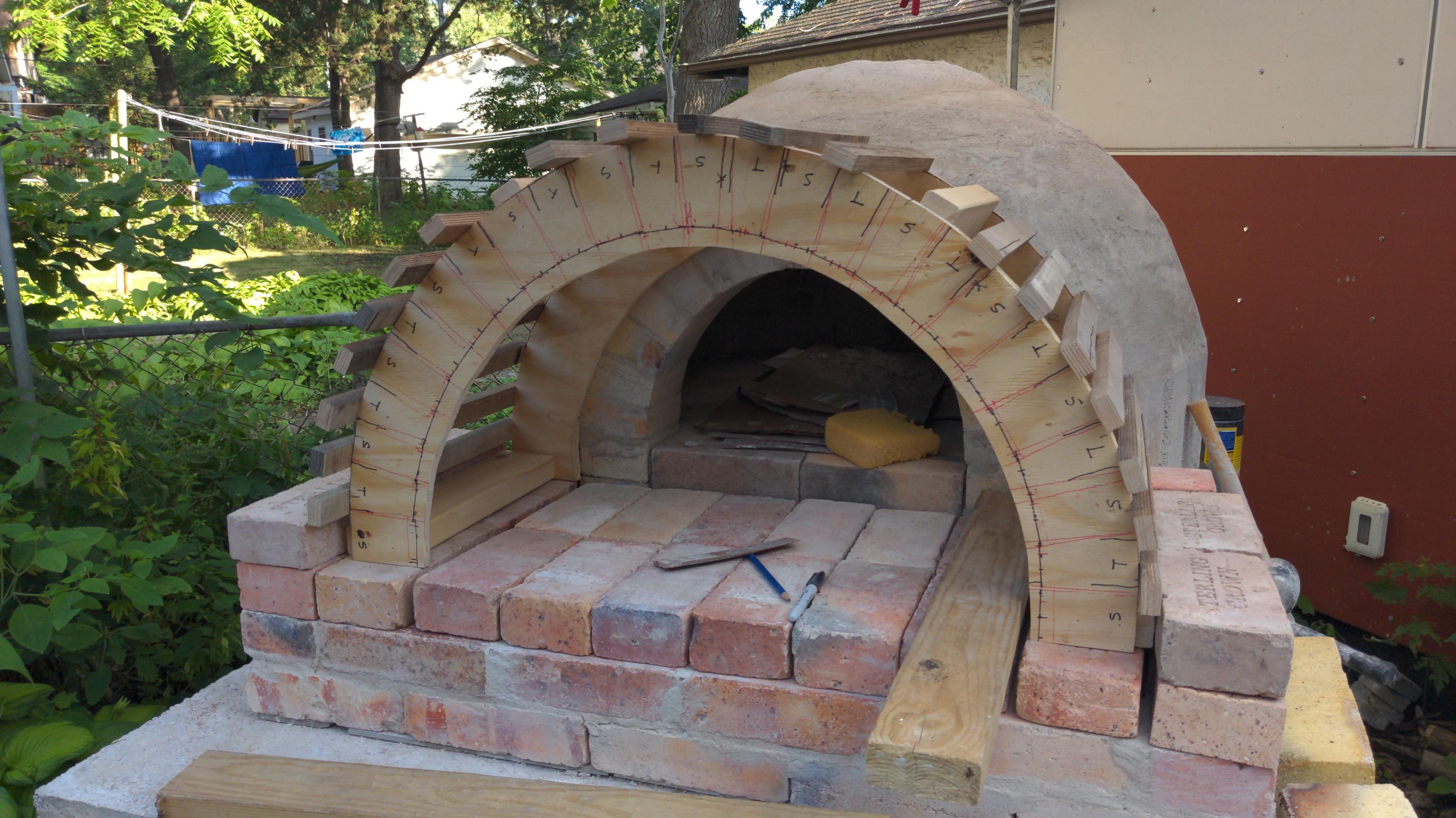

      My solution is not built yet, but I'm doing a traditional wood fired pizza oven that will allow me to take coals to the front gallery space which has been enlarged enough to do some grilling, perhaps eventually adding an adjustable height grill. Here is a photo of the gallery formwork: 36" wide x 21" tall x 18" deep.
      Sixto - Minneapolis
        Before you lay the arch bricks over your wooden form, make sure you place some removable wedges under each corner of the form. This makes removal much easier and prevents potential damage to your brick arch.
          Plus one of David's comment, I used 1/4" wedges on my inner arch and it was not enough to drop the form and went with 1/2" wedges on the outer arch form.
