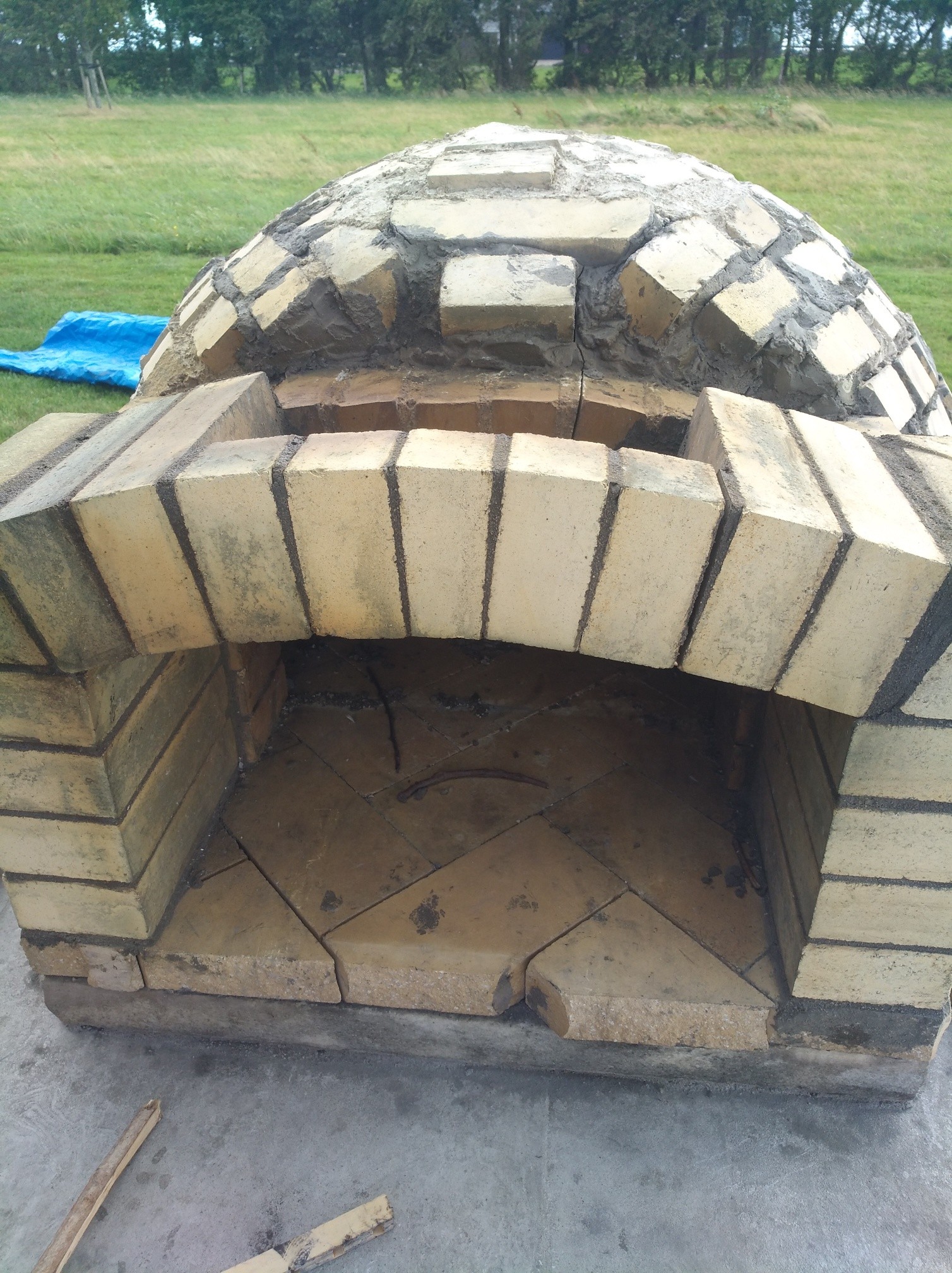

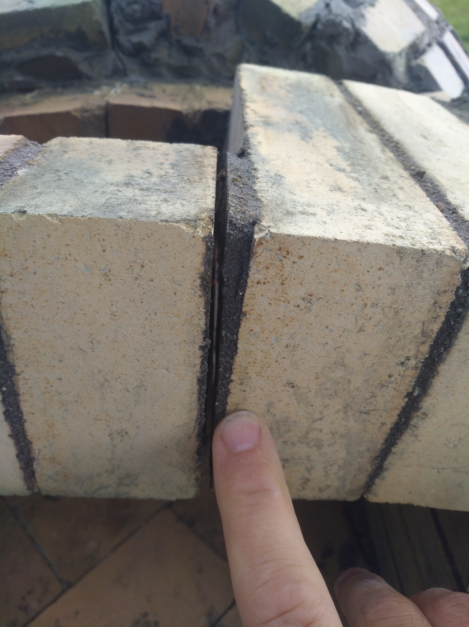

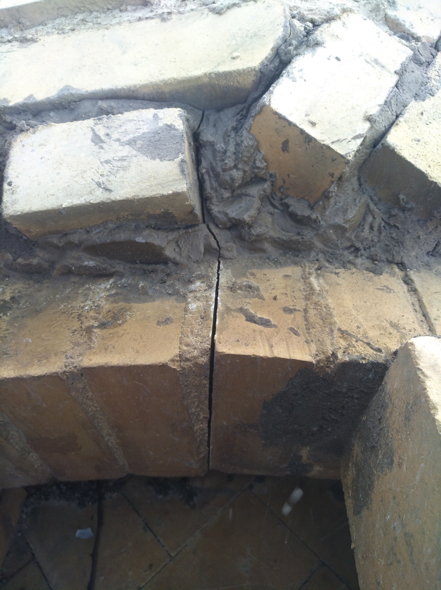

                              #359
                              Hi all,
                              Today we made the first fire in our oven and messed up big time, I think due to being overly entusiastic. The first fire went up to probably around 570F. During this a crack appeared running from the front door over the dome to the back. It's not very wide, few milimeters, and seems to be interupted with parts that didn't crack.
                              We of course feel horrible (and stupid) and are wondering now what to do. Should we take the whole dome down and start again or is there a way to kind of fix it with mortar?
                              Any advise would be great...
