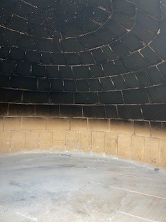

        Yesterday I did my sixth curing fire aiming to reach 600 degrees and I decided to leave the tarp over the dome of the oven. I'm not sure if that was a mistake or not. I know that some people suggest doing that to get a gauge on how much moisture there is remaining in the materials. After several hours I checked the tarp and found that it was noticeably wet and when I pulled the tarp off the dome there was steam rising from the pcrete. The inside of the dome is now noticeably blacker. The soldier course is still clear but from about midway up the first course of bricks it becomes a dark black. I had to cover the oven again last night because of a forecast of rain but I think the oven was sufficiently cooled down.

        Any input is welcome. Here is a picture of the blackened dome that I was talking about.
          #364
          The carbon does not burn off until the 700 plus range. However, if you are physically seeing steam off the pcrete you are heating too hot and too fast, Liquid water when it sublimates to vapor increases by 1500 plus times the volume which can cause pressure build-up and possibly crack the pcrete. Do you have the recommended vent in the pcrete?

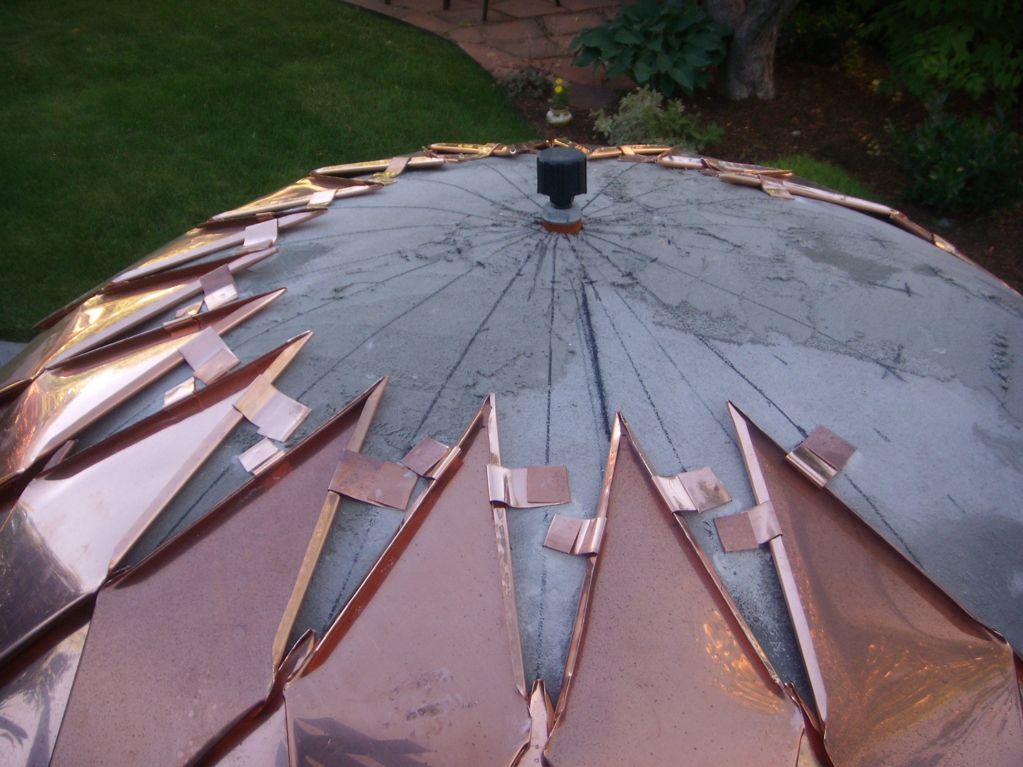

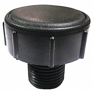

              The FB plans are a good baseline but dated, the use of the vent has evolved since the plans were published. You can do a search for vents and since you are at the pcrete stage and not stucco you can fairly easily install one. Here is a picture of the one Gulf and I used, available at any car part store for under 10 bucks, 1/2" mpt end that you can thread into a PVC bushing. But there are many other types Click image for larger version

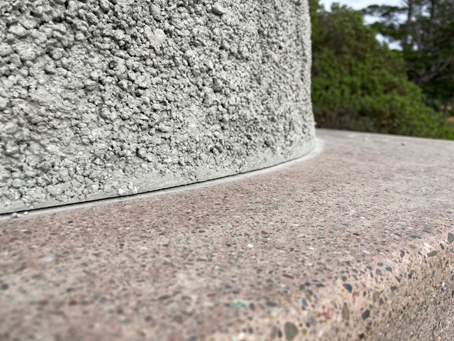

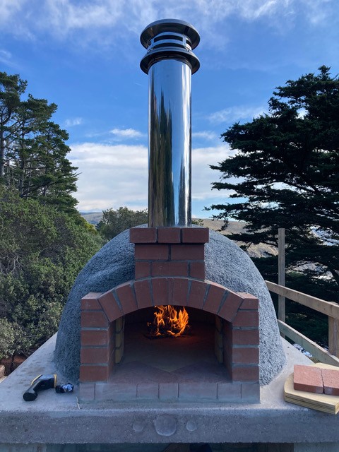

                  I found a zinc plated iron breather vent from McMaster Carr and installed it in the top of my dome. I returned to the process of curing my oven but I scaled down my curing fire to 400 degrees with lump charcoal. All seemed to be going fine. I waited three days after the 400 degree fire to do the next fire at 500 degrees and it too went just fine. Today I fired it to 600 degrees and I noticed a crack along the base of the pcrete and the cement slab. I'm concerned about this because I'm not intending to build a roof over my oven to keep it dry. My plan was to put an acrylic stucco over the pcrete to waterproof it. Any recommendations as to how to address this cracking so I can keep rainwater from going underneath the pcrete and possibly saturating the ceramic FB that is insulating the hearth?? The crack is only on one side of the oven so far.

                    As the perlcrete is an insulating layer it really doesn’t matter if it cracks a bit. The acrylic stucco over the top will do the weather proofing. Clean up the base of the perlcrete and supporting slab so you get a good bond there with your acrylic stucco. If you haven’t already, make some holes through the supporting slab so the under floor moisture, which is the hardest to get rid of, can find its way out.
