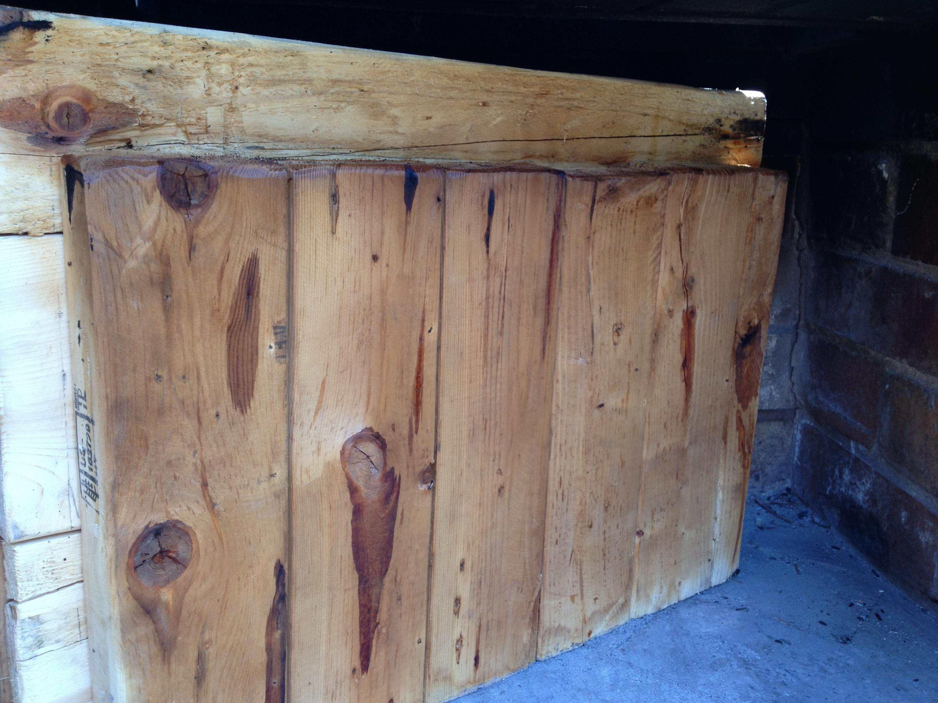

                Had this on my mind during the week so on friday I got a couple of pine electricial goods pallets of a friend. They had a standards no stamped and a quik check...not treated. So I had a play on sat morning took 2 hrs to carefully pull the pallets apart and an hour to build this
Name:	wood door 001.jpg
                Pretty neat ha? had a lot of fun... felt like a kid didn't use a square, measured bits off other bits, even reused the flat head nails from the pallets.
                Anyway at five oclock put the door in the laundry sink full of water and held it down with a brick.
                Flashed the oven up with the remains of the pallet Wow never used pine from the Northn Hemisphere before. Thats stuffs like fireworks spits and crackles and burns like it soaked in fuel!! I was now worried the door would survive it first trial by fire.

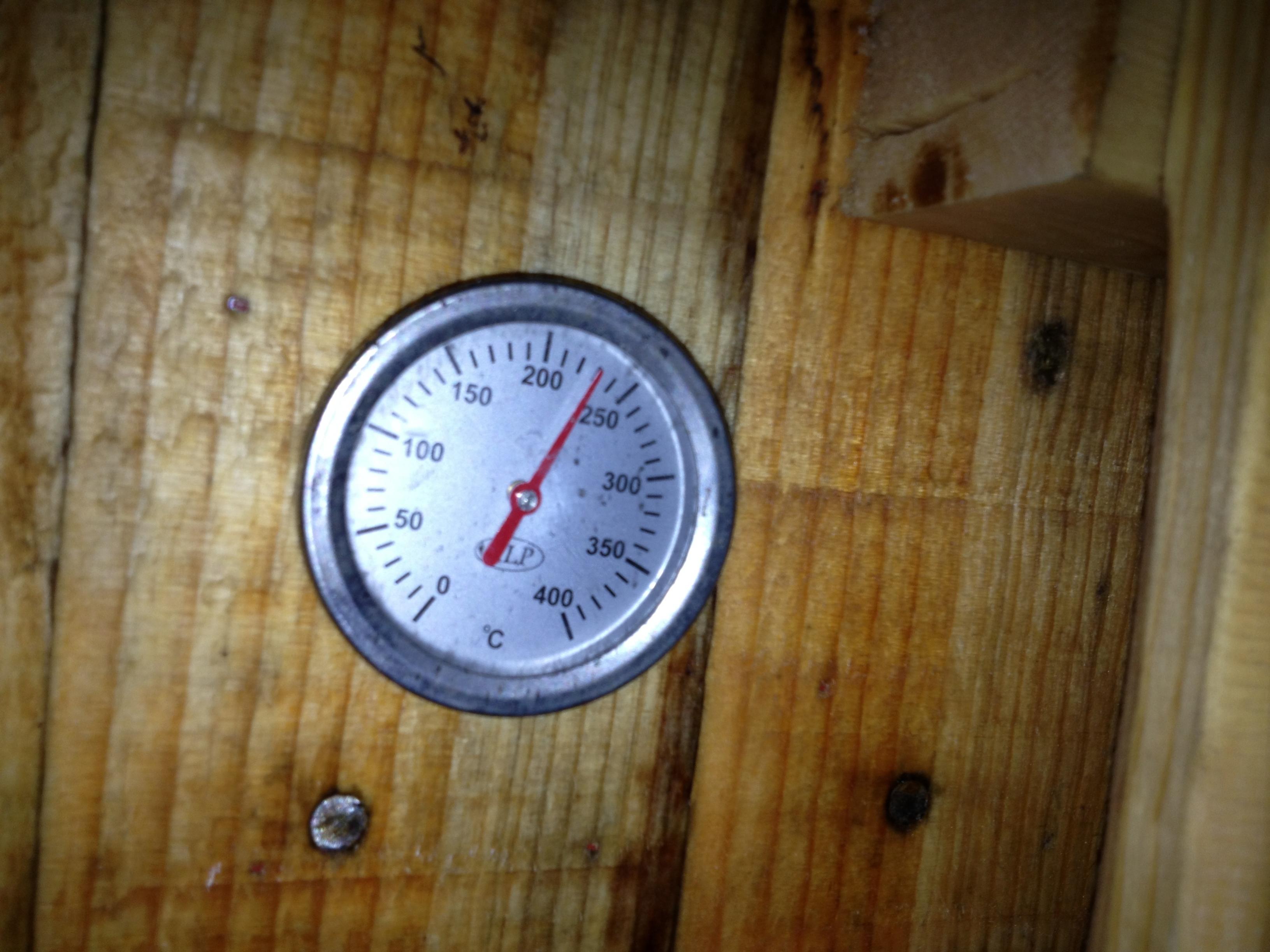

                After an hour the oven was up to exceptable heat for pizza. Probably 400C IR termometer has flat battery but you can usual tell without it. Cooked the evening meal whilst the embers burnt down and capped it of with the door about 7 oclock. checked it again at 9
Name:	wood door 002.jpg
                About 240c perhaps I was to cautious would have been happier if that was 300c plus

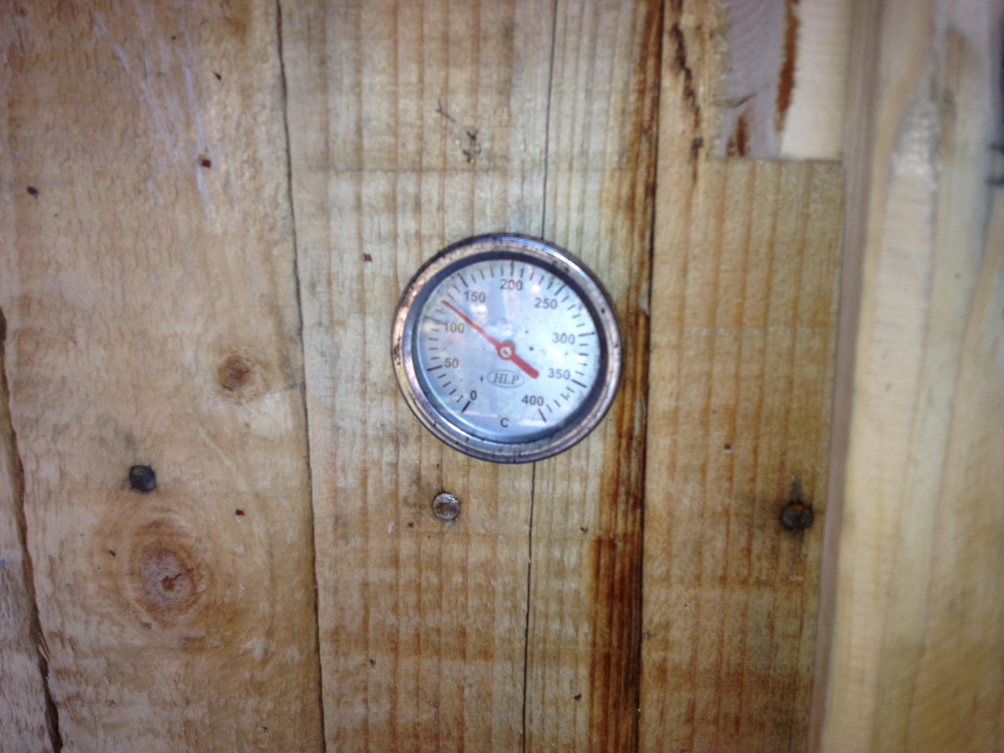

                Checked again next day at 9 AM
Name:	wood door 003.jpg
                Had dropped to 120c still a usable temp and this is some 14 hours later so the door did its job.

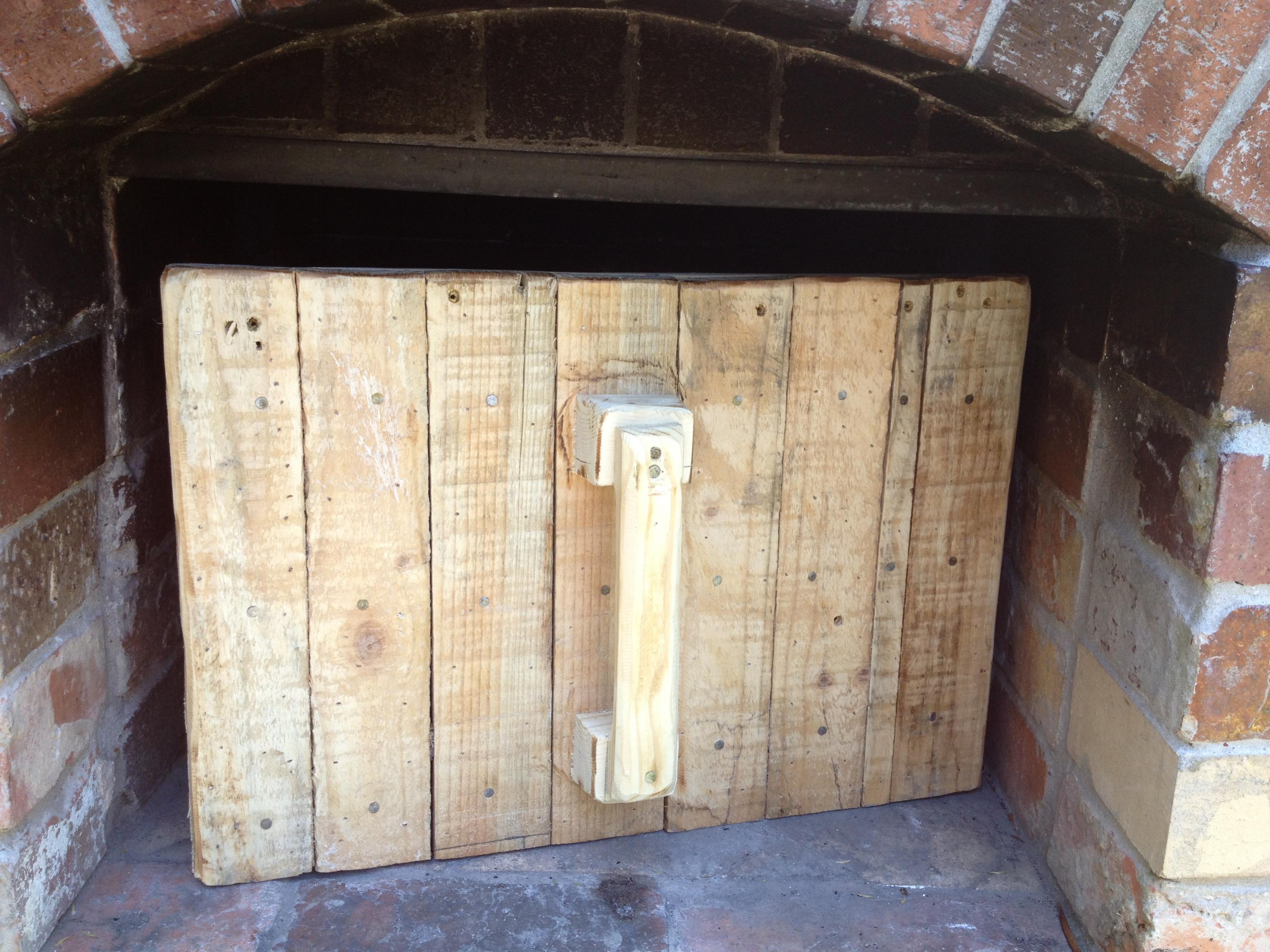

                Next remove the door... I'm just waiting for the door to flambe' in my face
                ( thanks for the stories guys)
Name:	wood door 004.jpg
                Not so bad the wood was definitly effected by the heat. The one amazing thing I found the oven was full of moisture and had the most wonderfull smell, recon it would be perfect for a bread bake. It was a fun experiment but it shows how the old timmers use wood doors especially for bread baking. I would definitly not pick pine if I was to do this again and I think you would have to replace the inner surface on a regular basis it would definitly fail after a time regardless of the wood.
