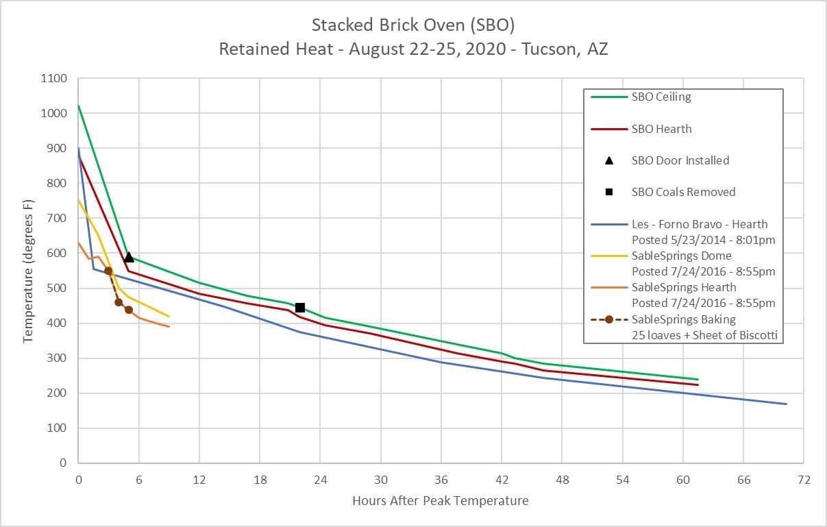

              I recorded oven temperature over time. I will put the data into excel and plot it up. My IR thermometer doesn’t keep a maximum temp from a scan so I might not have always captured the peak temperatures. I will upload the plot after I get it done.

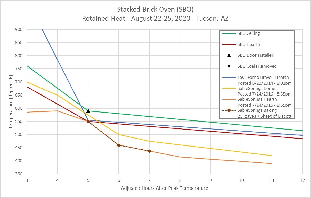

                Here is the temperature plot for my oven. Included temperatures that I pulled from your oven temperature plot and from a post I found from Les. From the comments in Les’ post, I assume that the temperatures that he reported are for a Pompeo oven per the FB plans.
                I didn’t track my heat up temperature so I just plotted versus time from the peak temperature. I made a second plot focusing on the first 12 hours. I also shifted all of the curves so that they line up better. It shows how much heat that cooking twenty five loaves of bread took out of your oven.

                  Nice temp plots Sean. The difference you are experiencing is the improved insulation (both above & below) over my oven. Nice to see some generic comparison values. I am really glad to see how consistent your ceiling/floor temps are...well done on your build! I suspect you'll even actually see some improvements in the temp holding times for a while yet. Now you get to start exploring a new world of cooking with your "new toy"

                    thanks. “New Toy” is definitely the right description. It is comforting to see that my heat retention compares well to other ovens. I was worried that my choice to use red clay bricks for the oven would result in worse performance.
