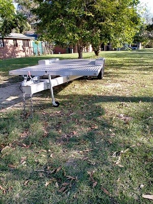

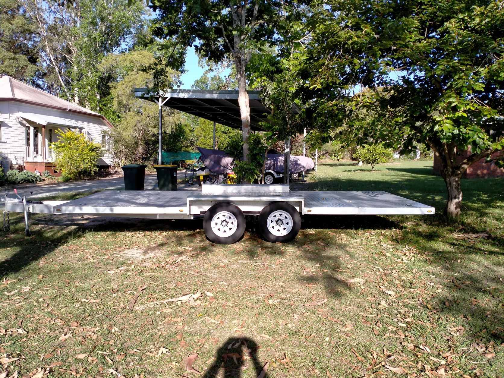

      hi david thanks thats good to know. I will post the build for sure. The trailer base is built already. its structural aluminum. 2.4 m or 8 foot wide
