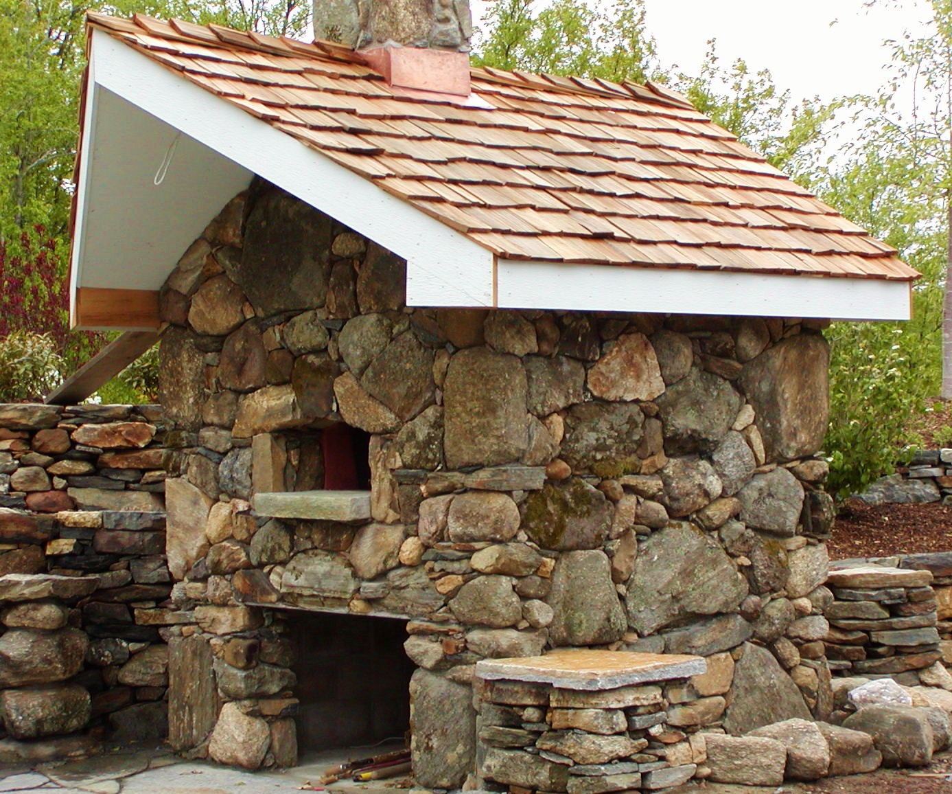

          I'm a bit confused too.
          I'm not sure what you mean by "linking" your chimney to the roof. Chimneys need to pass through the roof and maintain 2" min air space from the framework. Box out where the chimney will pass through and flash it prevent water penetration. If you want an over hang to shelter your cooking area, you could build a prow roof like this....

            Stonecutter - that pretty much exactly what I want to do. The only differences are I'm thinking slate tiles on the top, and bricks on the sides.
            Do you have any pictures of the underlying structure or frame of the roof before you tiled it? I.e. how is the roof held onto the walls? What stops a gust of wind blowing it off? How do you get "around" the chimney to make the prow? How does the flashing work? Did you embed it in the mortar? Does it go over or under the roof's tiles?

              Spinal,
              No offense intended here, but it sounds like you are in way over your head going this route. Have you considered just cladding the oven and building a simple roof over it? There is no way I can walk you through every question you asked...it would be a mile long thread. But here is a generic response, maybe it will help a little.
              The roof isn't tile, they are cedar hand split shakes, and the roof and walls are conventional framing...I have no pictures. Try Google for framing techniques.
              If your enclosure walls are masonry, then you need to anchor a wooden top plate for something to attach your rafters to. You can imbed anchor bolts or use tapcons ( masonry screws) if your bond beam is good and solid.
              You could make things easier if you off-set the chimney so it doesn't exit through the center of the roof. Flashing is still a necessity though....another Google subject. I could tell you how, but there is no point since the chimney isn't built. But to answer your questions...the flashing has to insert into the masonry on the chimney..yes. And it would go under your roof tiles or shingles. If you choose to counter flash it ( best practice ) that would lay on top of the roof material...don't nail it down.
              Hope that helps a little....remember - Google is your friend.
